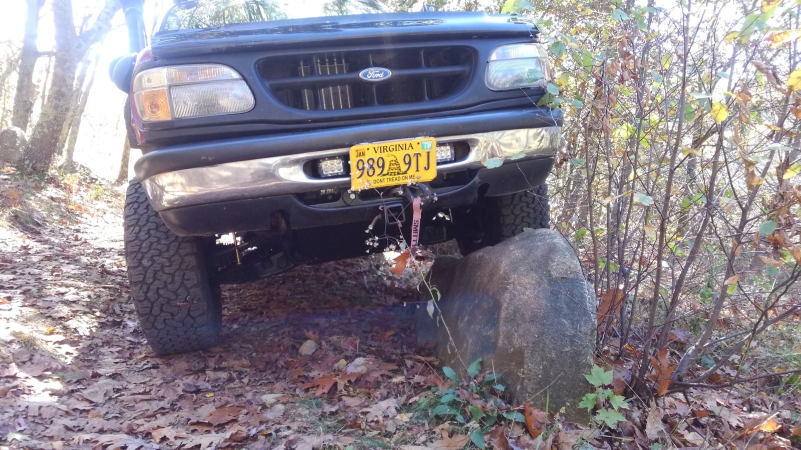

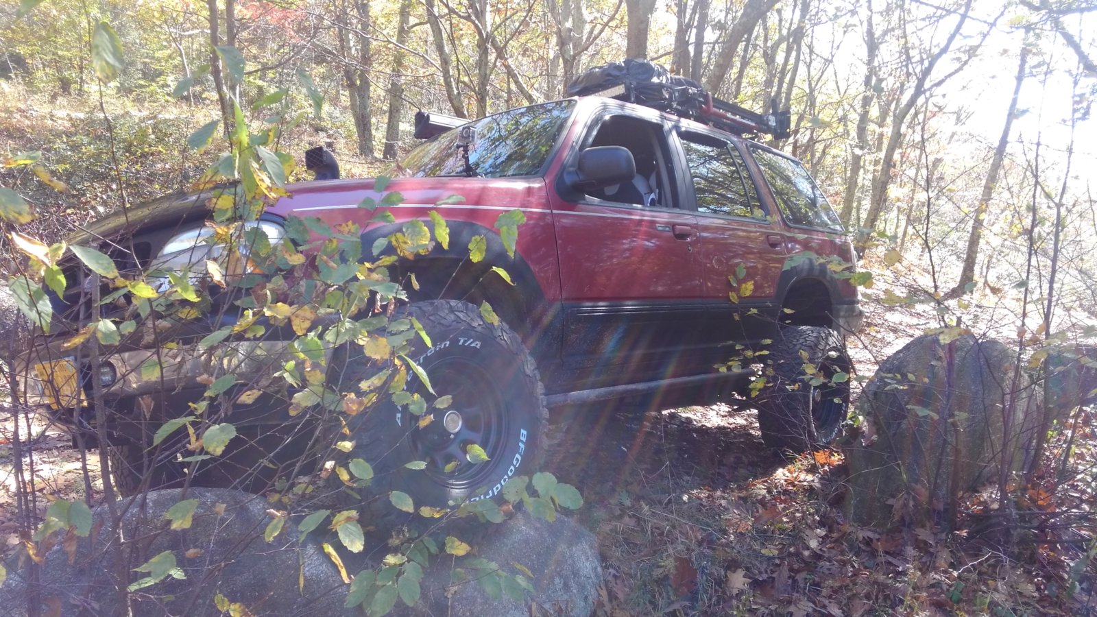

Hey I have a 2inch TT and warrior shackles in the rear with 32s and I don't rub at all.... on stock 1998 explorer fit v8 rims...
Please excuse the shrubbery would have been a good pic.
^^ this was about 4 years ago
3" body lift, cheap lift shackles,~1" TT
(didn't really measure from stock) 32x11.5x15 bfg ko2 on 15x8 with 3.75" backspacing.
