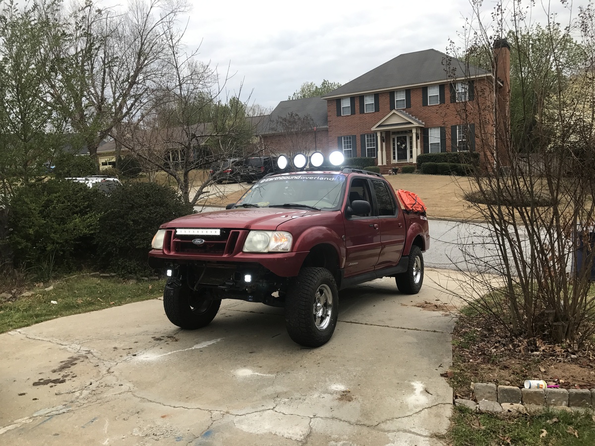

Here's almost where I left off. Bumper cut, hella horns, lights, etc. sitting on some 30" Falken AT3w's. Lift was a TT up front, LT leafs and lowering shackles in the back.

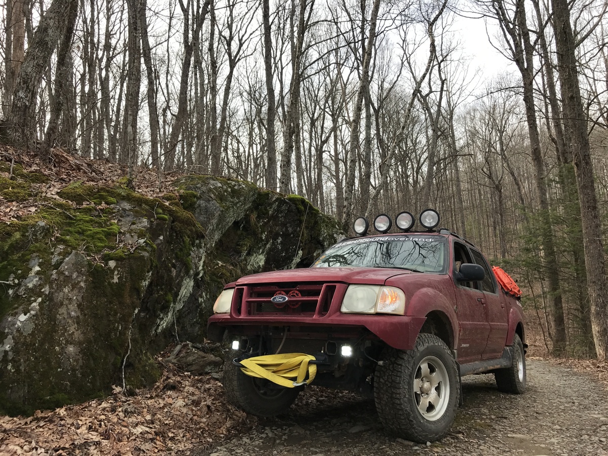

That was fun and all, but I had to remind myself why I do all this crap to my truck... To go off-road. So I undid the TT (man what a difference in comfort that made), put the 30's back on, and went wheeling.
Then I put a new LED light bar on the front and did some more exploration.

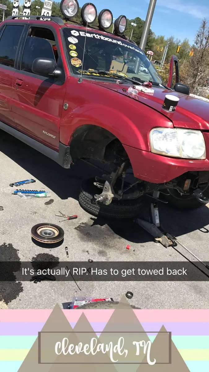

And then I went to Tennessee. Not an off-roading trip like usual, just a nice weekend camping trip. And this is when both wheel bearings blew up 6 hours from home.
The bearing explosion ruined the spindles, so one expensive tow truck back to GA it was.
Even got photos from an IG follower of it on the interstate.

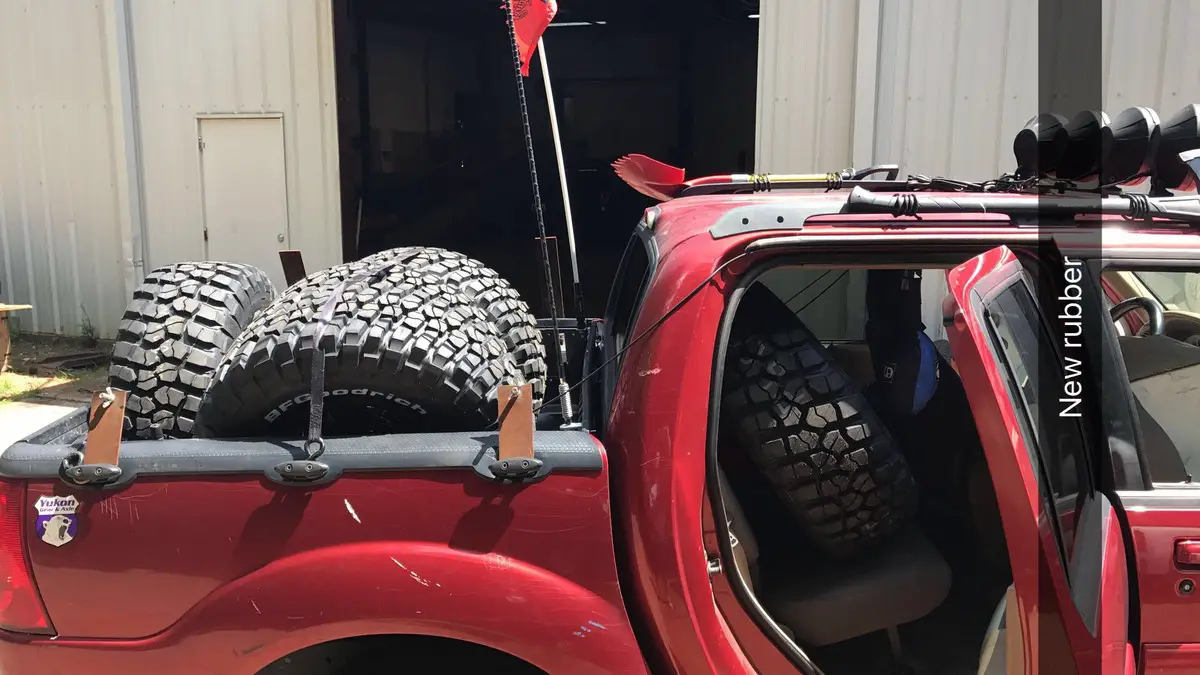

And then it was time for some new rubber. The 35's required a TT to fit, and the TT ruins ride, up, and down travel. So I decided 33"s were the best option as they fit with only the spindles and no trimming. Bought 33" BFG KM2's wrapped around some 15x8 pro comp steelies. Got a set of five.

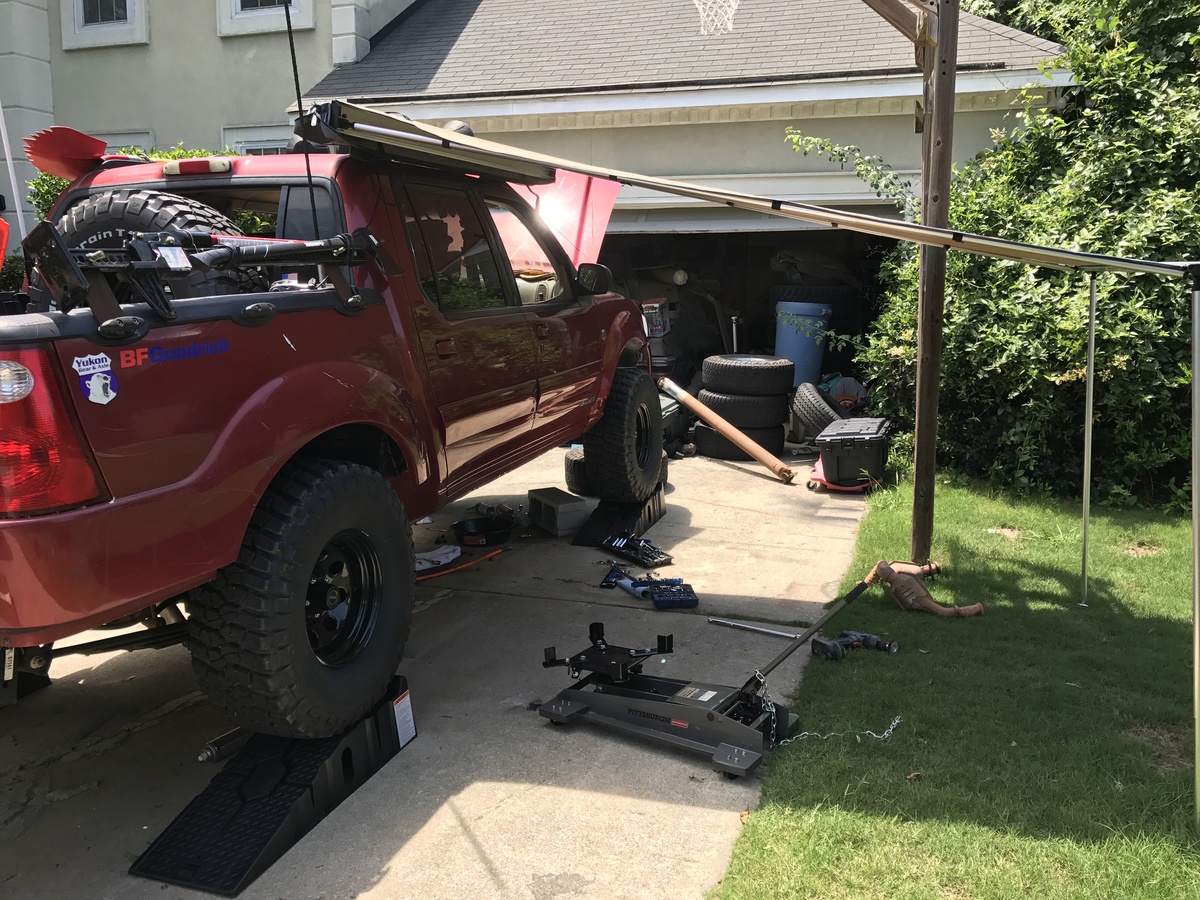

On the way back from getting the tires, I stopped by my favorite place in the world: Southeast Overland. Seriously, this place rocks. I bought an ARB Awning and tent attachment from them and headed home. Once I got home, I installed everything because I'm impatient.

And now today. Transmission finally went, and the replacement really sucks lol. Putting in a built 5r55e.
