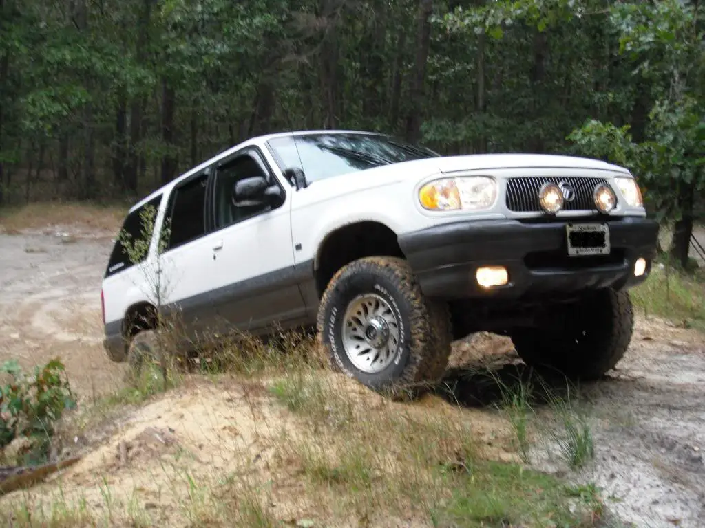

32s are great IMO. pretty good sized tire for offroad but still small enough to get decent mileage.

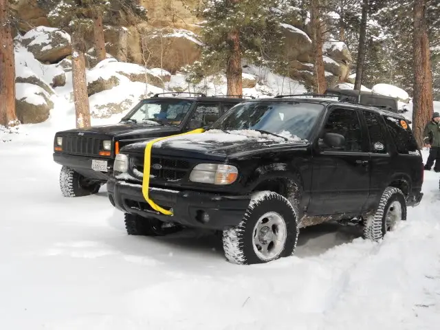

not an expo but you get the idea, 32in bfg a/ts

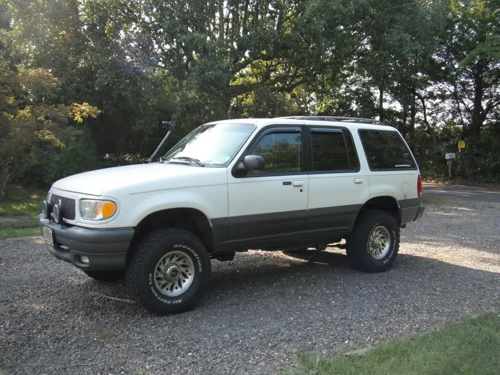

Just got the 32's a month ago, but love 'em so far.
Love the stance now.

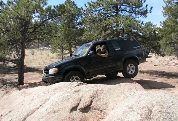

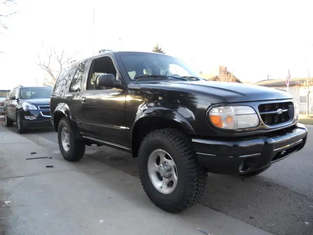

3rd Picture is most recent with BL
I made the jump from 235 and noticed a small difference in acceleration, city MPGs are down but highway stayed the same. I have 3.73s and had AWD with the tires.
