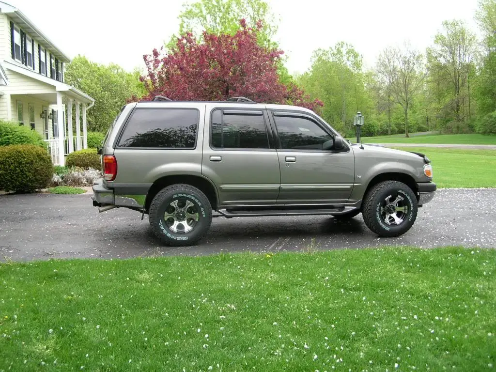

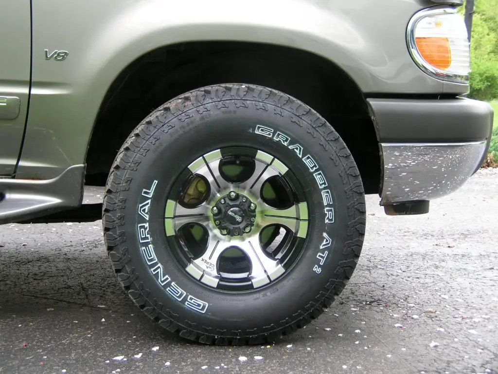

I went from stock 235/75/15's to 32's and my city mileage tanked. Highway not so much, maybe 1 mpg. City dropped from 16-17 to about 13. I'm in the process of hunting down some 4.10's for the rear, already got the fronts. Should see a marked improvement.
32 Kumho A/T

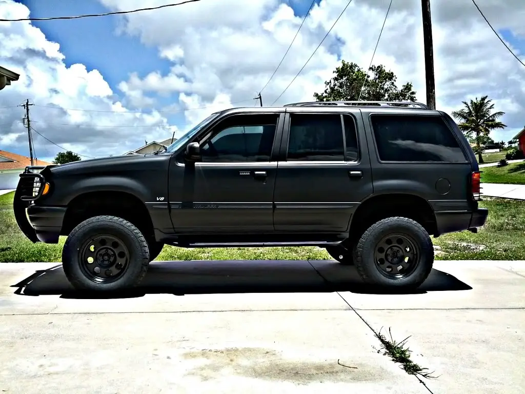

Falken Wild Peak A/T 265/70/17 (32"). Coming from 33s the MPG is much better but from stock it will be naturally worst.

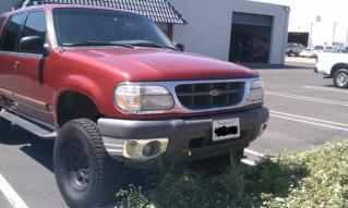

Just put on 31-10.50-15's and even with a 1 inch tt I had to trim the bumper sides but after the mud flaps were off they don't hit the side step trim.
I would think these are big enough for a stock 5.0 with 3:73's.
