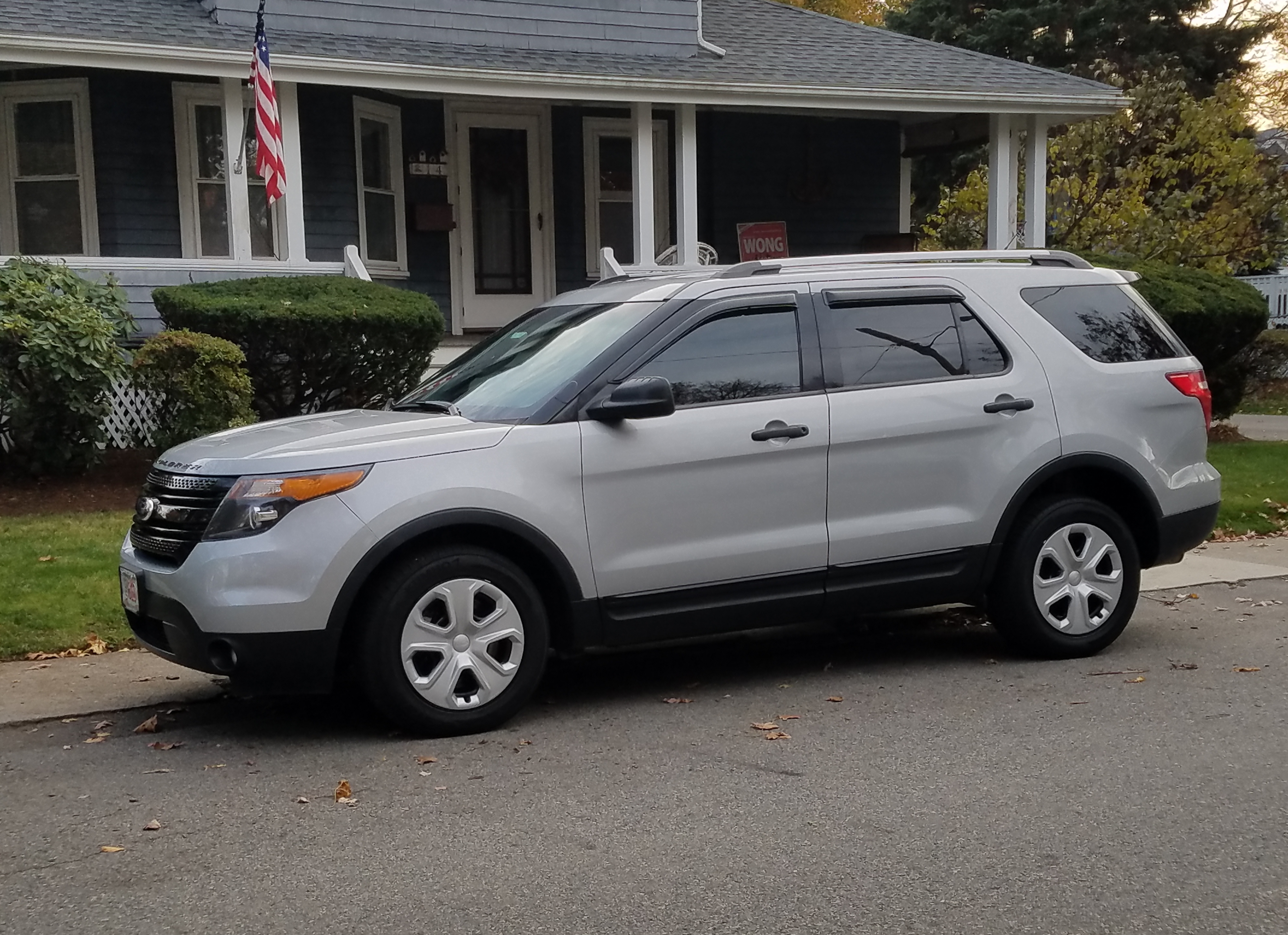

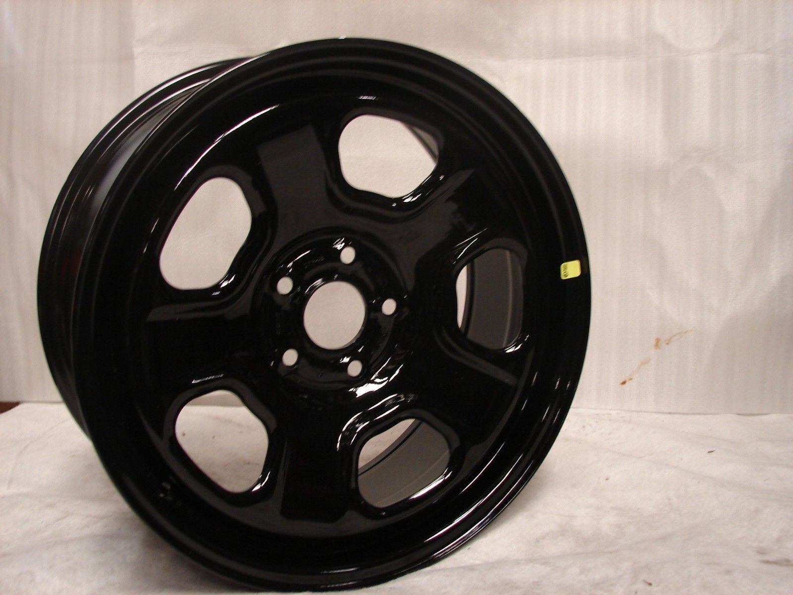

Hello! I am looking at ordering some XLT wheels as I like the look of them more than the ones that came on my PIU.
Now, they are both 18x8, so my tires should be able to fit fine. However, I am concerned about TPMS compatibility...
If I go from the black steel wheels to the aluminum, does anyone know if they will fit the same?

I can't confirm what type of TPMS is used on those wheels. On the Crown Vic's, it was a generic sensor that was held with a metal band that was fastened around the inside of the wheel itself.
I'd either check some online Ford parts diagrams or check on eBay. All kinds of late model Explorer wheels for sale on there that might give you an insight into the TPMS situation.
