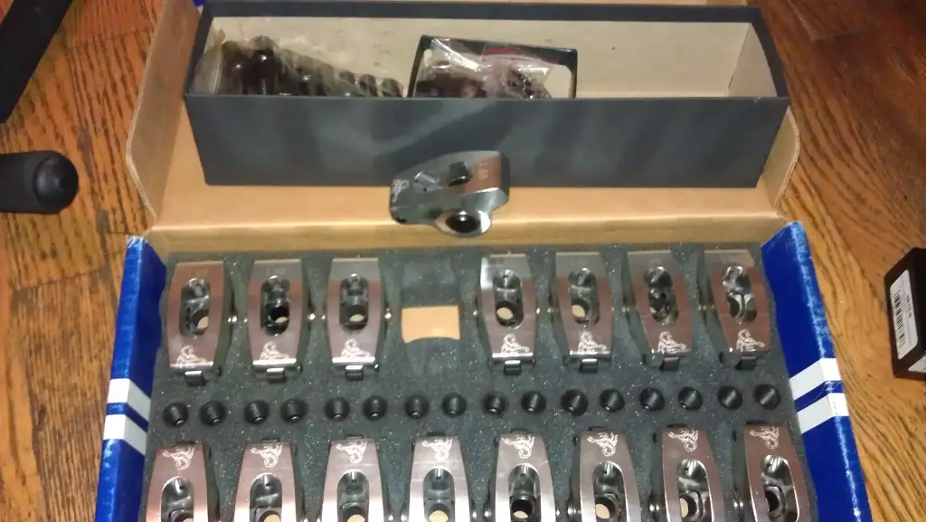

My scorpion 1.65 Rockers, Comp guide plates, and 7/16'' studs came in yesterday. Now all I have to do is wait til payday and try to see if my machinist is done with my heads. After that I can mock the motor up (I have all the gaskets here) and test it. Praying for clearance. Even though this cam has higher lift than any of the off the shelf cams I was almost gonna go with the duration doesn't look Super high. I trust Ed had this in mind when grinding it out for my truck. If I have clearance then the motor can go back in next week after I replace the mounts which I'm not looking forward to. Get a hold of James to revise the tunes and maybe look to firing her up finally sometime the first monday or Tuesday in June. :) It's been a long while since I've driven her and I'm suffering from separation anxiety haha.

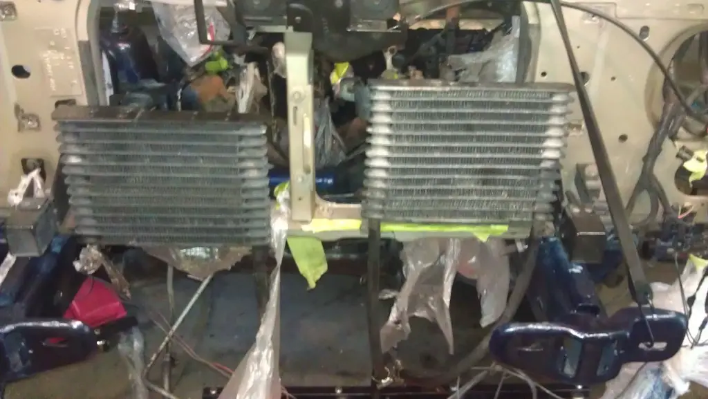

Okay guys, I need some suggestions. I got a 2nd transmission cooler I want to hook up here for extra cooling. Where's a good place to mount it at? I know I'm probably gonna have to do some drilling to get it to work but I wanna know what some others on here have done. Here's a pic btw, the 2nd one isn't mounted I just have it sitting there for reference.

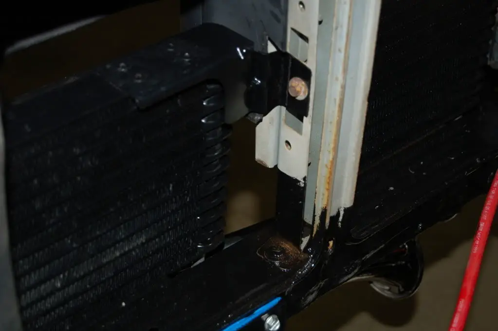

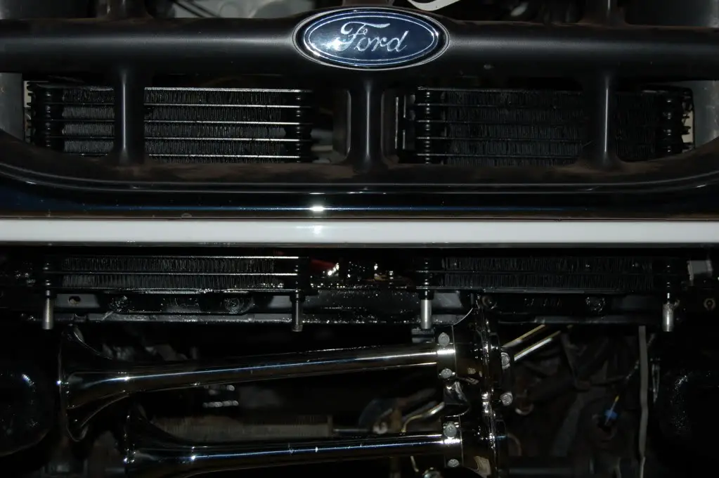

Here are the pictures of my custom tranny coolers installed.

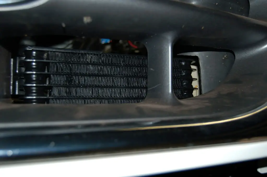

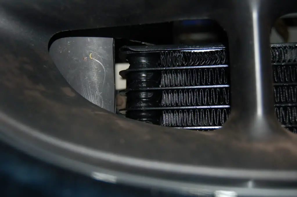

Since my truck didn't come with any extra coolers at all, like the V8 models all did, I had to cut out the plastic grill insert to make the one in the stock location fit. With that said it should come as to no surprise that I had to do the same thing for the extra one I added on the driver's side.
I see. It looks like you flipped them upside down? The line openings are on top instead of below. Is that so the coolers aren't blocking airflow from the radiator? This might be something I may have to do later on down the road then. Because right now, my main focus is to get the motor back in and starter. If having a 2nd cooler will inhibit the function of the radiator then I will just have to deal with having one for now until I can come up with a another method to mount it. Hmm....
