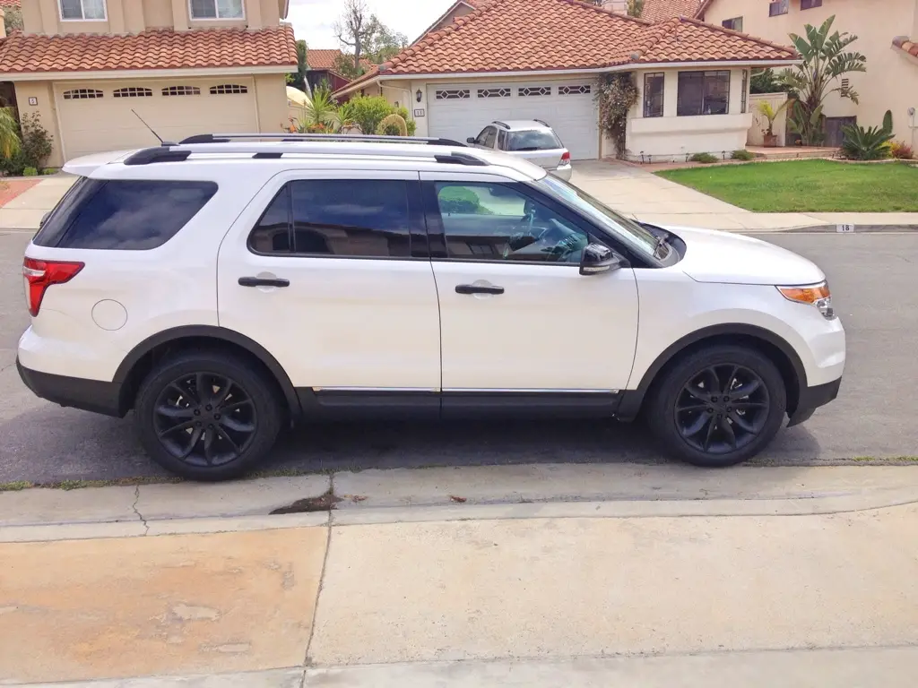

Welcome to the forum! If you do a search there are plenty of threads about plasti dipped wheels, mine included. You can do either/or methods, depending on your preference. I personally thought it was easier to take them off, which is why I chose that method. I wanted to leave the lugnuts unpainted just in case i had to take the wheel off in the future. Most people just masked off the brakes/calipers and then plastidipped the wheel on the car. When i put the wheel back on, I scraped away some of the plastidip around the flat surface inside the hole where the lug nut set against. I'm not talking about around the edges of the hole itself. I'm talking about the flat surface(if u look inside the hole, the circular part facing you). Otherwise, if you don't do that, u run the risk of the plastidip pealing all around inside the hole when you get the lugnut fully on. If you do decided to take the wheel off, I found it helpful to place notecards around the wheel in between the tire and wheel to control overspray so I wouldn't have the hassle of pealing the excess off when it dried. Here's a link of the finished product: http://www.explorerforum.com/forums/showthread.php?t=379171
Did this a couple week ago & thought I'd share ;)

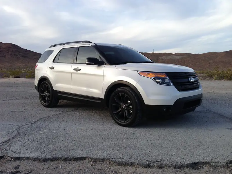

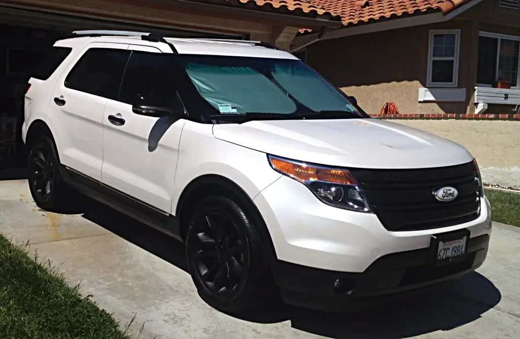

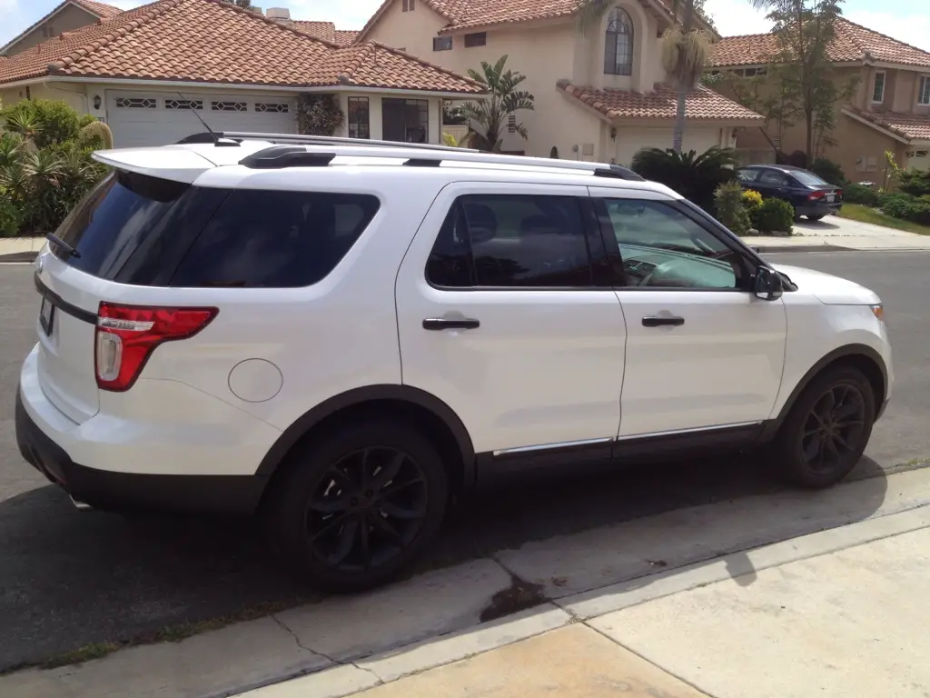

please show more pictures from different angles. Thank you
Here are some other angles. It really looks even better in person.
sweet. i think black rims look best on white car.
