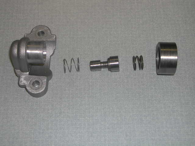

You have to remove your extension housing to get to the governor. It is a small part that is held in place with 2 bolts. Here is some more information: Governor weight 56615-35 35 mm ($4.46). That is a Sonnax part #.
Here is an exploded view of a governor (courtesy of Glacier):
Hey thanks for the help and the great picture!
