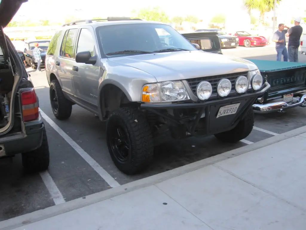

MXrider...your truck looks really good. Sorry if I wasn't specific enough. I want to clear 33x12.50's on a 8.5" wide wheel. The height is not what concerns me as much as the width. I hope to be able to do this without needing to run fiberglass fenders.
Click for way bigger picture.
Also curious to know what 17" wheels you are running... the ones in the pic seem to be the exact same as mine which are 16" but I may be mistaken. Any more pics of your truck and wheels?
Sorry, 16's! My jeep has 17's, get them confused. That extra 2 inches on width is gunna be hard. The 10's are tight. who sells fiberglass for these?
McNeil Racing Inc./Perry's Fab and Fiber makes glass for these trucks. I called them because they don't have any pics of their fenders but I did some trolling around on the internet and found a pair of their fenders. I almost love them minus the z3 fender vents which are gross imo. Here's a pic:
The truck in the pics is not my cup of tea (stock suspension and very nice wheel and tire game) but mine is pretty much stock so touche. LOL
