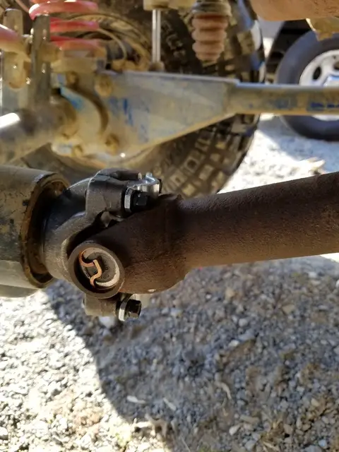

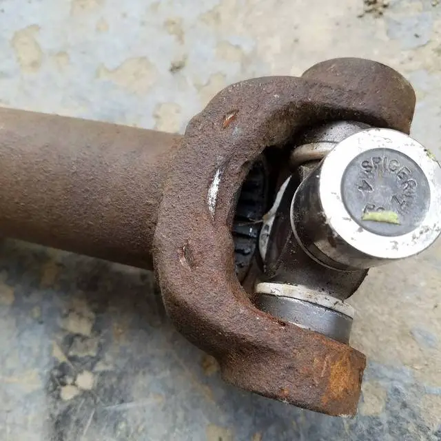

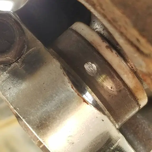

I finally got the Atlas installed, I am running a 1310/1350 flange on the front output. I had a 1350 DC front shaft from a super duty cut down to use in the front. After having to modify the A4LD shift cable bracket to clear the shaft I got it bolted up. And thats where we have a problem. Front shaft yoke is rubbing cap straps and the cap. DS angle also appears to be steeper than with the OE case and shaft. Front diff yoke to tcase output flange has a 5* difference. I know my front pinion angle isnt the greatest, but I did not have this issue until swapping in the larger driveshaft. Grind and go or change shafts? Just looking for opinions/suggestions before I look into getting a different shaft made.
