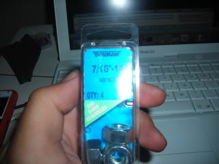

i tried the bushings, but they were too big, and i know i have to sand them down, or whatever, but i didnt have access to anything like that :) so what i used in place of the bushings were three (3) 7/16 hex nuts. fit in there perfect, and the window is working perfect. cost me nothing because i had them in my tool box :D
are these the ones you used?
ATTACH]
another question, i have a 1992 eddie bauer,i have taken everything off the door like i am supposed to,i have taken out the two visable bolts,but when looking for the "dimple" i found like three,does any one have the same year and model and could show me witch dimple to drill?i dont want to just drill random holes in my frame....

...I wouldn't use the 7/16 nuts...Within the last few months someone else did this and as commonly occurs, had to buy new motors shortly after...;)
ATTACH]
I did my drivers side last sat. It was not bad at all, took me 30 mins from start to finish! The plugs from the parts store are only around $8. They will fit! you just have to make sure they are completly in the rounded corners, line up the cover, and push straight down! It would help to tip one edge of the bushing away from cover as you push down. Also you can cut them with a utility razor knife, the are pliable. Those 7/16 nuts look real big compared to the plugs! :)
