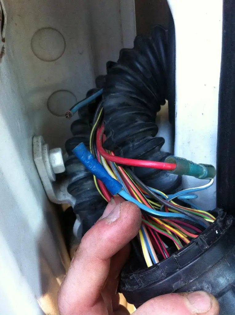

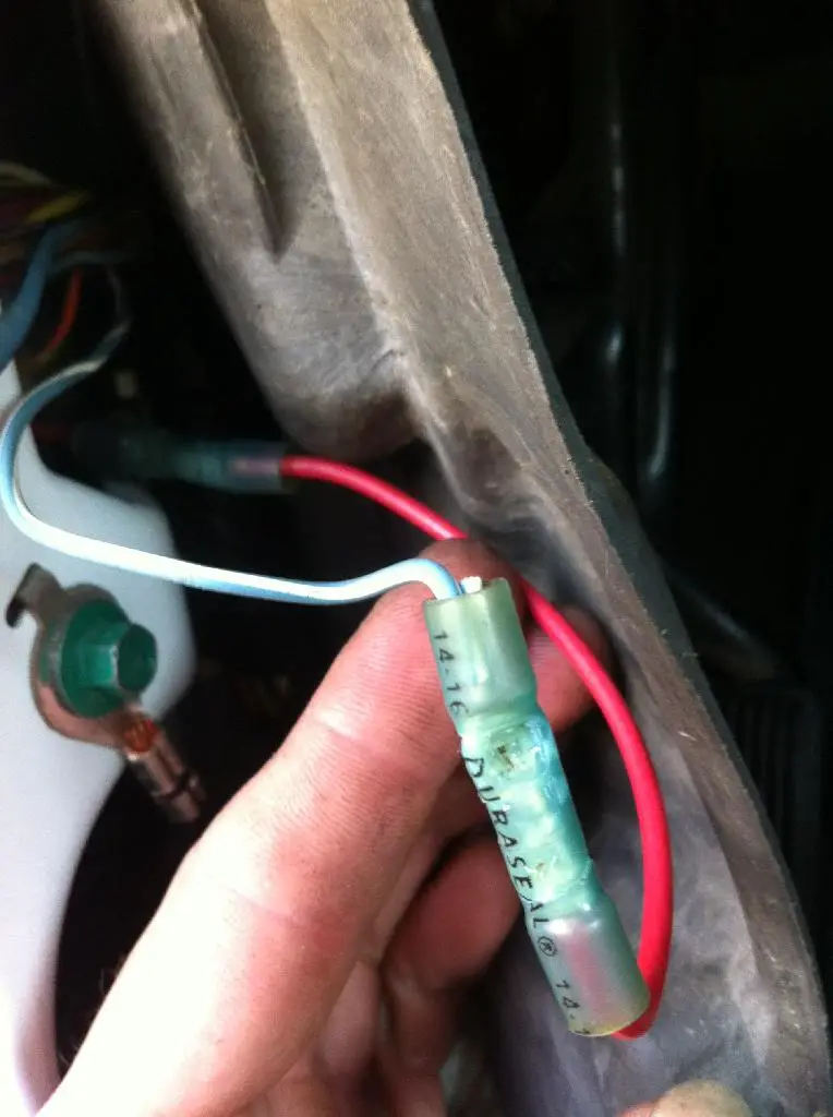

Here's a few pictures of the damaged wires.
I have had this problem before, had ford fix it (before I knew of this site) and now have the same problem. My drivers window control switch won't work, the lights for the same switches won't work, the speaker goes in and out and the driver side mirror can only control left and down motion (won't go up or right). I opened the boot and found ford fixed it with crimp connectors which corroded and there was another with 3 crimps for 1 wire with about 2 foot extra wire tucked away. I'm just learning to solder so I solder in slack wire for the blue/black wire (corroded crimp), I also took out the 2 foot extra wire for the blue/white wire and solder that. I put back together and noticed a cut in the orange/green wire (or is it pink/green?). I didn't have time for that and half way put together (bolted harness on with boot lose. Ford must of cut the boot and zip it back but I didn't have zips) but everything worked fine, until the next afternoon. The windows wouldn't work again. I went back in and didn't notice anything else wrong (unless it's my solder joints).
My questions are what (or where I can find) the identity of the blue/black wire, blue/white wire and orange/green wire? I seen a blue/black in 1of 3 harness for the drivers door control switches, is this the wire for window control? If so either my solder is bad or I don't know, there was little play in connection to harness. I was able to wiggle the boot and was able to roll window up to just vent it.
The pics above show the 2 wires before I tried to fix/solder. The next 1 is after putting together, I noticed another wire (I thought the heat shrink tube meant flame shrink. I know better now but could that be my problem, I used a lighter to flame shrink the tube, could I of melted my solder joint and break the connection?)
