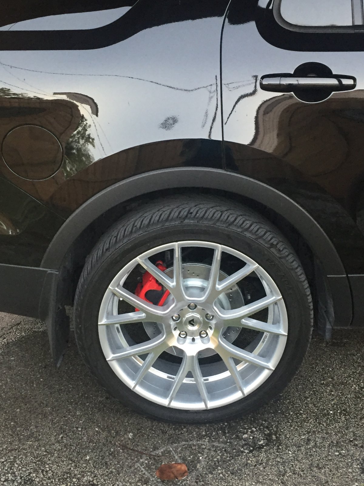

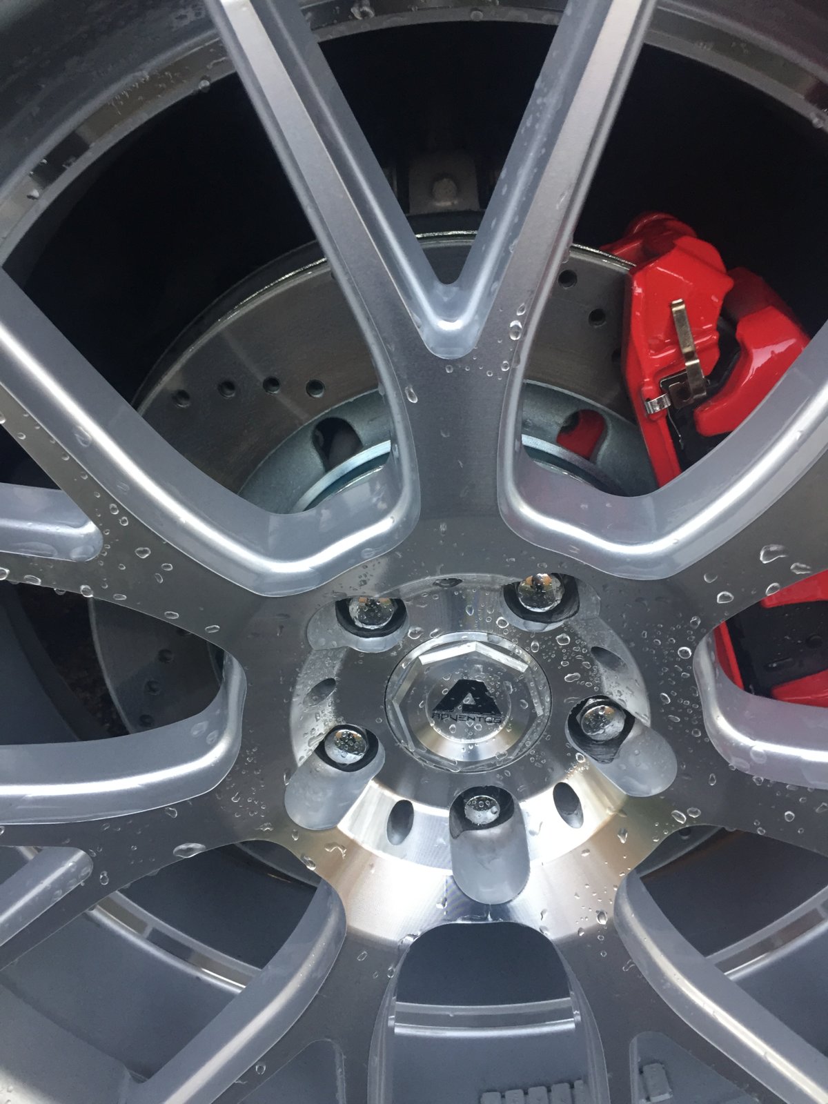

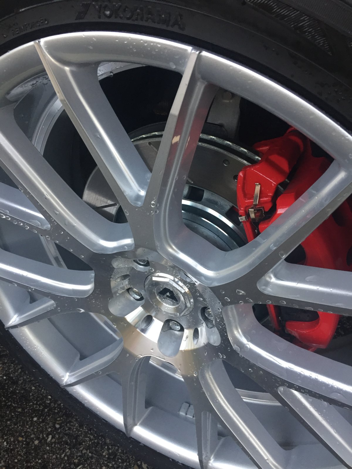

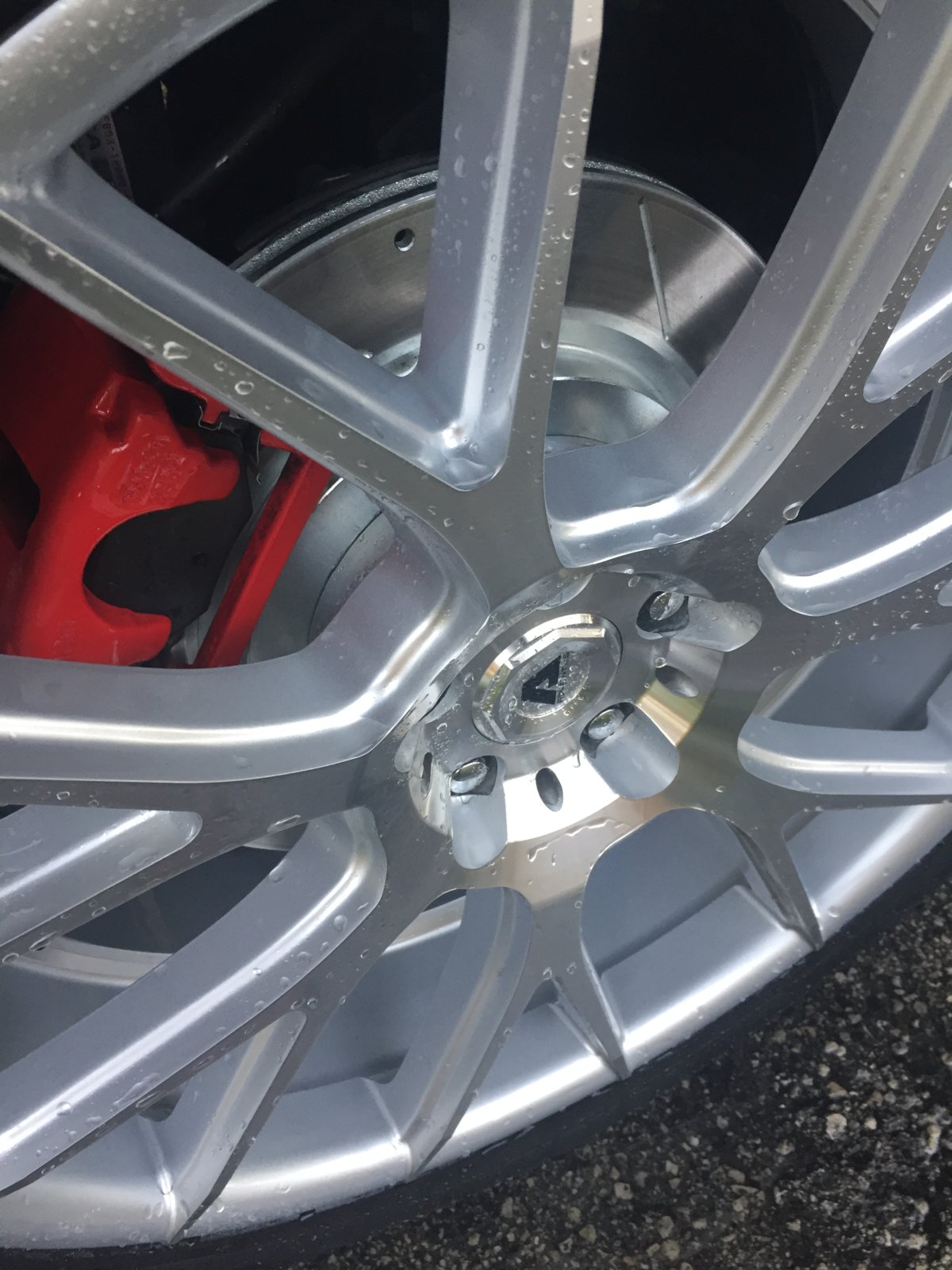

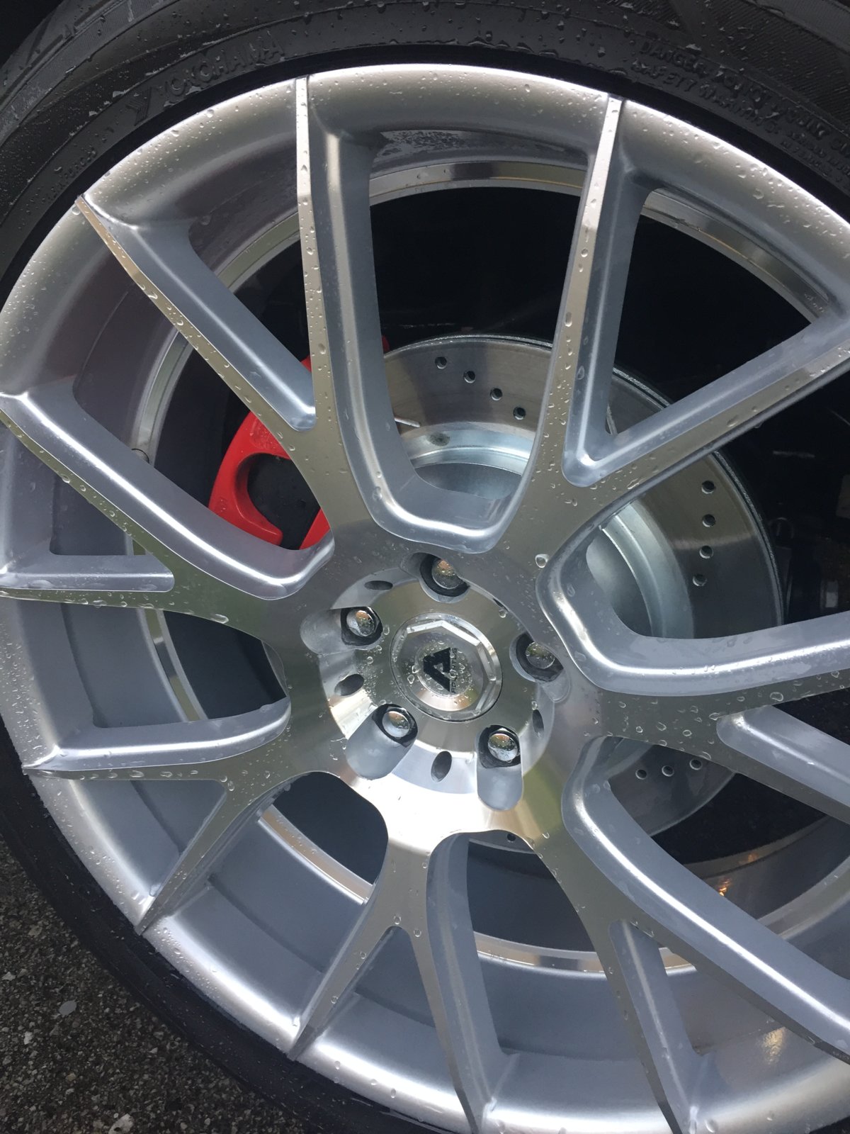

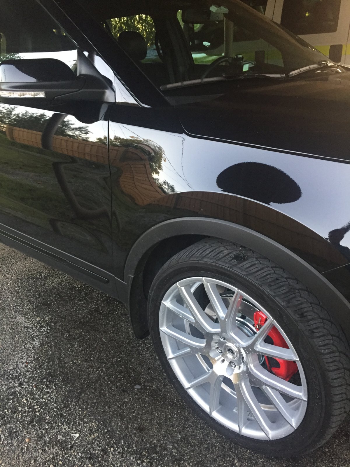

Hey Forum folks- I wanted to post pics of the Powerstop Brake Kit I had installed over the weekend. Although you can likely buy as a kit now, I purchased the items separately as they came available. After waiting for MONTHS and much hounding, Powerstop finally released to their retailers the red powder coated calipers for the xSport that I've been after. Rockauto.com were the first to carry them (keep your old calipers as cores if you order through them). I ordered the pads and rotors through Amazon.com. Because my wheels are a PITA to keep clean I went with their low dust pads, but they have many higher performance options to choose from. For me, the best part of the kit were the drilled/ slotted rotors and red powdercoated calipers. This kit was largely an aesthetic thing for me as my wheels show lots of the brake system. The braking on my 16 xSport was never poor to begin with- is there a huge difference if braking performance now? Not yet- I think the pads & rotors are still seating in and there are higher performance pads to be had, so no- but it is certainly equal to if not slightly better than stock. The rotors are anodized silver, which went perfect with my aluminum wheels as well. My wheels are 22x9's so there is a larger gap between the rotors/calipers and the inner diameter of the wheels than you can expect if you are running the factory 18's or 20's. This is NOT a "big brake kit", this is simply an upgraded factory replacement if you will. All of the dimensions are the same as factory. Cost wise, it is much more affordable than a true big brake kit. As far as Powerstop quality/ performance/ longevity, all I can say is that I had a Powerstop kit installed on my 07 Toyota FJ Cruiser for years and loved it (huge upgrade in braking). The Powerstop website will help you answer any questions you might have and their email customer support is very responsive. Hope you find this thread helpful.
