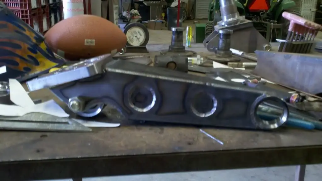

Heres the start of my new spindle uprights using the dana 35 snout block
WTF?!?! thats insane! Good work man!
any updates on your truck dan?
Spindles are done, lower fixtures are done and the lowers are tacked together. Now we have to cut the top of the frame off with all the factory UCA mounts are and make new mounts lower and further in than factory. Overall extended width over stock arms will be 5.25 " per side so 10.5" total. Expecting 20 inches of wheel travel bumped and strapped off. I also got a new tranny rated for peak 600 hp and a 331 stroker kit. Shopping for new heads and a cam builder. My wallet aint empty yet , but I cant imagine it being full by the end of this! haha
