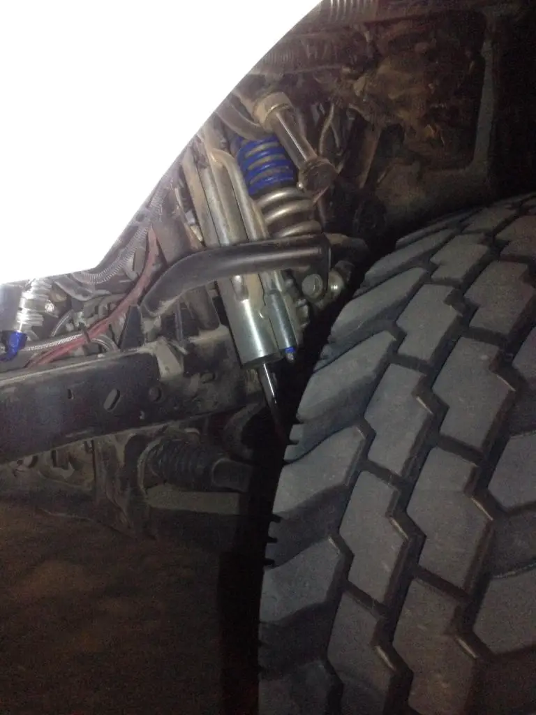

Modified LCA to accept a 1" uniball as the outer pivot then boxed in accordingly. Custom UCA with 7/8" heim as outter pivot and 3/4" heim on frame pivots. Fabtech lift spindle tapped out for the heim and drilled knuckle for a 7/8" on the outter tie rod as well. Fox twin tube bypass shocks as well as a 2.0 body air shock per side assist the stock torsions with spring rate. Fox hydraulic bump stop off of the UCA

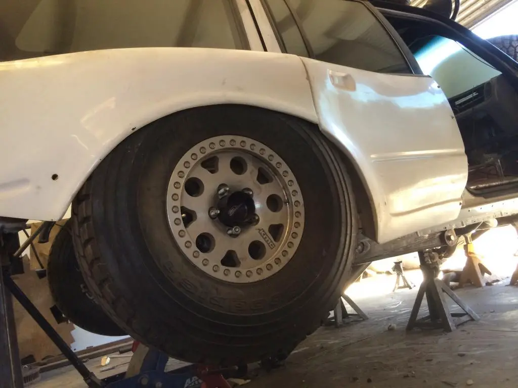

62" race leaf springs by Deaver with custom 12" long shackles. 18x2.5 triple bypasses by Fox though the wheel wells.
Other:
Baker 8" front fenders with FIberwerx 8 " fiber glass rear panels. Front and rear bumpers with a 2" rollcage threaded throughout still in the making. Fullsize axle out back with 4.56 gears and a L/S. 35x12.50 BFG Baja TAs and some Pro comp rims to hit the ground running.

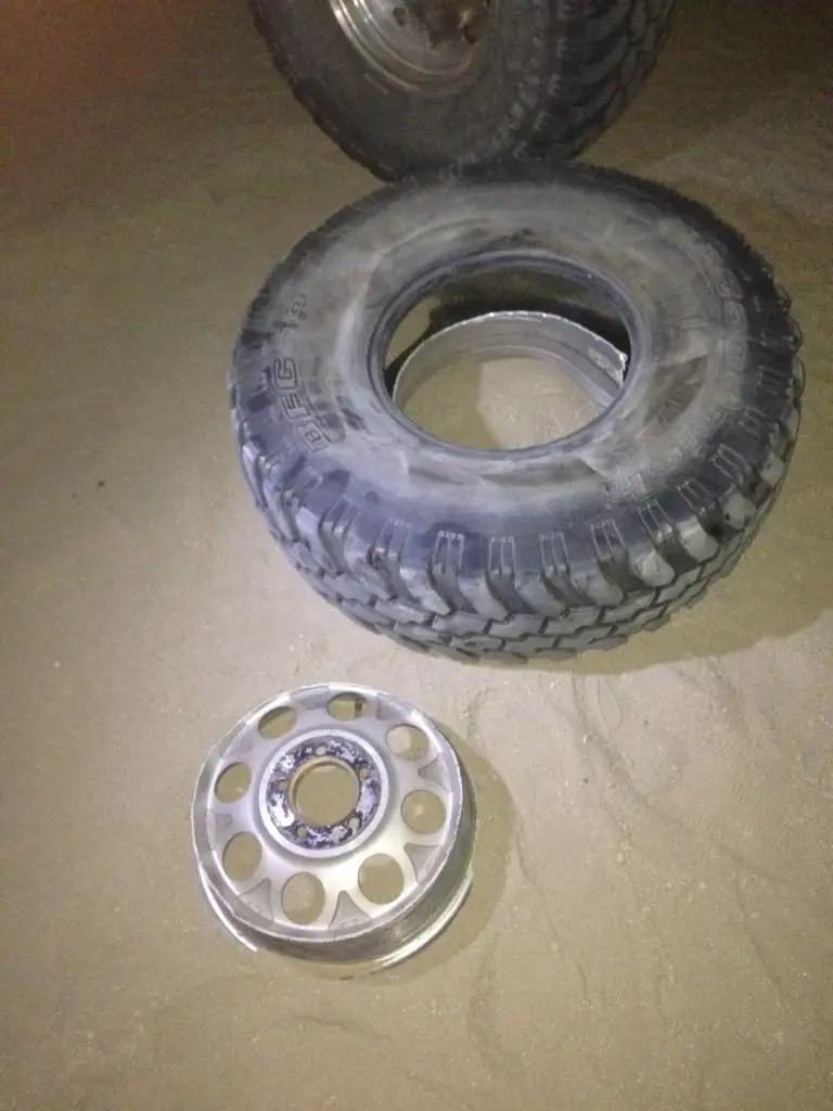

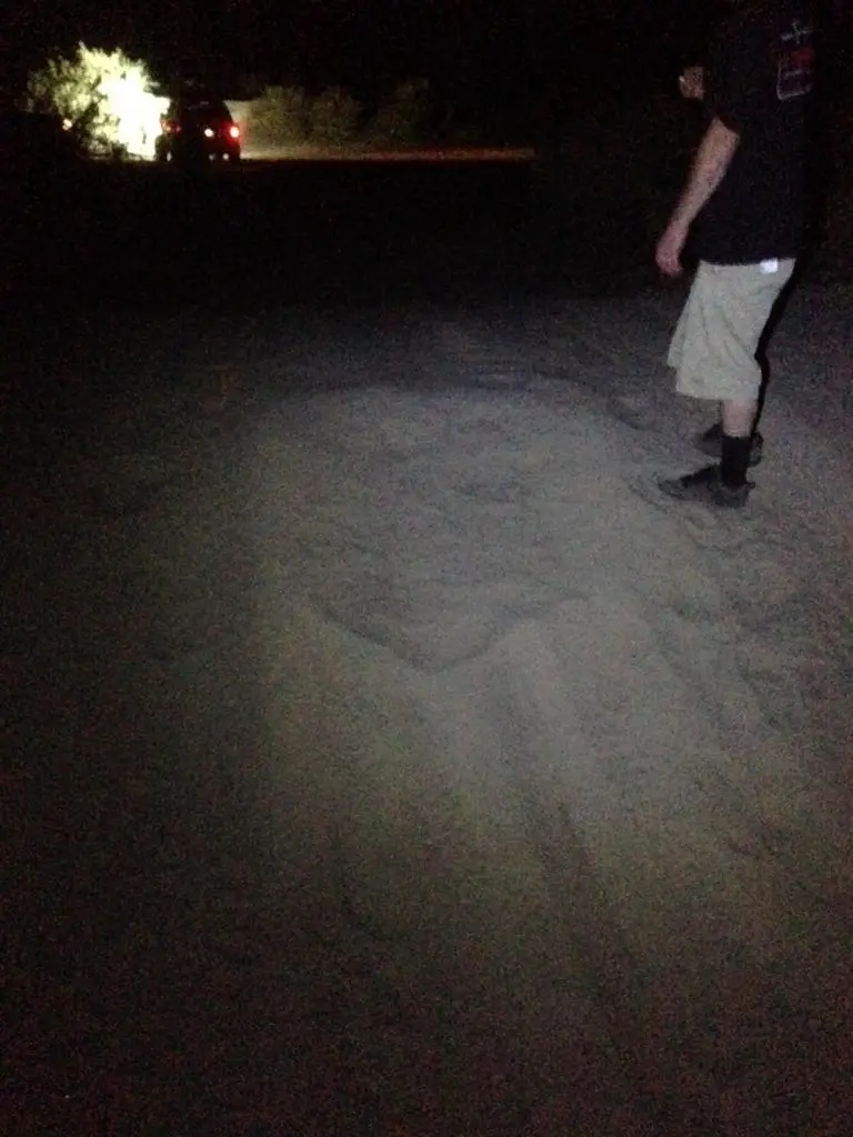

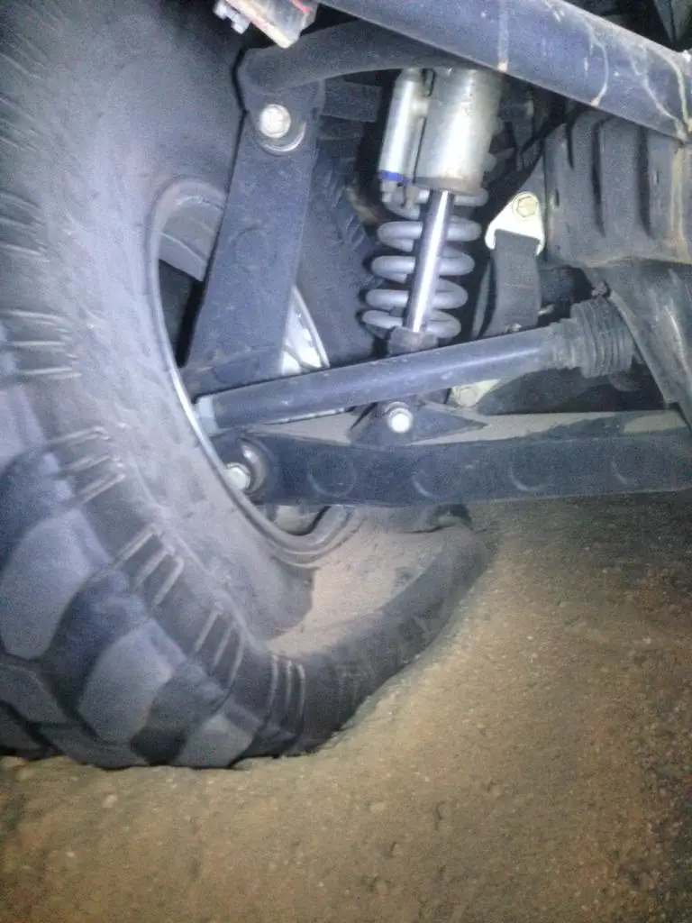

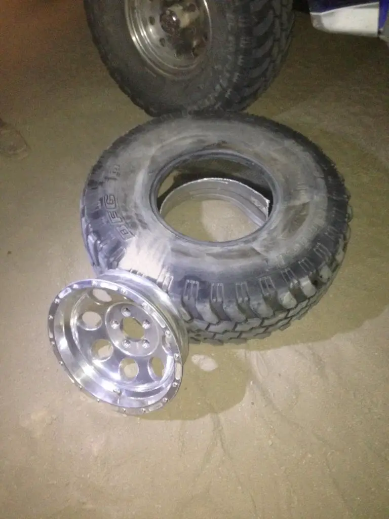

Well I hurt my Explorer this weekend in Ocotillo on a night run. Came out of thick dust and smashed a huge double going too fast and sky'd the thing well over 10 feet in the air. We paced out the distance at 75+ feet. Broke a wheel in half bent the other and bent both upper arms. Everything else handled the hit.
The size of the obstacle was impossible to capture on a pic but it was about 5 feet tall really peaky and the other side was a good 6-8 foot drop into a cross wash. It was a nasty deal
Man that sucks. As long as everyone is alright that's all that counts, it could always be alot worse. "Build it, Break it, Build it stronger !!!"
Damn!!!! Just be glad everyone is okay... and the broken stuff could have been ALOT worse! :eek:

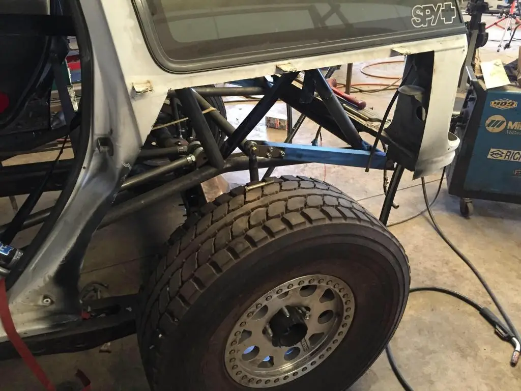

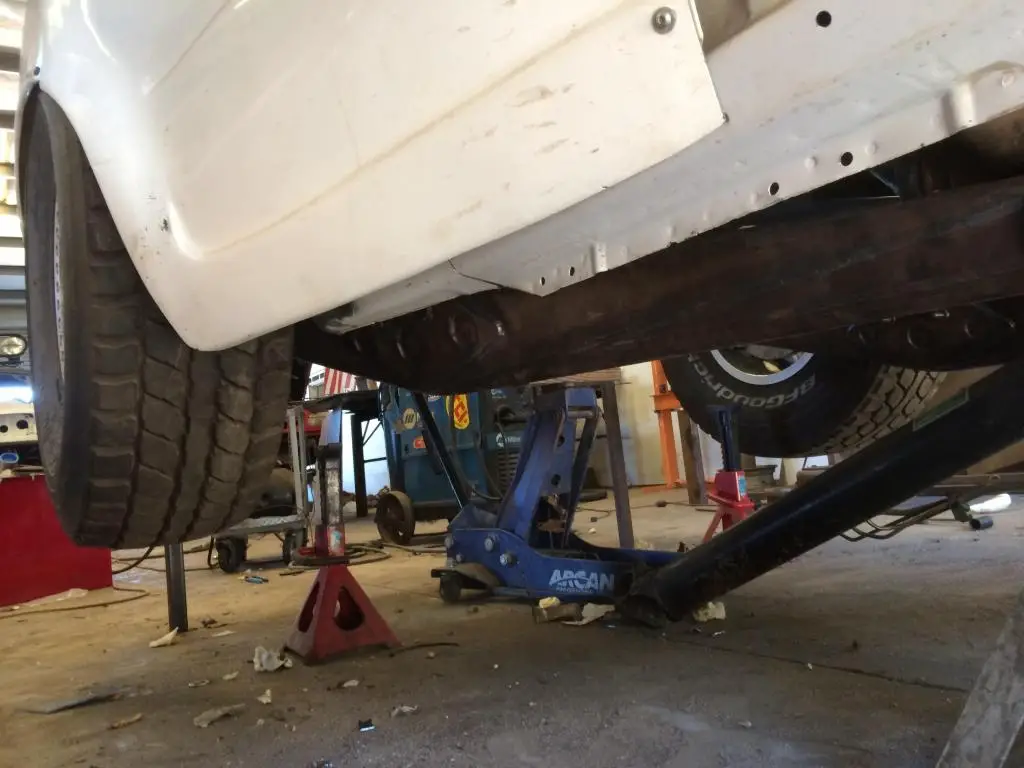

Yeah, frame is cut off behind the front doors and building tube chassis for the 4 link. I'll get some pics up as it starts to look like something again

Here's some teaser pics of my 4-link in progress. Slowly but getting there
