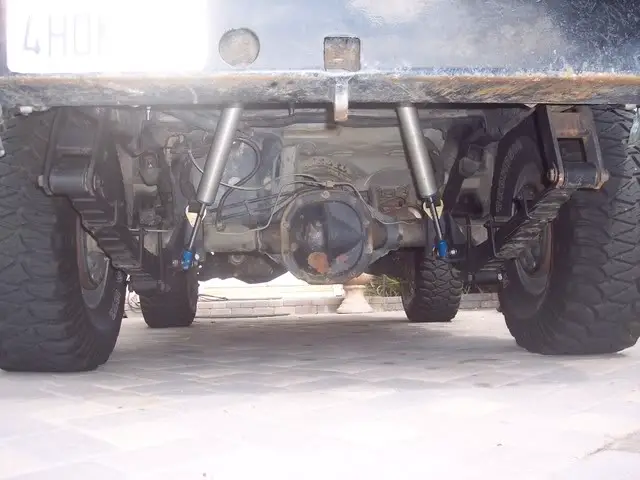

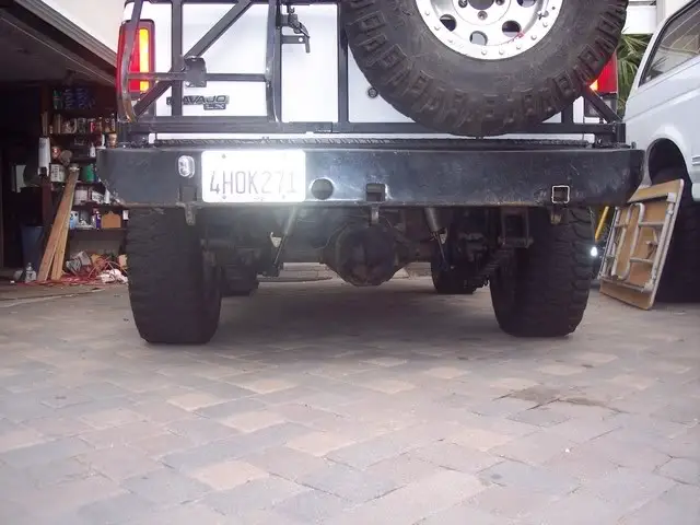

no total chaos mounts :( i saw yours and loved the idea of it and thought about making my own, but the thought of my entire back end held up by my welding was a bit scetchy. i don't know what u-bolt mounts have, superlift maybe :dunno:
aha, well I was fooled, something looked different in the picture but I couldn't tell from the angle.
You'd really need a press/break to make a set. For the $60 bucks I said screw it and ordered them up. They look pretty similar though. U-bolt nuts are protected and on the side of the pack.

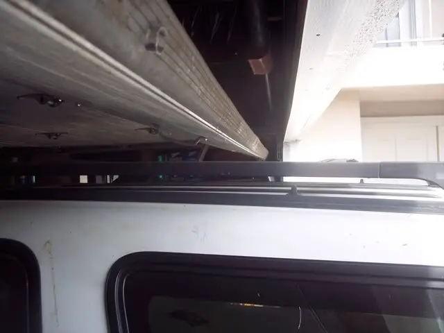

pictures don't want to look so good right now, but the navajo is on its wheels for the first time in a long time.
and i can only raise the car about two inches more and still keep in the garage.

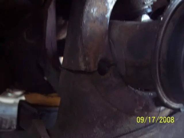

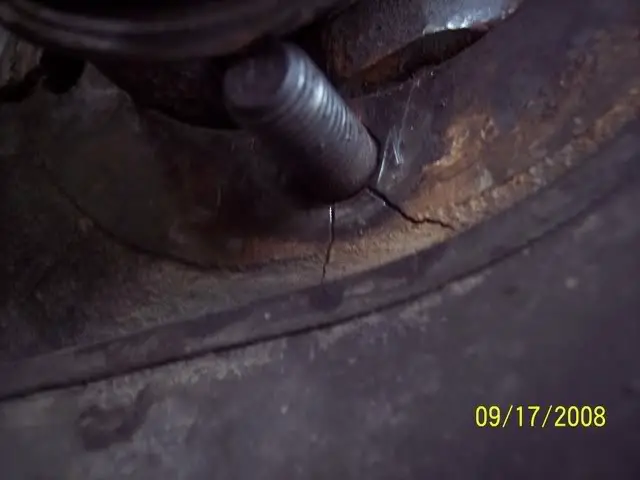

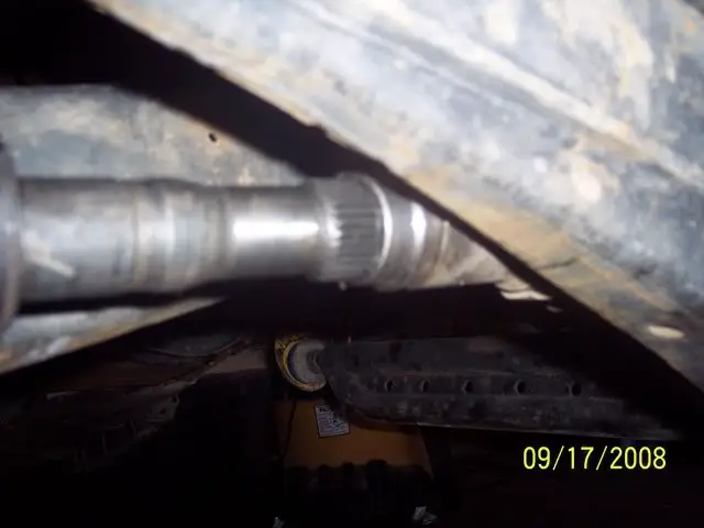

but somewhere between high speeds, rock crawling and braking the steering being pulled out by a dodge 2500, i did some damage to the axle and knuckle.
cracked knuckle, broken u-joint, and the axle slip joint is stuck together. can't get it apart :dunno:
sorry the pictures are so bad
cracked knuckle
slip joint stuck

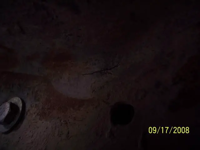

and i don't know if you can see it but the engine crossmember is cracked. need to reinforce it a lil
so im thinking the cause to some of my problems may be that i forgot the put the spacer on the axle behind the knuckle, maybe i didn't trim the slip joint shaft enough, and possibly the limit straps have stretched far enough that the axle is binding
so did you tow it home? that is a big crack
