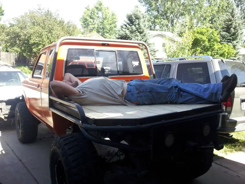

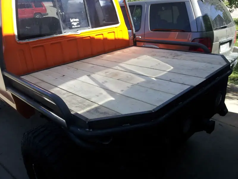

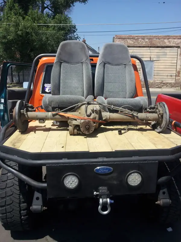

The wood really brings it together, i like it. How far forward did you move the rear axle? And that's good to know about the jeep front shaft, thanks for posting that:thumbsup:

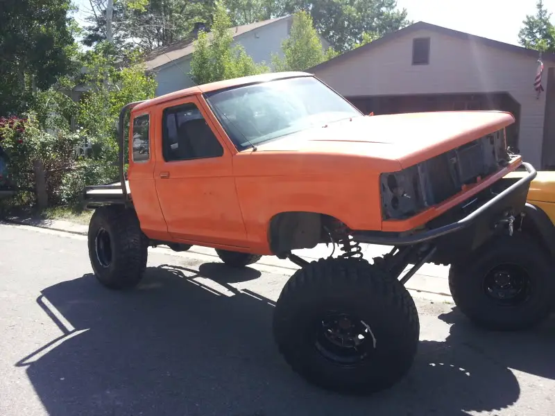

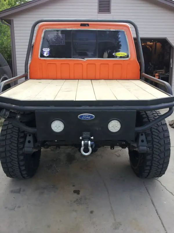

I moved it forward 15 inches. I cut 18 inches off the frame. The flatbed is 4'-6" long but almost 5'-6" wide.

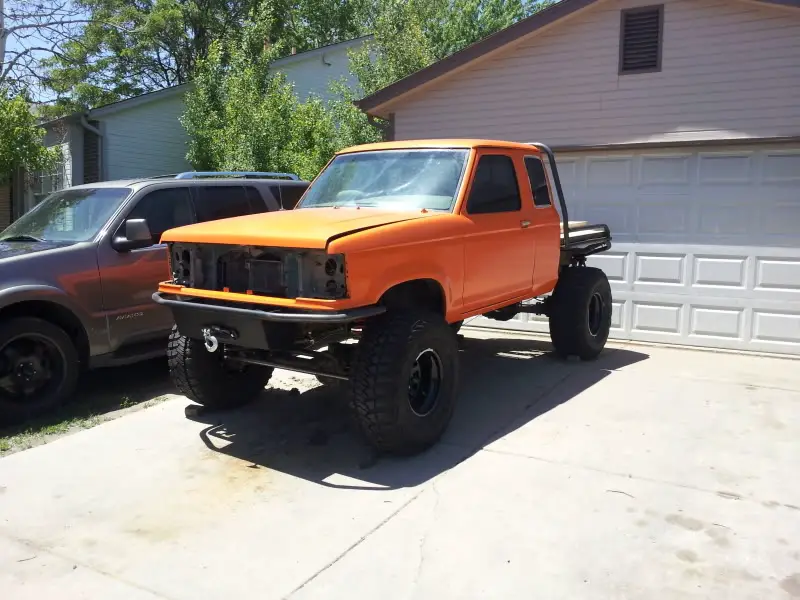

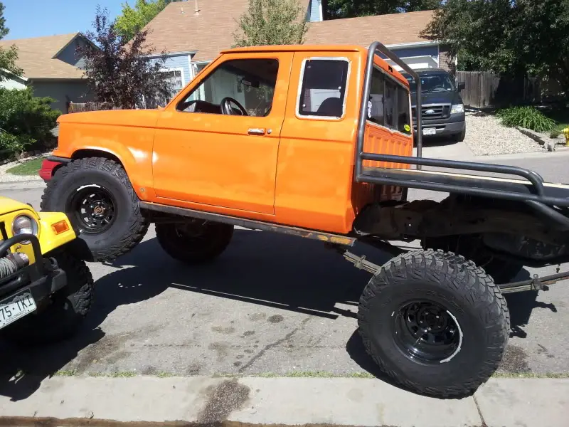

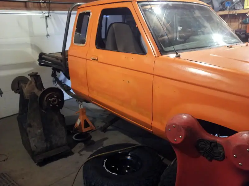

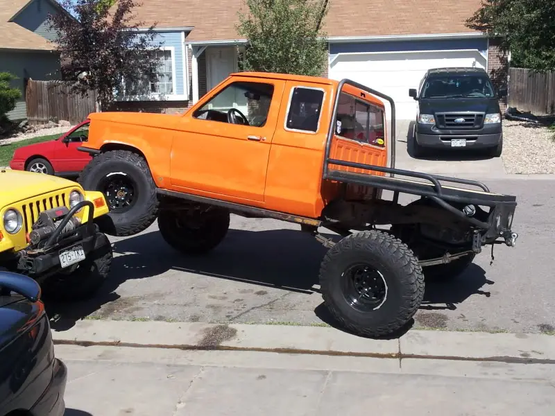

I drove the truck down the street today. Only have 1st gear so didn't go too fast. But the truck drives pretty good. Pulled it into the garage and got the old slush box out. Ready for the one I picked up today. Just hoping the one I got works.
Truck sits about the same height as the Merc. When I pulled the truck into the garage I checked to see how level it was. The back is 1/2" higher then the front. So pretty happy with that.
Got the old bad tranny out.

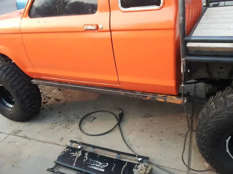

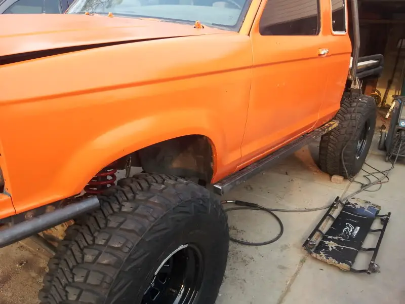

Sliders are started.

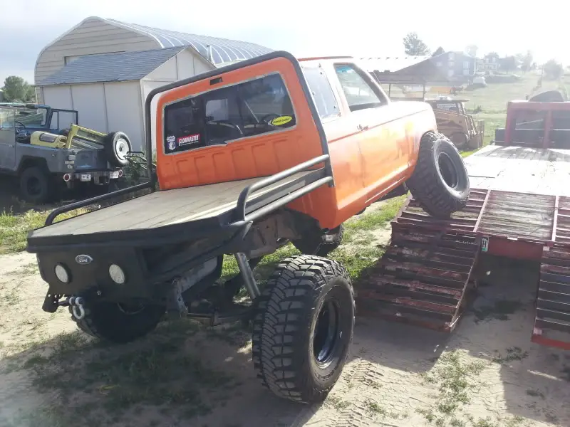

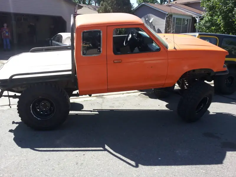

Man that shortened wheelbase looks good, makes me wanna do mine like that now. And that's a lot of wheel weights on that rear tire lol, they couldn't do the stick-on weights on the inside?
Stang5lgt
January 16, 2011
698
2
Parker, CO
98 Mercury Mountaineer

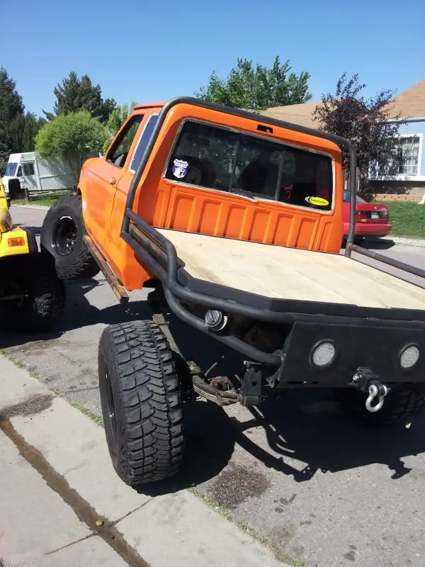

Thanks yeah I love this little truck getting tags for it Tues so I can start driving it next week. All I can say is Walmart mounted and balanced 8 carry in tires with new valve stems for 60 bucks. It took them 3 hours....:eek: Thank God I dropped them off and they were like we are out of sticky weights I was like just throw them on the outside I don't care cause I am doing weld on beadlocks soon. And you can see what I got. LOL ;)

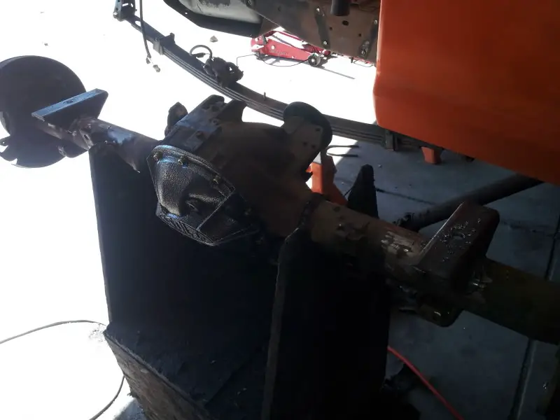

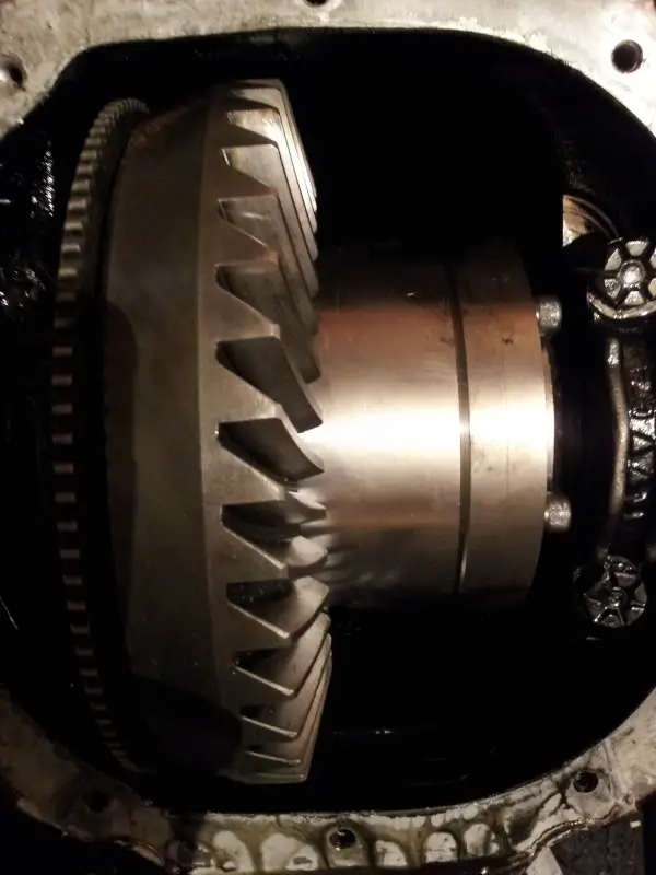

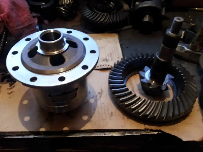

Gears, lockers, and anti wraps today....
So pretty....
4.56 gears and Detroit installed...
1 inch lift anti wraps on...
All done...
Front axle gears and locker after lunch...

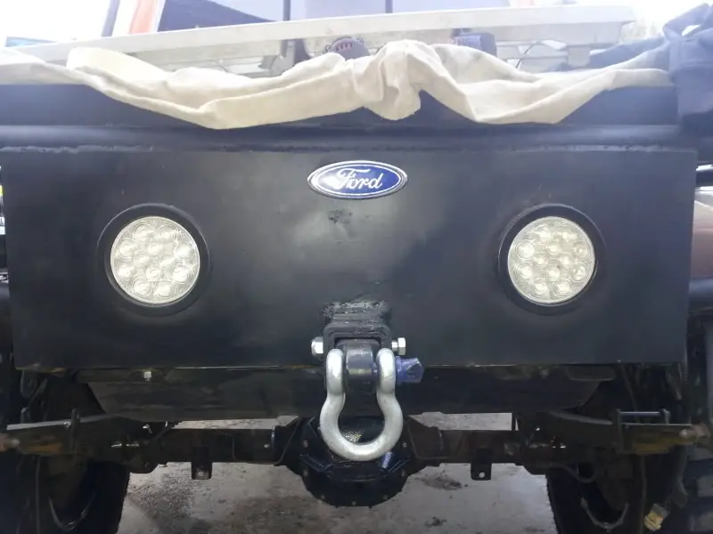

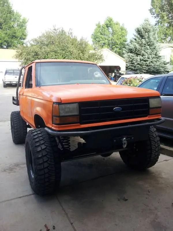

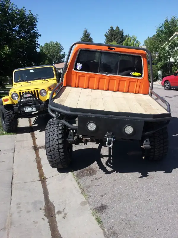

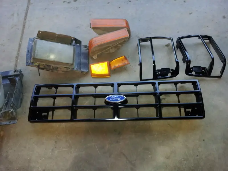

While I was painting the grill I taped the Ford badge on the flatbed going to get one from the Junkyard cause I like it.
I think I will be ordering some new lenses too...

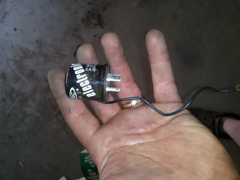

Got the LED working. I had to order LED flasher cause the turn signals just stay on(truck thinks it has burnt out bulb). Should be here later this week.

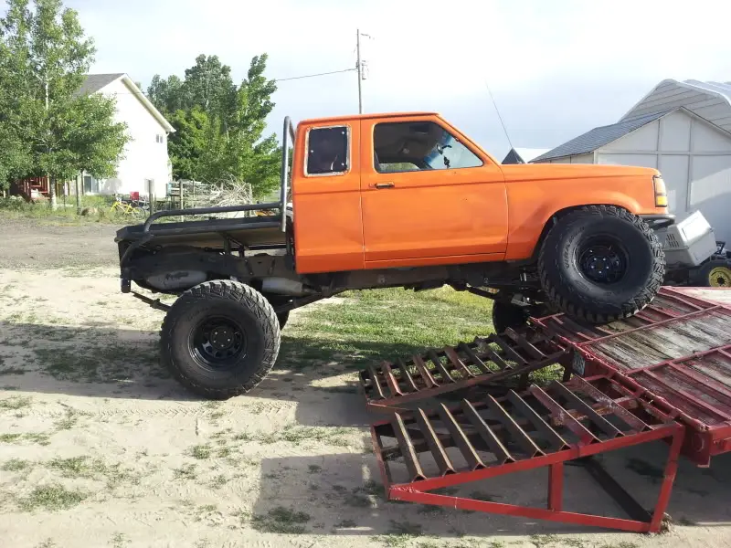

Went by a friends house and flexed out on his 5th wheel...

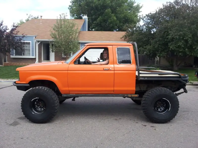

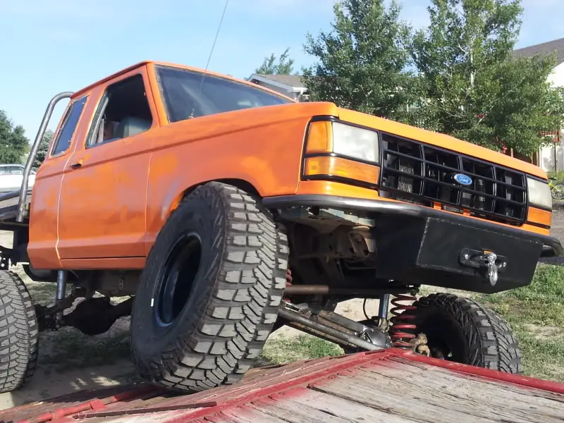

Drove the truck over 100 miles today so far. Picked up some nice 2 door Explorer Sport seats for 60 bucks for the pair at my fav junk yard. Truck runs great and the AC even blows ice cold. Think it still has R12 in it. LOL Hauled a 8.8 with the truck for a customer. Pretty impressed with it so far. Not a speed demon but it can keep up with traffic without too much trouble. NO BUMP STEER at 70 mph and NO DEATH WOBBLE with my tiny track bar. And I still have not put the sway bar back on the front or rear. Truck is very stable in corners and the ride is comfy for a truck. And truck has been turning a lot of heads one guy almost ran his lawn tractor into a light pole cause he was too busy staring. HAHA

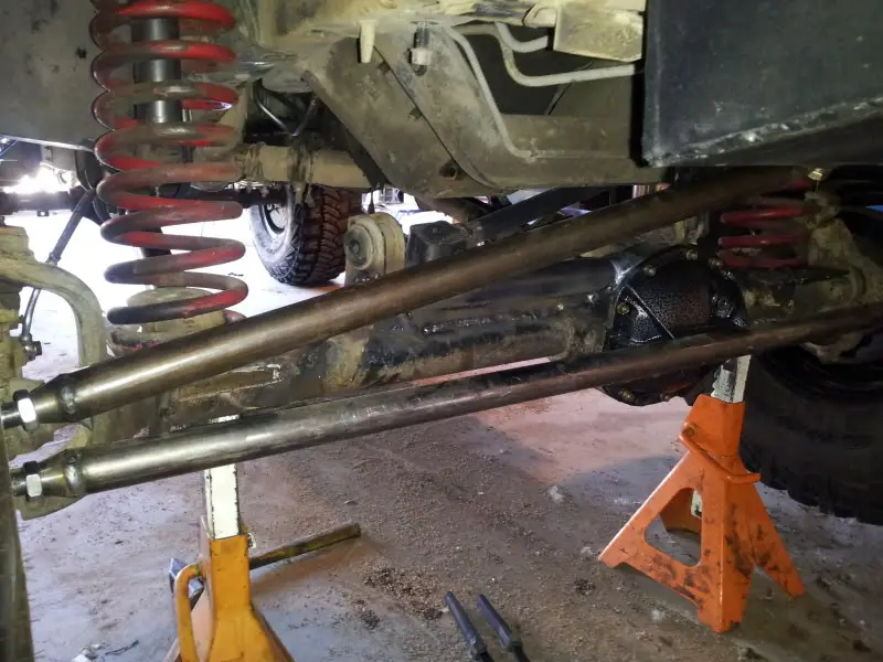

My leafs are the 64" 3/4 ton ones they have 4 leafs. With the leafs and moving the mounts and adding 1 inch lift anti-wrap perches I scored about 7-8 inches. The 6" XJ coils in the front scored me about 7".
Here are some pics...
You can see in this pic where the leaf mount used to be.

I got the LED flasher I ordered. First I plugged it and nothing. I was like WTF is wrong with this thing. I didn't come with any instructions. So after some searching I realized that the prong marked X had to be powered. If it was GM I would be in business but Ford is backwards. So I pulled the fuse box down and reversed the pins. Works like a charm nice to have turn signals. I also fixed some more issues the PO had neglected.
