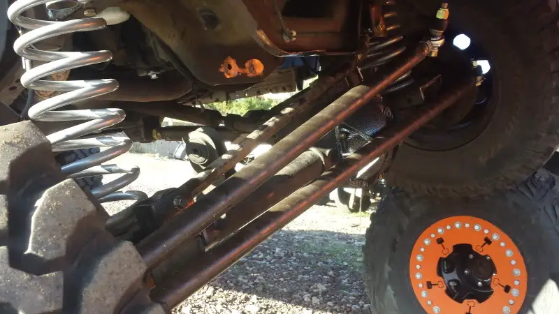

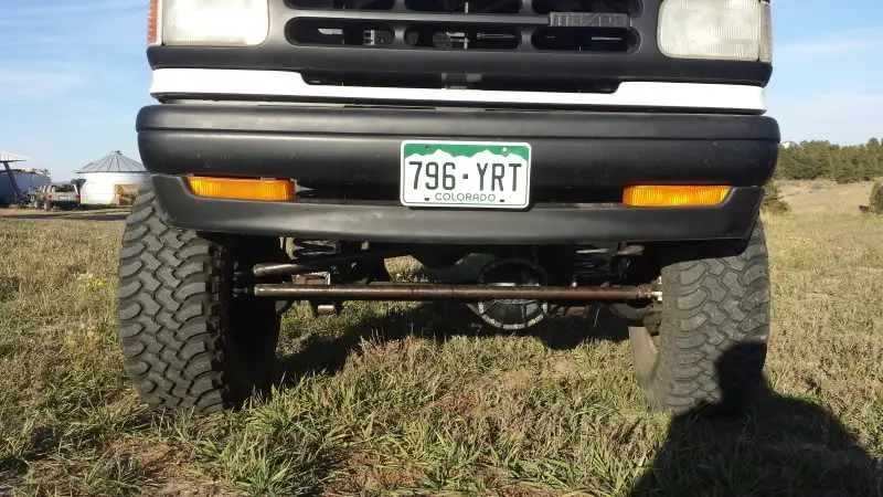

The first Ranger SAS was TNT here is pic...

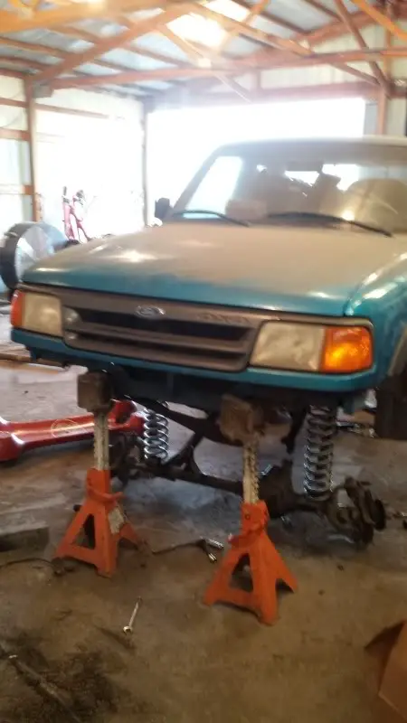

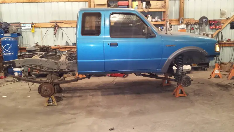

My new Ranger just picked up April 15th 92 Ranger 4.0L 4x4 bad tranny picked it up for $750. Truck has 159k and pretty rust free just a few spots here and there. Code name Rock Ranger otherwise know as Double R.
Already sold the 8.8 and bed off it. I will be keeping this one pretty simple very similar to TNT.
Things I will be doing...

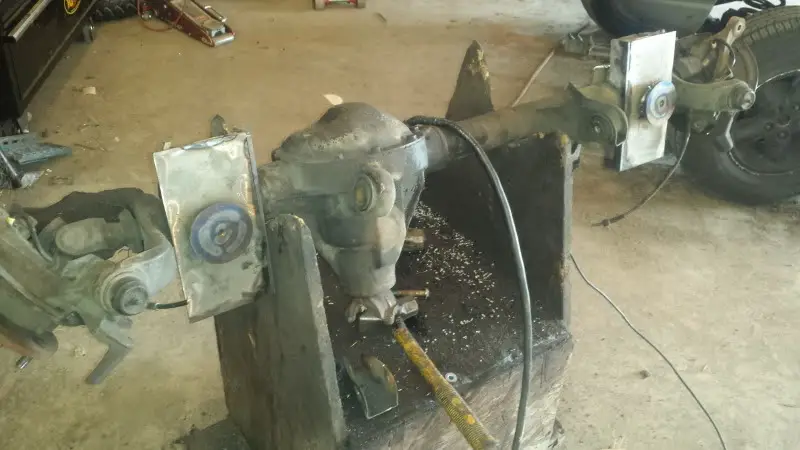

Trussed Cherokee High pinion Dana 30/ Explorer disc brake 8.8 4.56 gears.
Flatbed
Exo cage
Bronco II tank
Chevy 63-64" leafs
Shorten wheel base to 110"
And a lot more. Should be starting this beast next week I hope. Depends how the new kitchen goes for the boss(my wife for those not married).
And for those wondering why the Dana 30 they are cheap and parts are easy to come by. Which is nice if you do need replacement parts. The Mercs D30 has held up to over 13 trails and 35s with beadlocks without breakage so I would say it is very good axle.

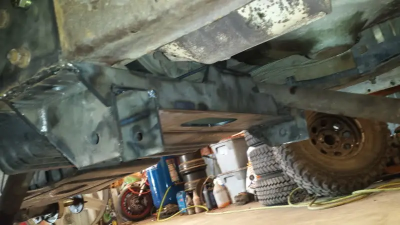

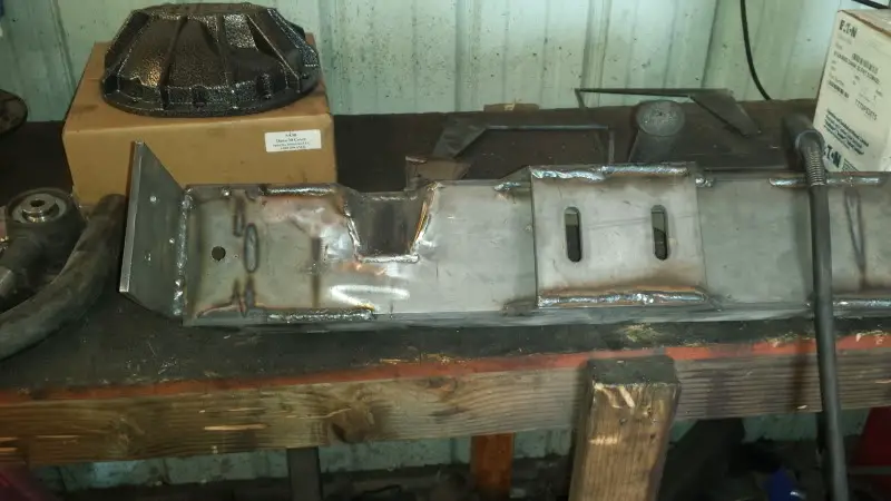

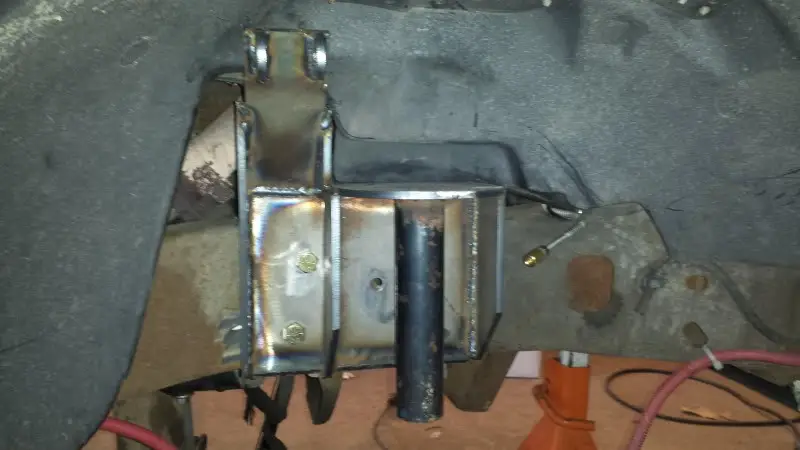

Pass side bucket...

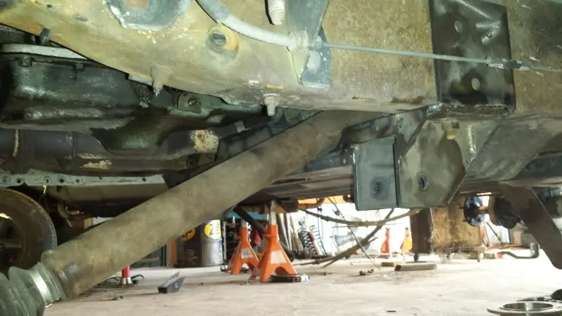

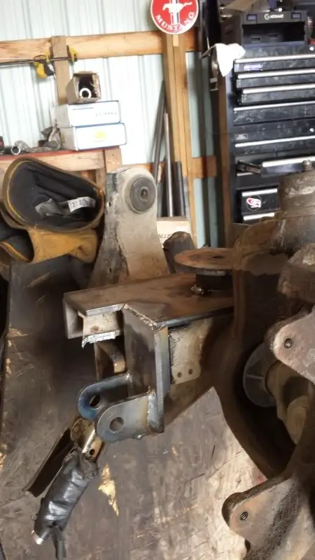

Clearancing the crossmember for the front shaft...

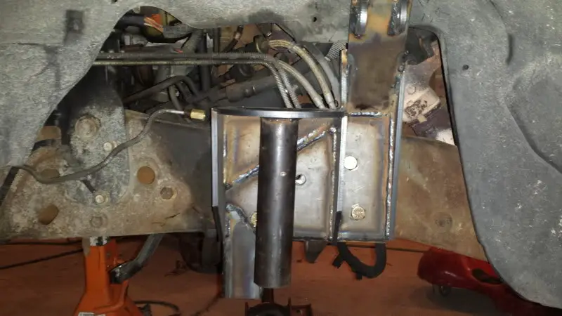

All bolted in. Just have to drill a few new holes for the added supports.

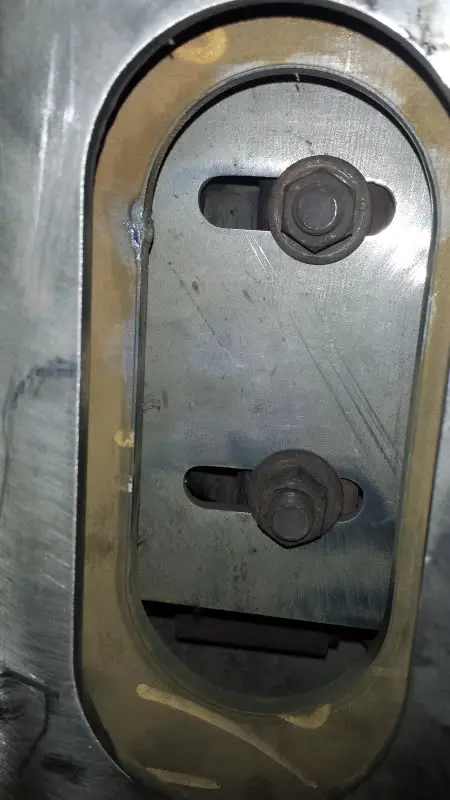

Transmission mount holes...
