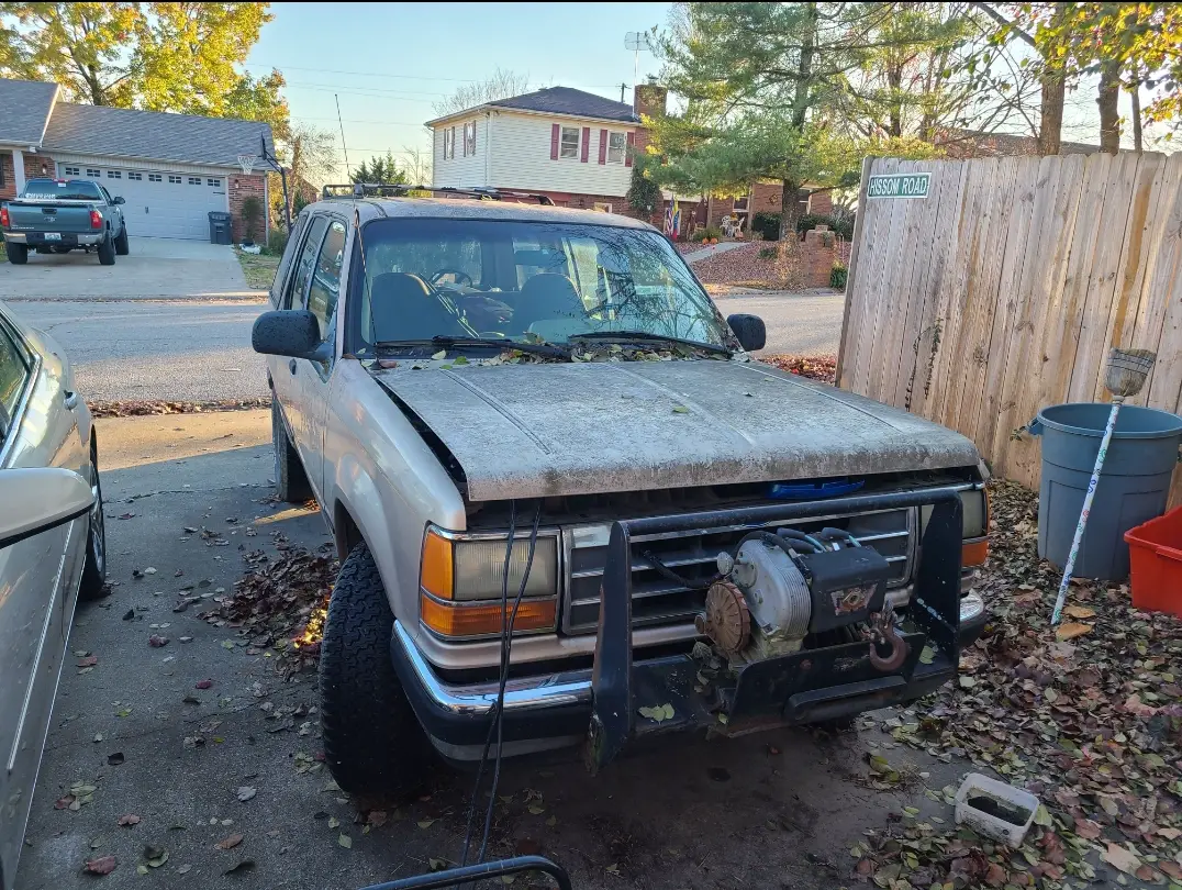

Now to the Explorer! My grandpa passed away a little over a year ago and left behind his 93 Explorer that he used as a vehicle that he would take out to the woods when he hunted or anytime he wanted to get away.
From what everyone has been telling me, it ran well right before he passed. I have always been interested in offroading/rock crawling/overlanding but never pulled the trigger on a project like that. I started thinking about it and I decided that this would be the perfect vehicle.
My goal is to make sure that it is reliable and runs and drives without hiccups. That being said my buddy has a tundra and just got a car trailer so we decided to make the drive to pick it up and start this project!
There is a good amount of surface rust on the frame but nothing structural and the rockers are not existant.
I'm really excited about this but it's going to be a lot of work

Been a Ford technician for 33+ years and I've never seen that style of spark plug do that!! Looks like a good build project and that's one of the best winches ever built on the front, a little overkill for an Explorer but nothing wrong with that!!
I heard the same thing about the winch! I am going to try and rebuild it because I'm not sure if it actually works and decide whether I want to keep it or sell it to fund some other things.
I will probably put up a summary of the rebuild here when I get to that.

Not too bad to rebuild and all parts are available, that winch is over $2,500 new!! I have one I need to rebuild for a Early Bronco camper build I'll be doing in a couple of years. Rebuilding the legendary Warn M8274 electric winch step by step

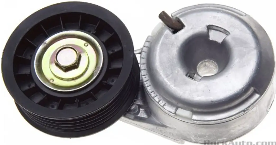

So since the truck was at least running, I decided to tackle the accessory drive since it was extremely noisy. Bought a tensioner and belt off of rockauto and when I got it in noticed that it is very different than the one on the engine. The one on the engine is held on by 2 bolts and the one that came had just a center bolt like below.
Odd, but decided to just go to oreilly and pick up one and bring the old with me. Once I took the one off, I spun it and it sounded like sandpaper rubbing against itself so this was definitely the sound culprit. When at oreilly we figured out that the 91 explorers had the 2 bolt tensioner design. So not really sure if maybe the engine was replaced at some point.
Replaced the belt and tensioner and sounds great now! No accessory noise anymore.
