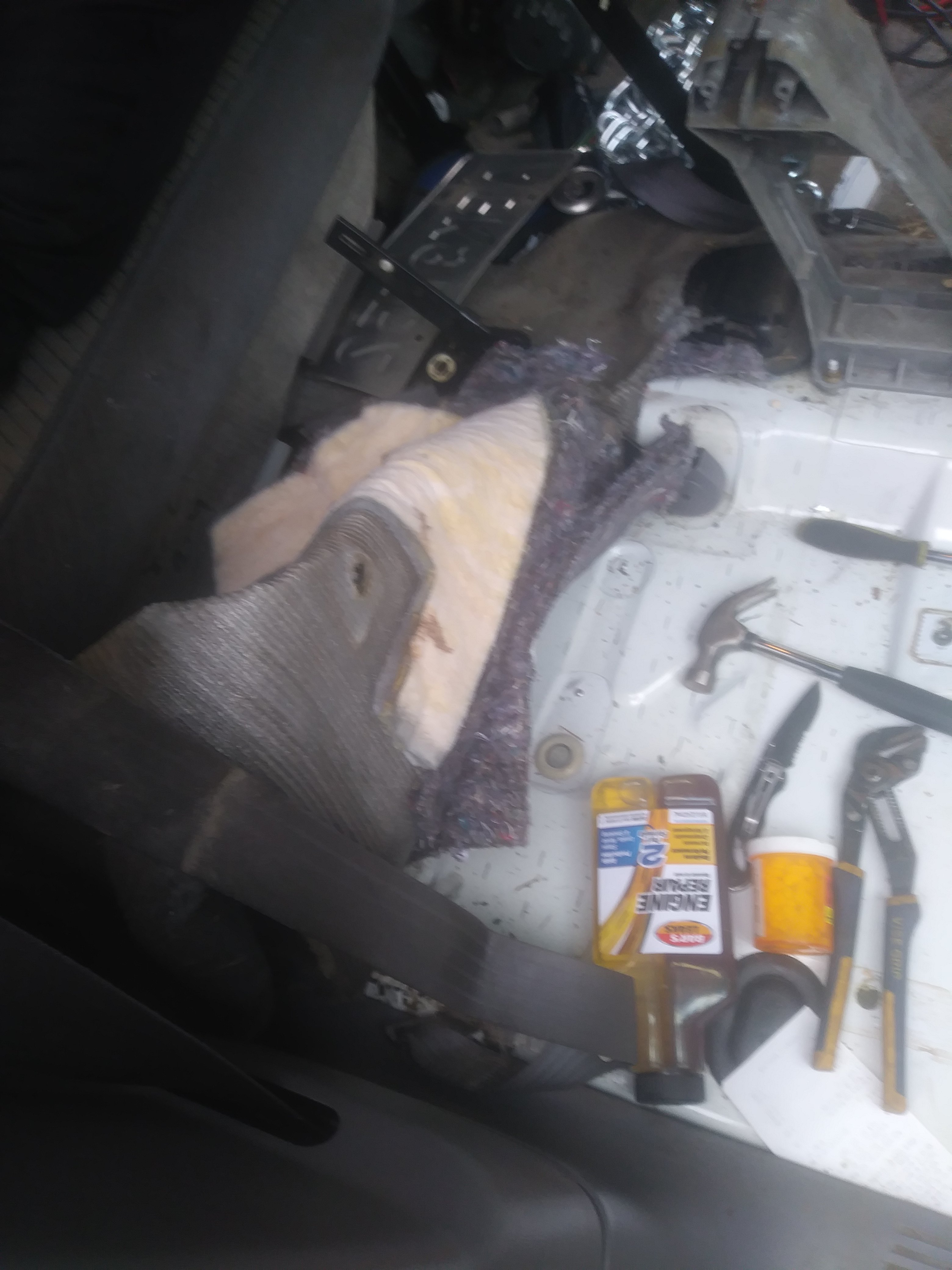

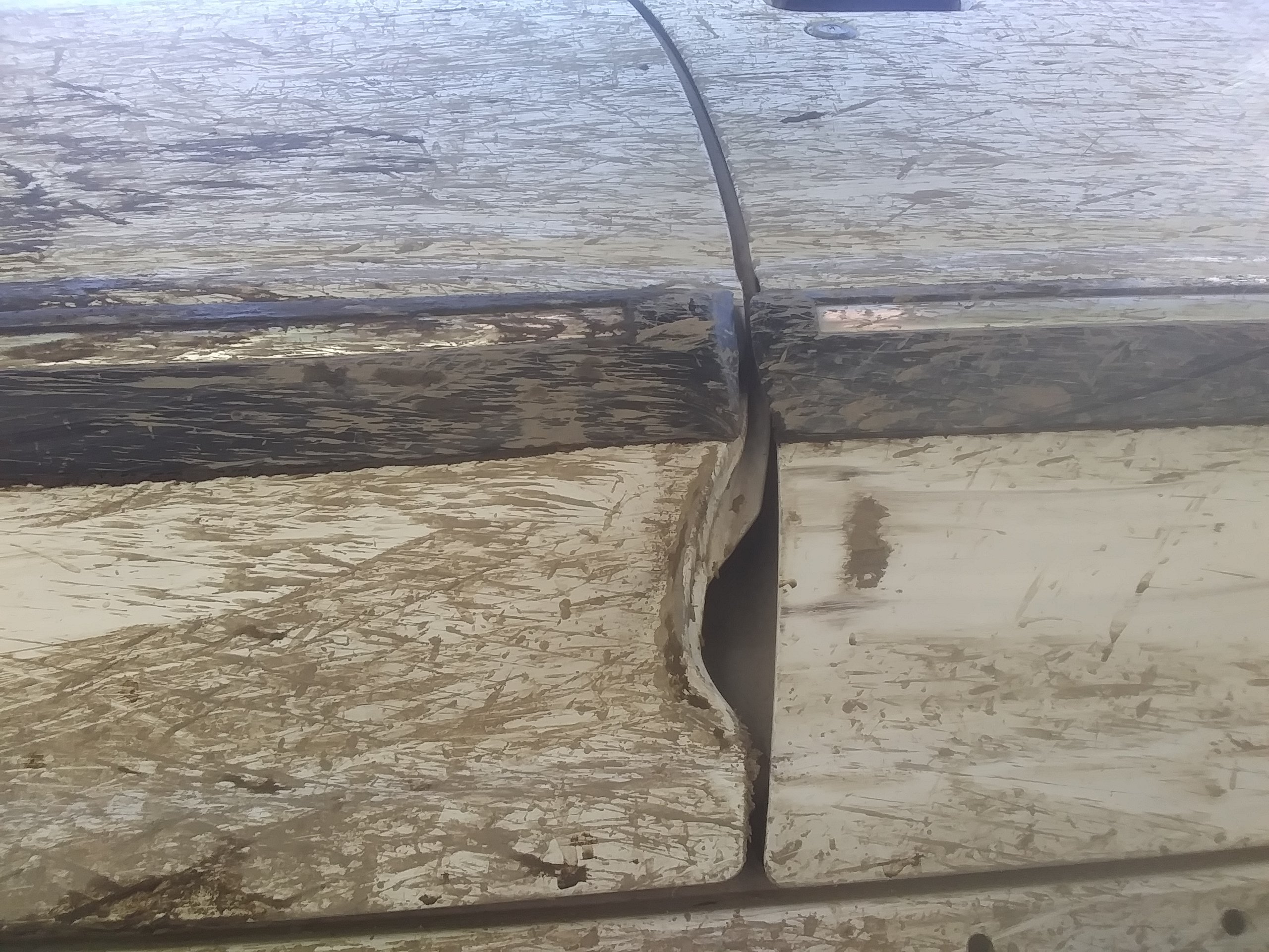

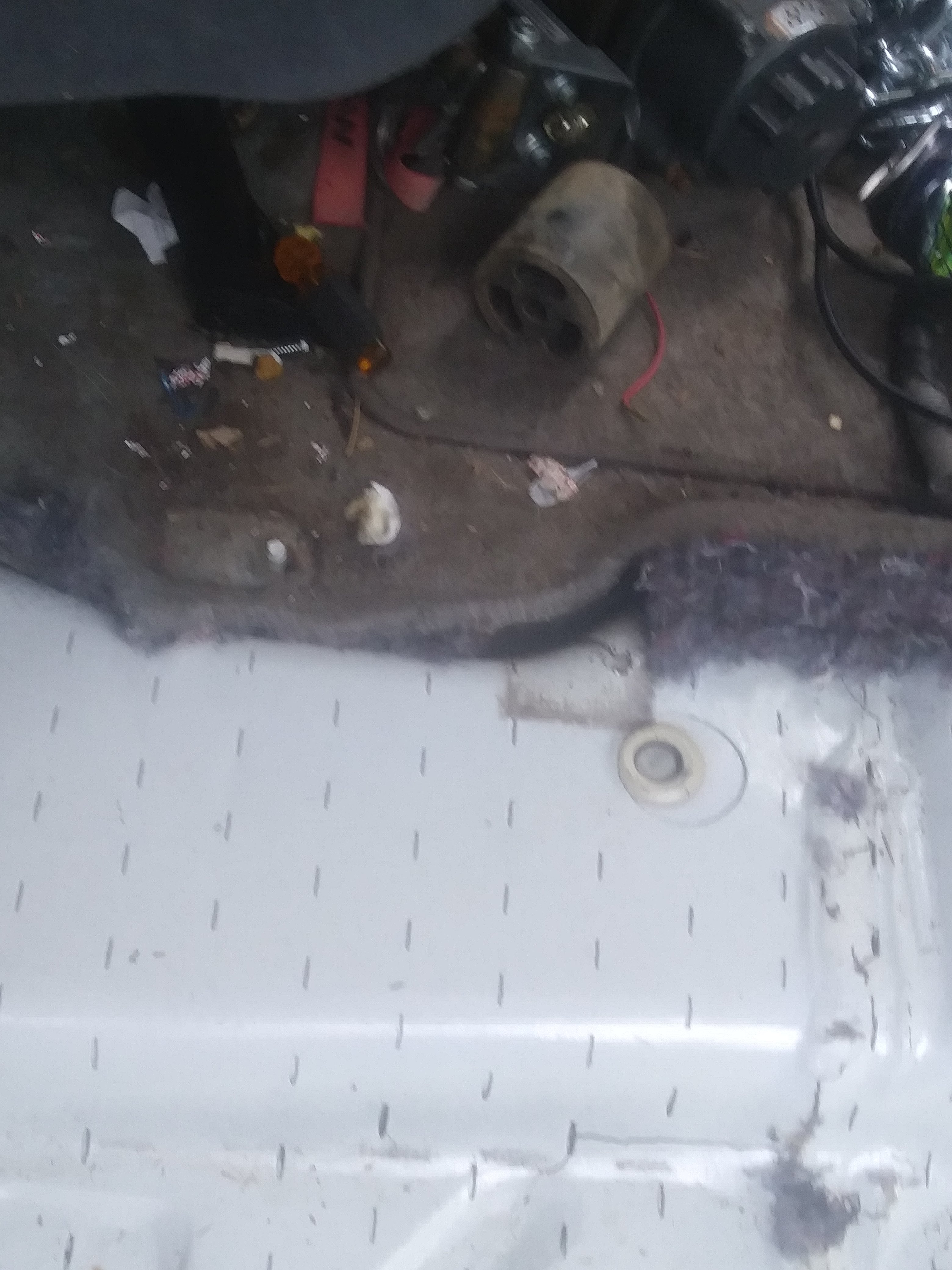

Ripped all the carpet out of it broke radiator so I decided that since I have a broken radiator and have totm buy a new one I do the body lift right now so I started it today changed out the air conditioning pump as well because the other one froze up

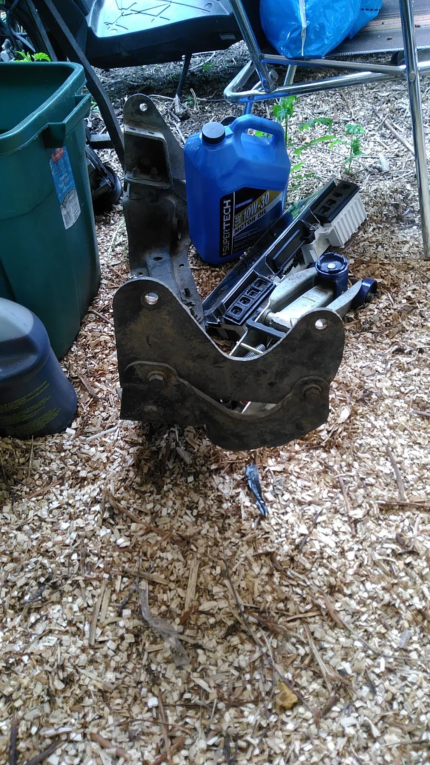

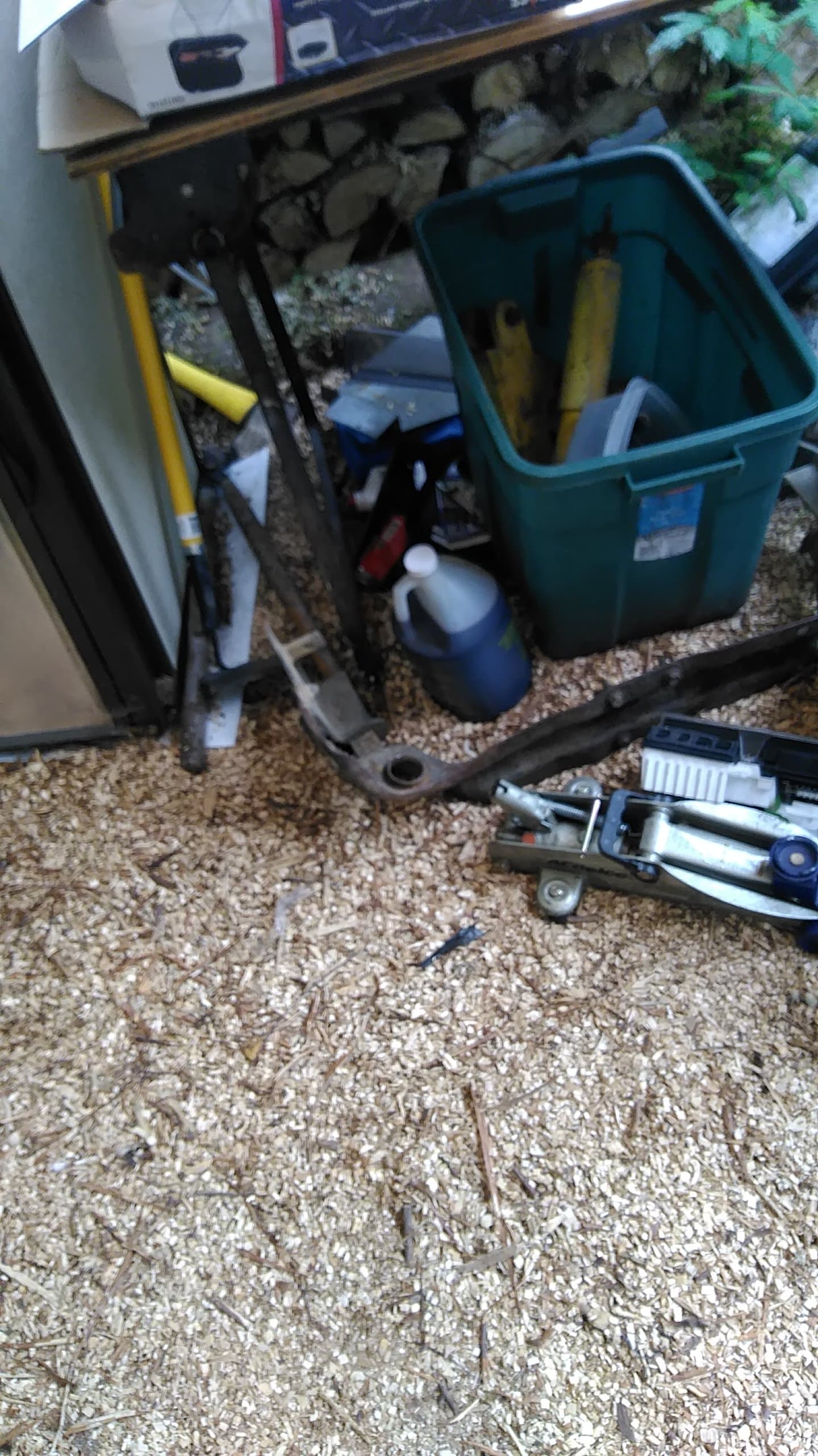

2 to 3 in inch rear shackles 2 inch spring spacer 1 Inch spacers

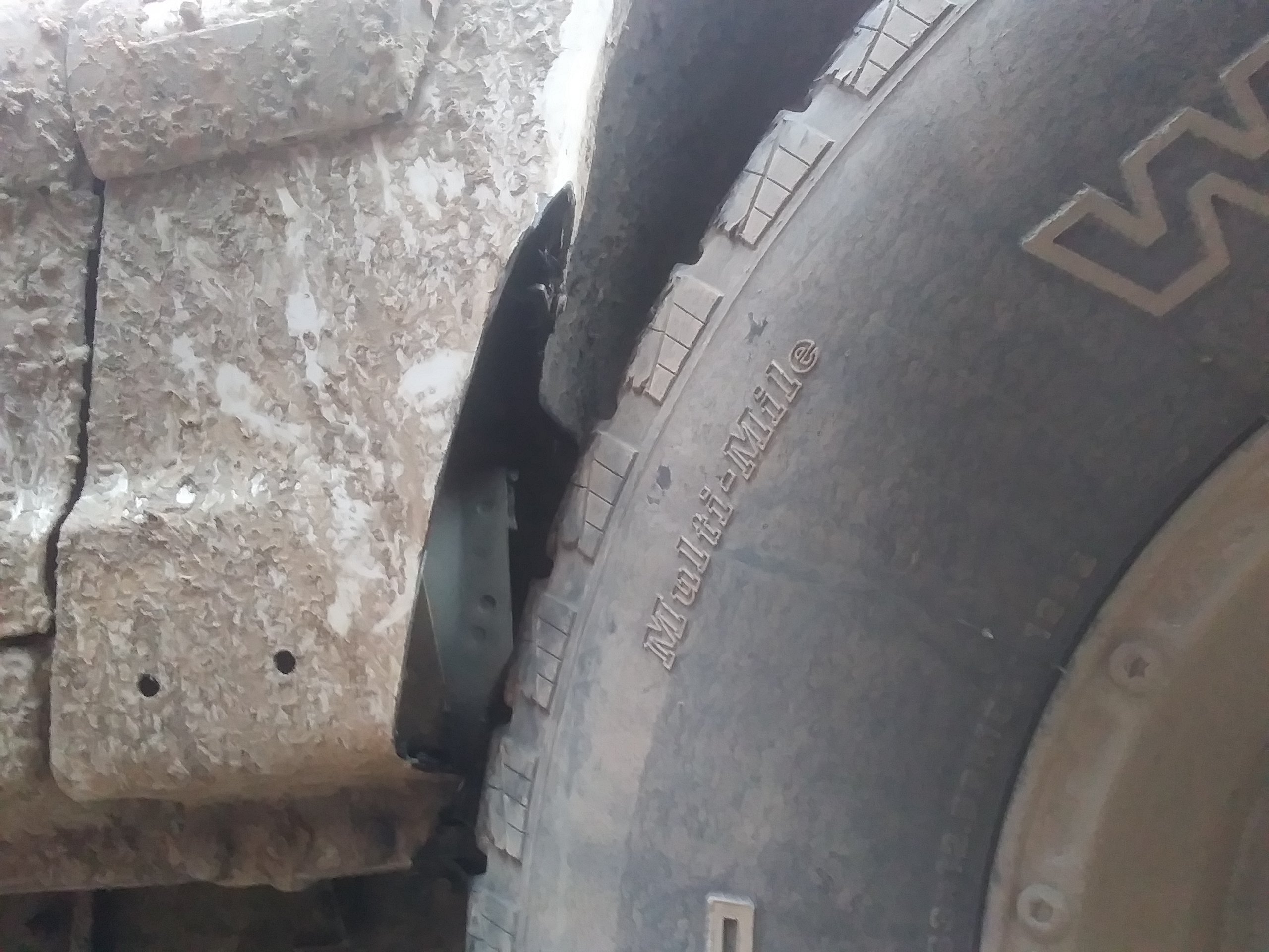

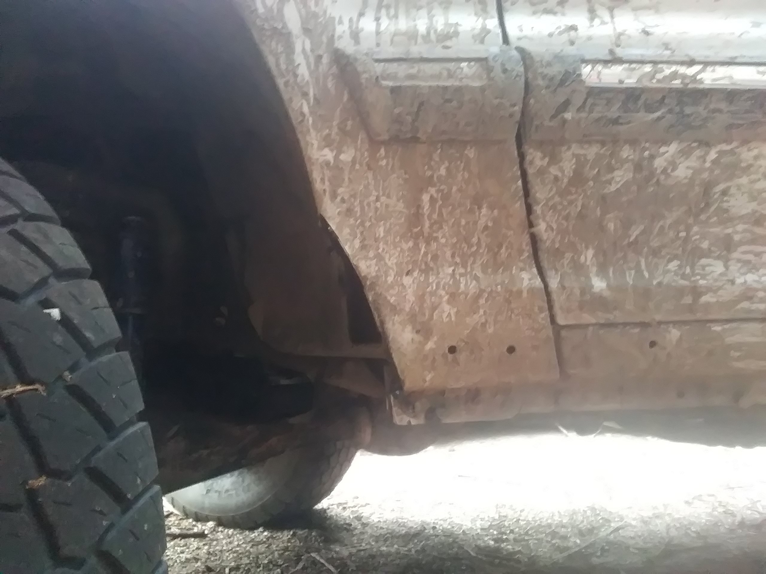

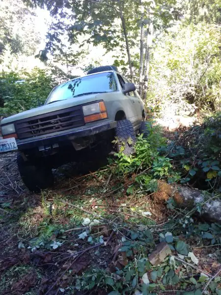

Got rid of automatic locking hubs for manual locking hubs replace the front bumper with a winch bumper put my 33s on going to have to trim the fenders got a custom-made back bumper for need to build the brackets to mount it and put the plate on top

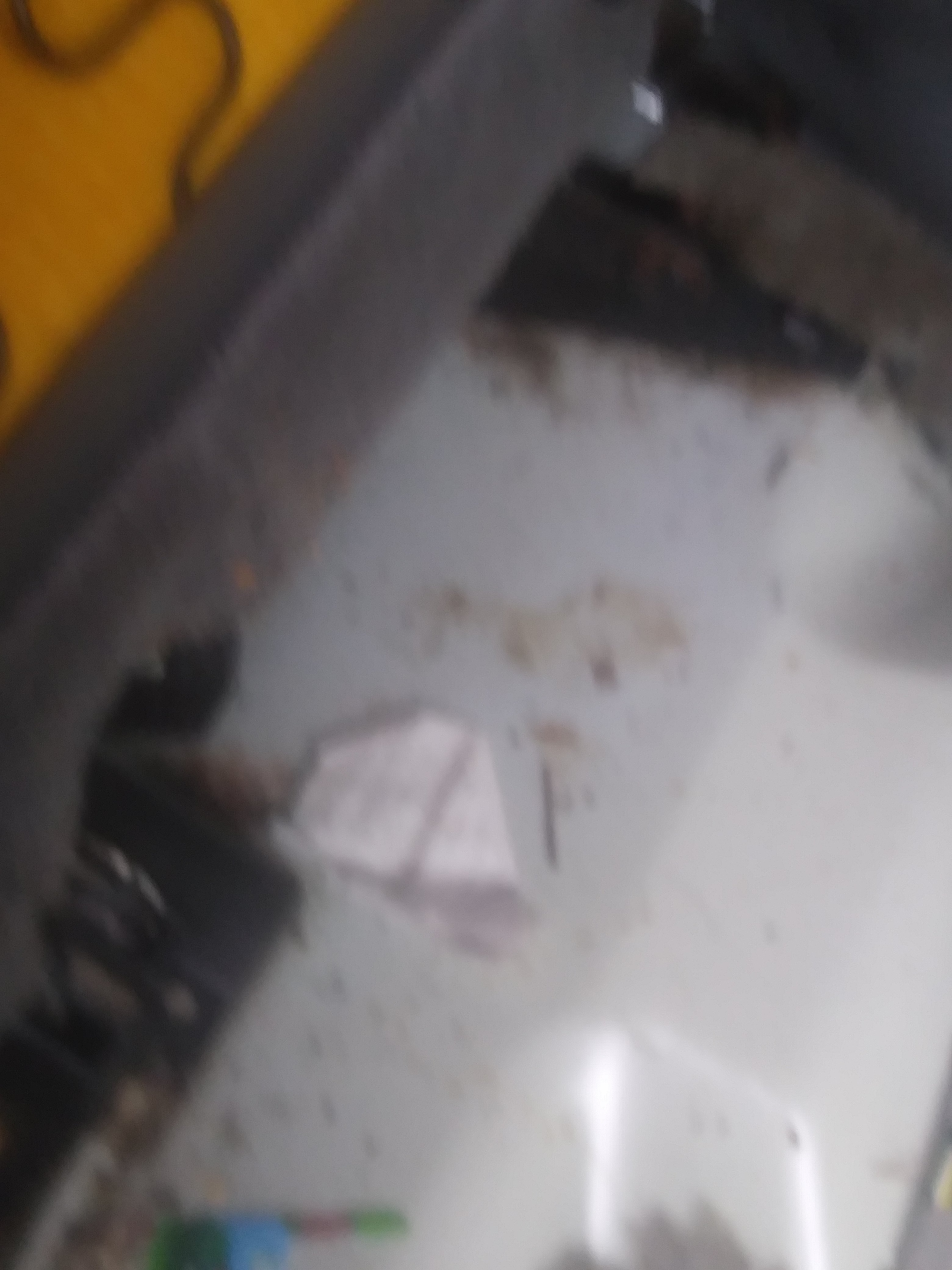

First war wound and massage the front fenders just a little bit

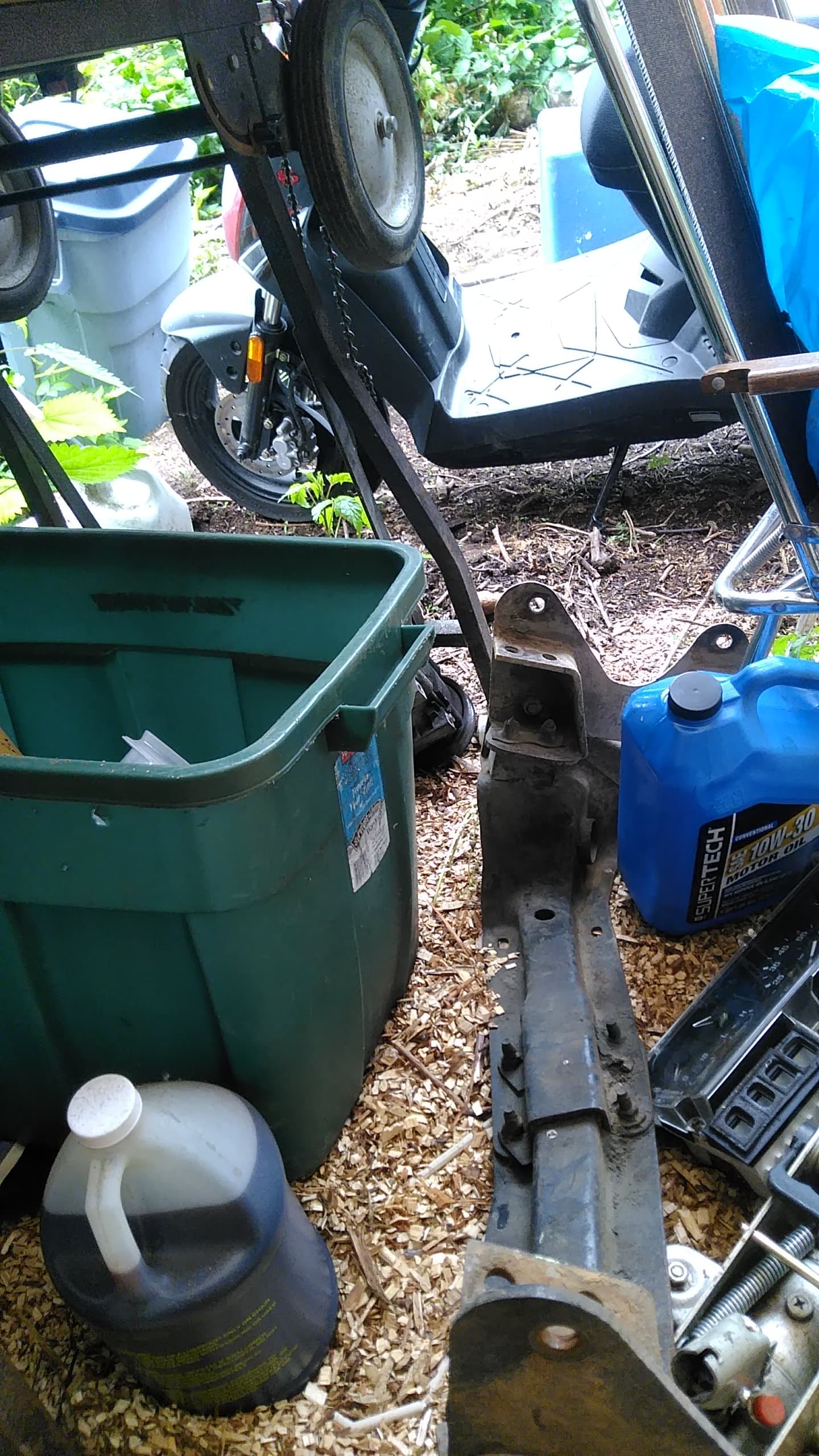

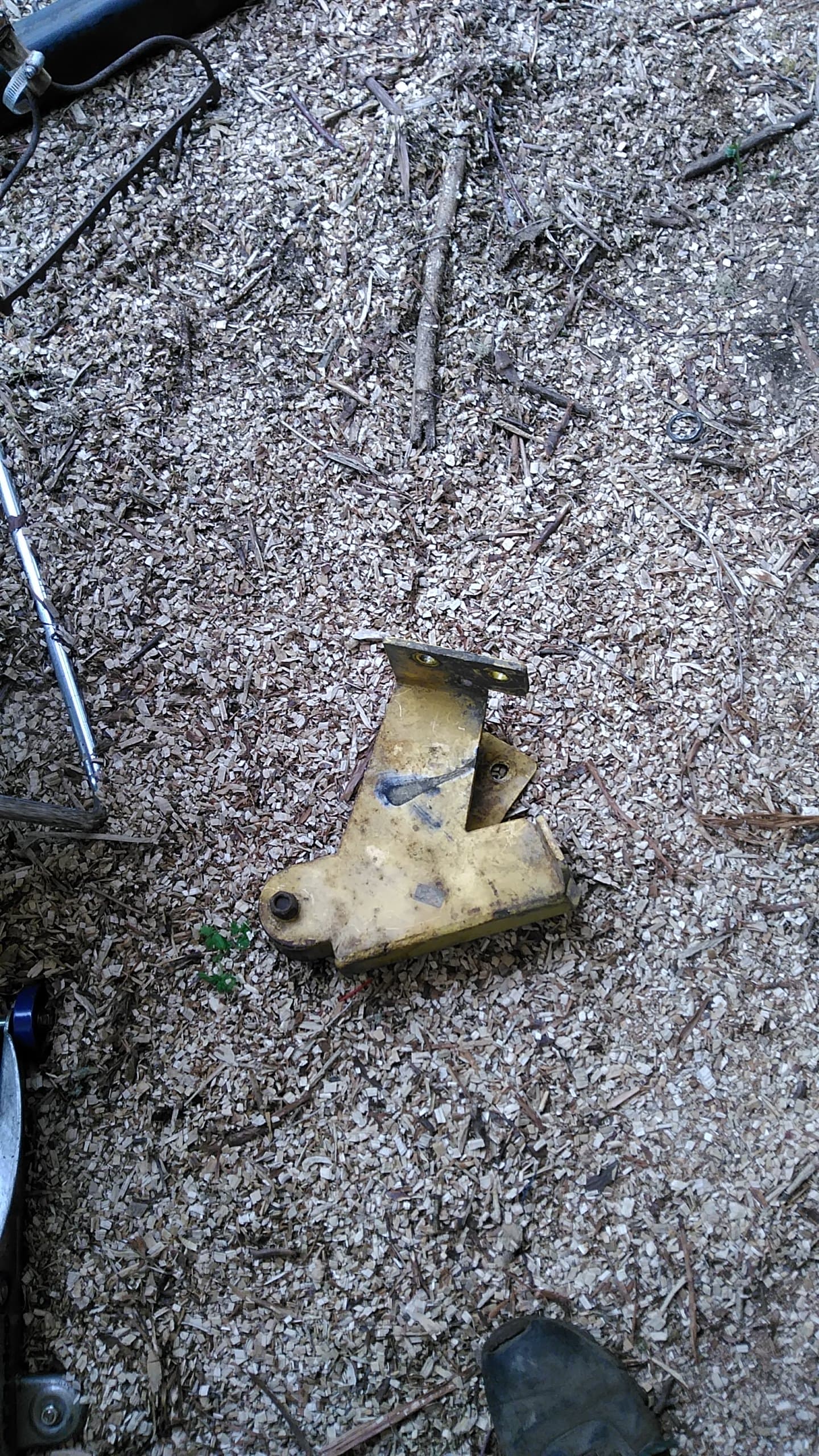

Got my lift brackets my Springs and all that today for my Explorer got them off of the 84 Ranger put on my 94 Explorer they look like they should all everything should all bolt right up

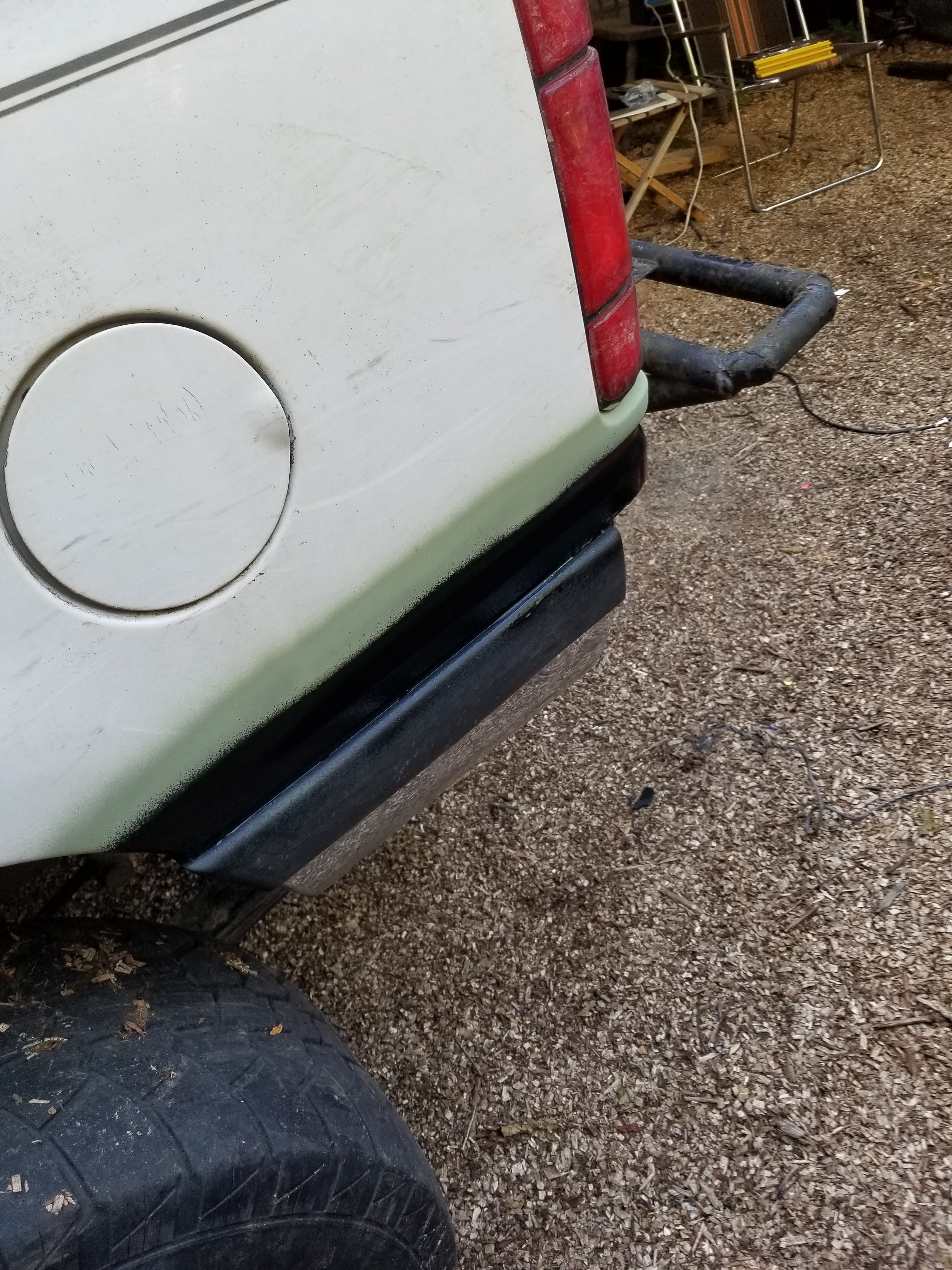

Finally got my new rear bumper on my truck got to make some modifications to the Rock sliders I got off a jeep so I can get them on

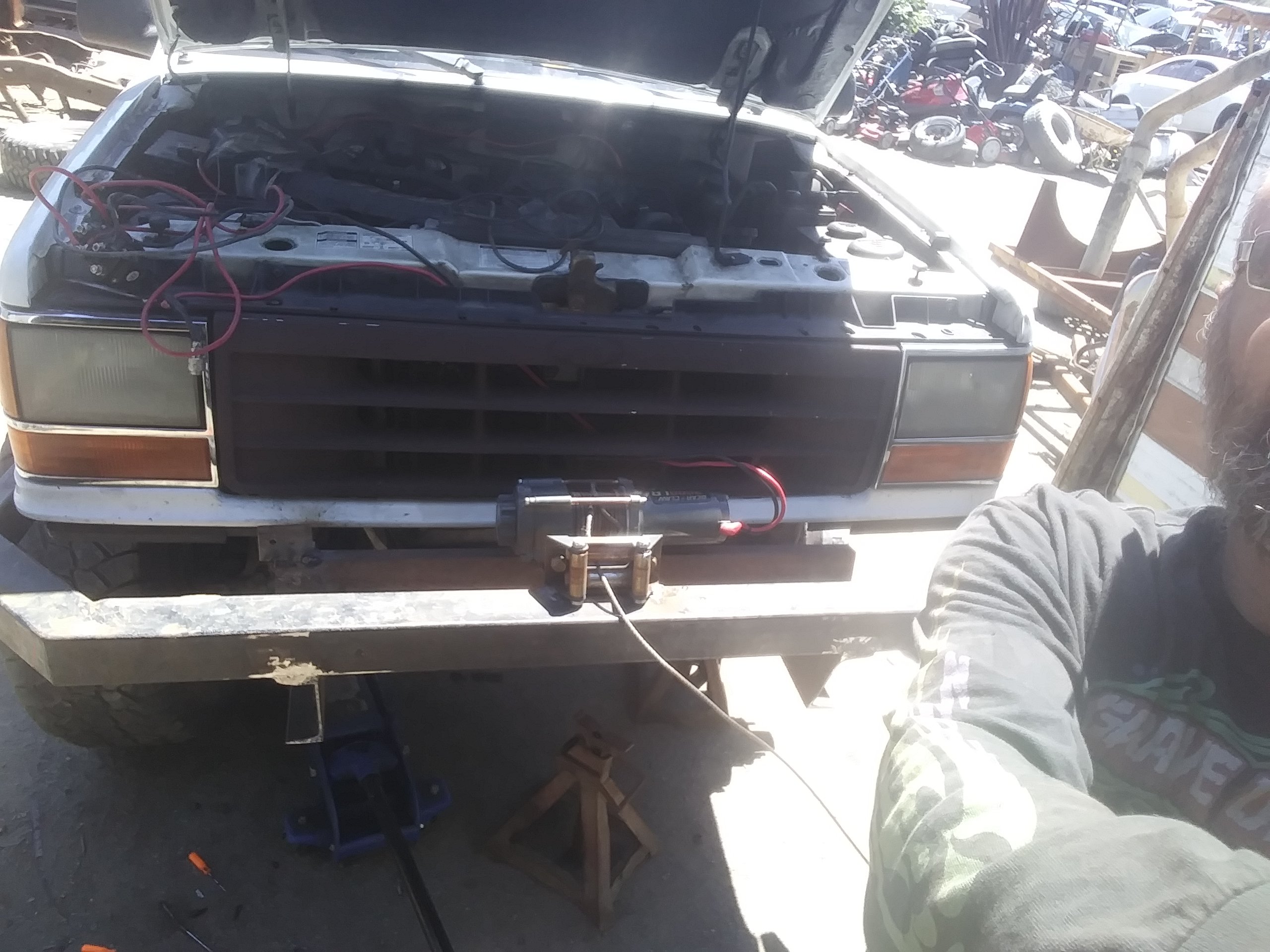

May have encountered a setback today I may have made my little wench Explorer I may have burn it up today I got stuck I in my own yard and unfortunately I found out that there was a short and the switch to go forward and reverse in the and the wiring and it' stuck cranking in until it would not go anymore now all it does is click click click what she's the winch motor for the solenoid burned up today

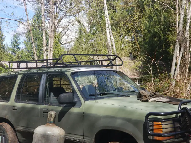

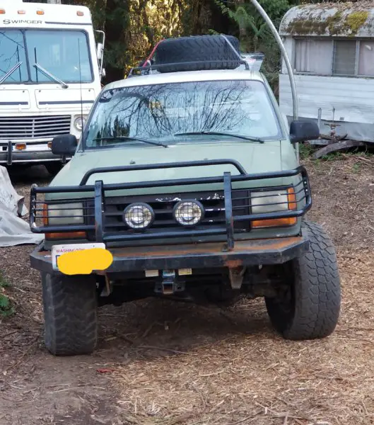

Valve cover job on little green Exploder painted little green exploder got some more work done on my front bumper got some plate to weld in
Have a little bit more to do on the paint like the roof and a pinstripe between the two tone Olive still haven't pulled my electric winch apart yet to find out how bad is fried Ray rig my hand crank winch so it'll work better
Thank you for all your likes the truck is coming along slowly
What is the grill guard off of? Is it originally made for an Explorer? Those are tough to find these days.
I cut it down and trimmed its solid fit on the bottom made my own brackets
