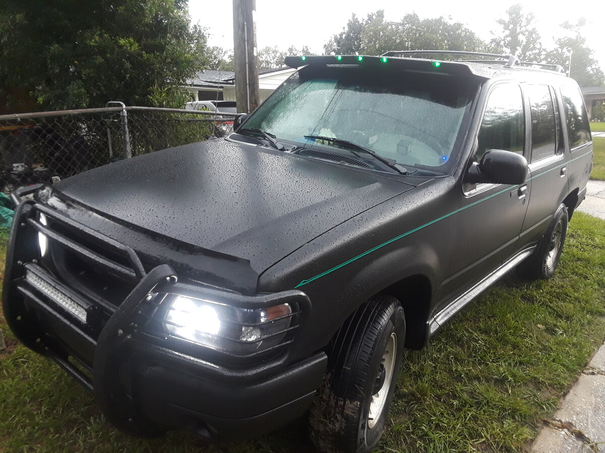

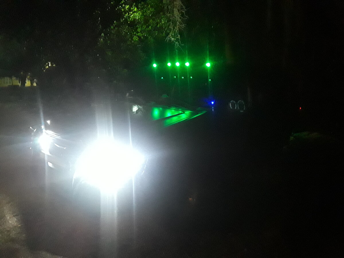

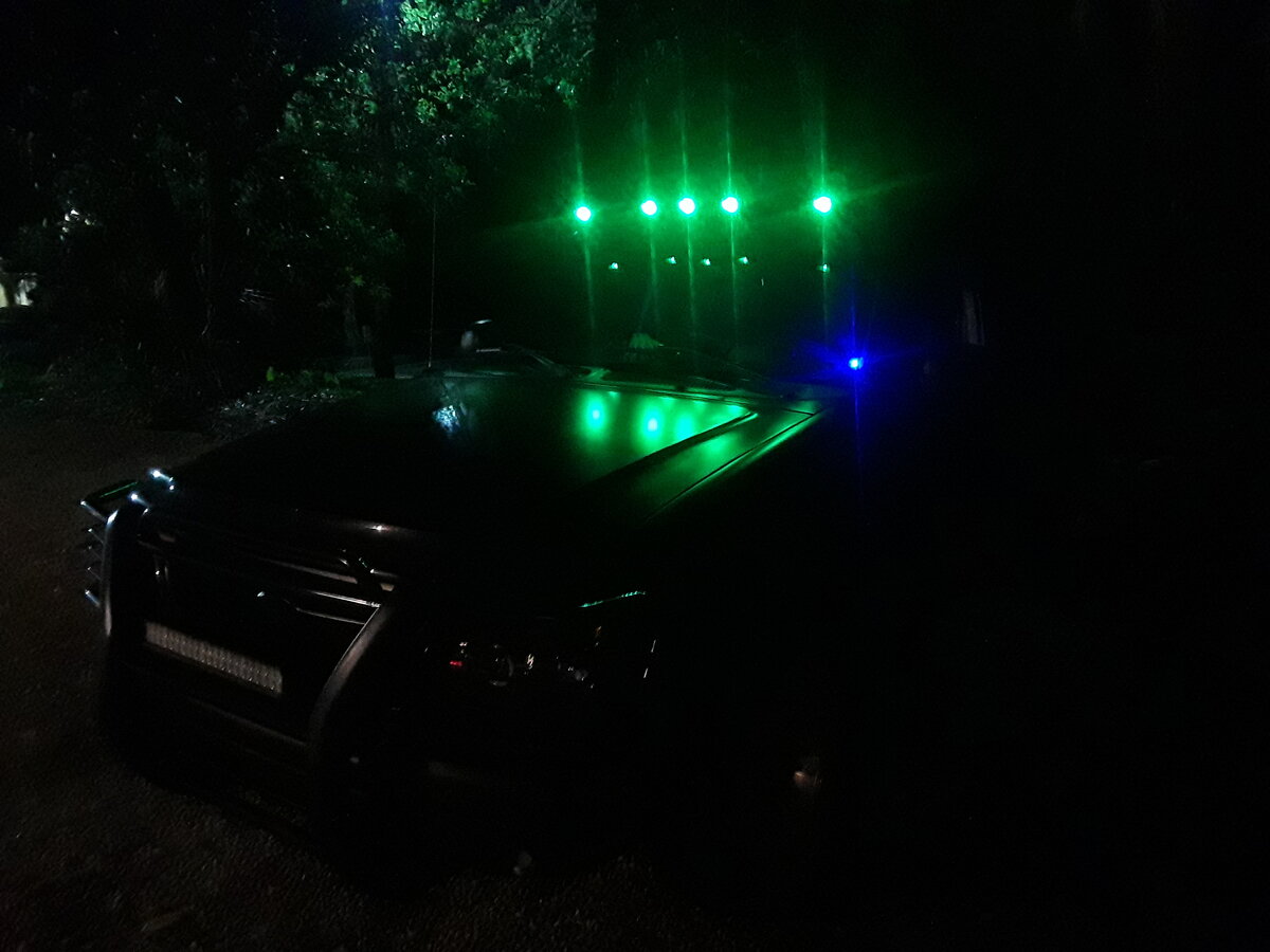

And well, well, well...I love when you manage to wire something on your own when no one thinks you can. Sat out there for a whole day testing and being sure and by the next morning, bought the right amount of wire, a new switch, etc. And had it up in an hour. Did also replace the bulbs with green LEDs to match the truck, which are lovely to see. Now, back to figuring out lifts, tires, wheels, and etc.. to hopefully happen early next year.

I tried to install 1 of those on a 1st gen. Failed miserable. It flopped at hwy speeds & eventually torn the holes on the side & went flying down the hwy. Yours looks good though.
Oh dang.....sorry to hear that man, heard of a couple of wobbly ones, never that. So far mine seems fine, haven't heard or seen anything from it
