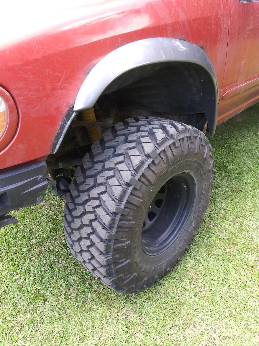

The turning radius definitely is nicer! Ford is good with that in general to be honest

@DemonMudder Agreed, and thanks - there's a body shop in town that has me covered, just need to save up some cash after that axle work! When I'm not lazy, I'll put the flares back on and get some proper pics.
@Fix4Dirt I was just going to have the local Ford dealer reprogram it; for one use in a life time, I don't feel the need to buy specialized equipment. I know of several tuners that can edit such factors; hopefully any who find this thread will find your recommendation useful!
@Stynx No need, just buy a 1st or 2nd-gen and join in the fun! Never underestimate the auto/IFS combination, just know its limitations and use it well. IFS is good for moderate speed, low-flex applications. If you do decide to lift and wheel your 3rd gen, there are many threads that cover the right and wrong ways to do it, and things to look out for!

Took her out for a run on some asphalt, gravel, dirt, sand, and mud this week with a pal. The torque control is very, very different. The shorter gears make it feel a lot steadier in all conditions off road, just as I expected, and it crawls its way out of just about any thing, thanks to slower, less jumpy accelerations. Traction is almost infinite, but stopping in mud is still doom, no matter what your gears are. We wrapped a tow strap around the front tire and reeled it in like a winch. Don't do that if you're really stuck, because it will strain your hubs.
