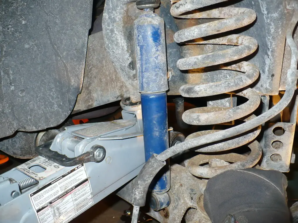

1. Remove front wheels, unbolt shocks (completely, if you're changing them, just the top of you're leaving the old ones on for some reason), and remove the coil springs. Good, let's continue. By now you should be building some false confidence that this is going to go really, really well
Strategy for getting coil springs out...this doesn't have to be dangerous if done "correctly"

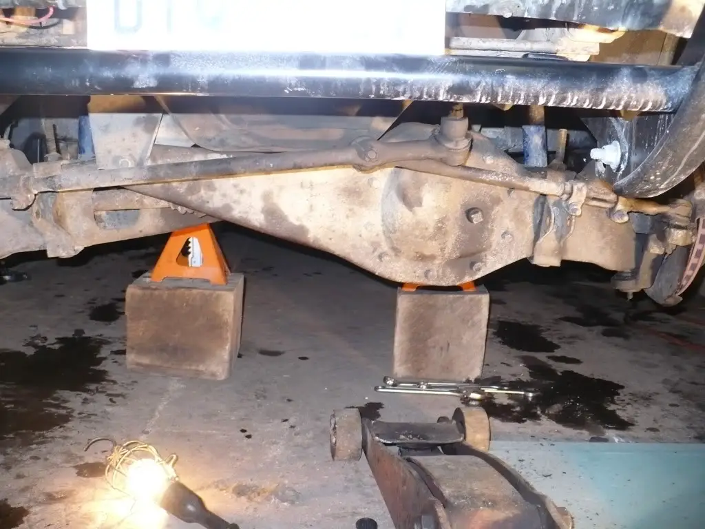

2. Begin taking off the driver side axle pivot bracket. Ok, this is my first tip for the non-mechanics out there. Ford has a TTB front end. That stands for twin traction beam. Basically, take a step back (or a scoot if you're on a creeper) and look at the front end. There is basically a long flat 'X' made by the axles. The driver side hub is connected to a pivot point on the passenger side and vice-versa. It took me like 10 minutes to realize that. At first I just thought the instructions were wrong, lol. (Yes, I will be admitting all my idiotic mistakes along the way.)
Anyway, that bracket goes pretty smoothly. Another hint though, get on Rough Country's website and print off color instructions. The one in the box look like they were photocopied off a 1970s Xerox from a picture taken with an old Polaroid. Really. Anyways, this step is wonderful for building some more false confidence.

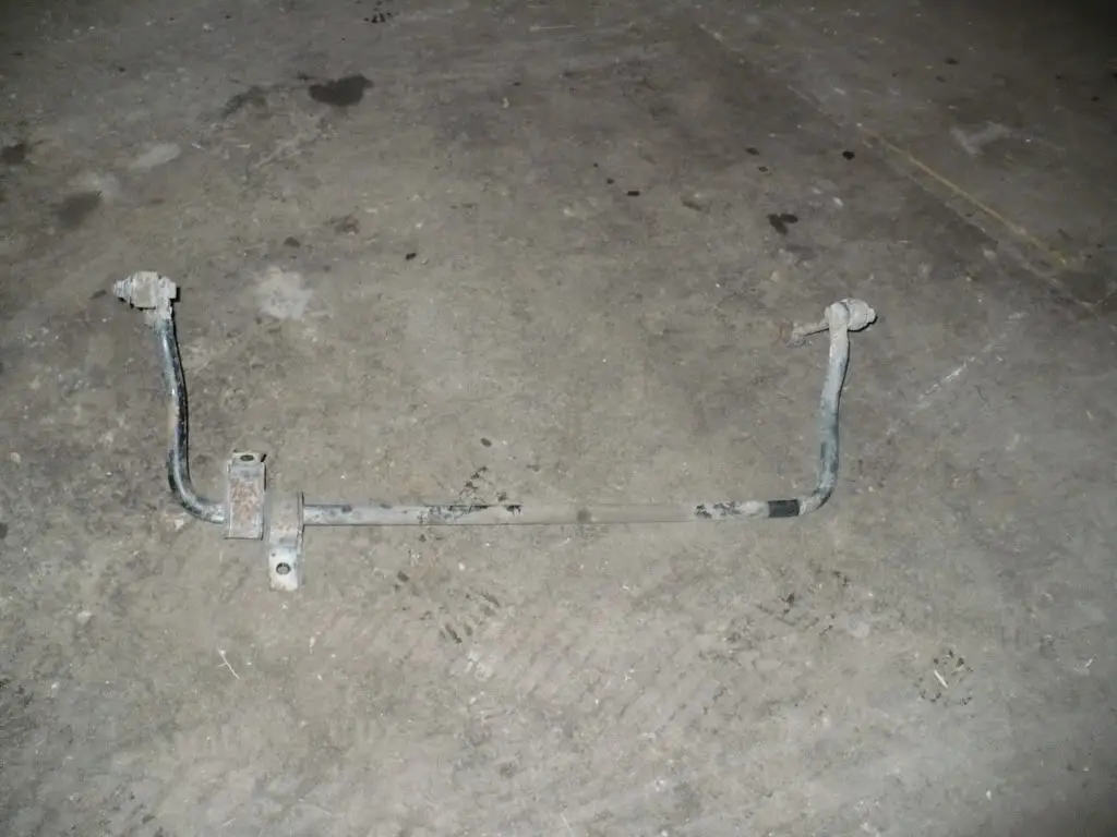

4. While we were under there we completely removed the sway bar for some more clearance. Went ahead and sanded and repainted it too, because it "freshened" up the look for not much money.
Lonely little sway bar...
Front end minus sway bar
