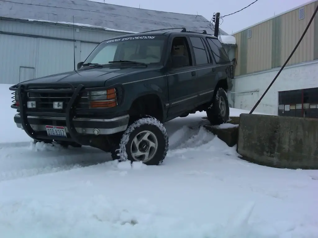

Update

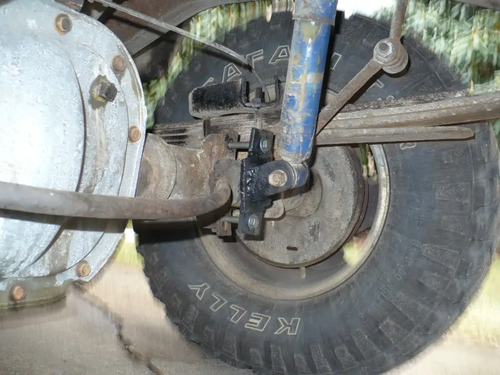

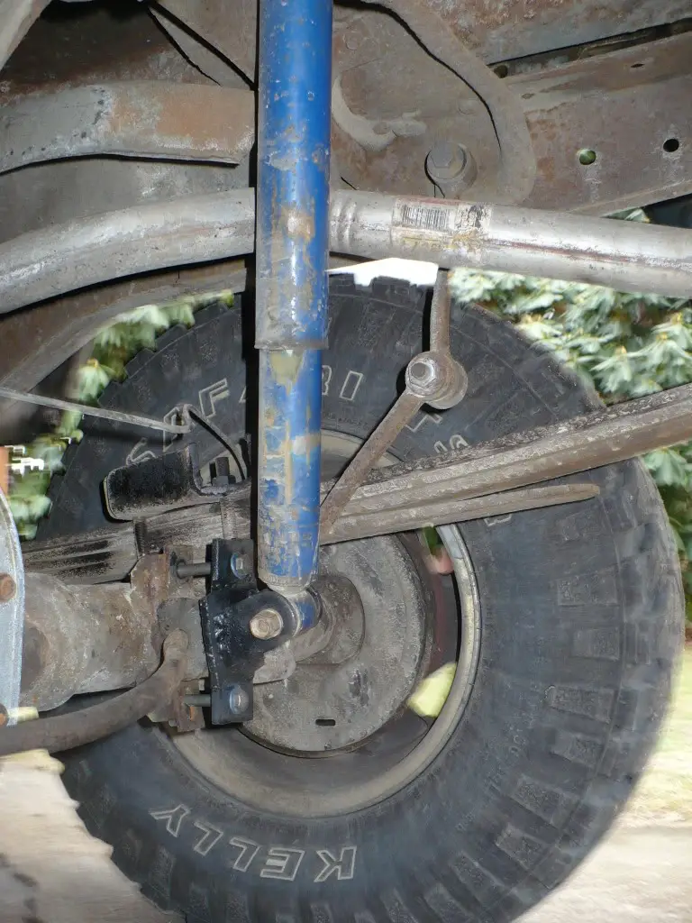

Ok, have some pics to throw up. Got the new shock mounts done today and it is absolutely unbelievable the difference between having no front sway bar and no rear shocks to having them. It still has play in the steering like a truck with 170,xxx on the clock will but it's night and day.
It got dark and I didn't get a chance to get a pic of the new mounts but essentially I have a bracket that mounts on the back side of the sway bar mount on the axle. It's great having a dad who will help; I gave him the idea for the mount and he went to town cutting and welding. It works great.

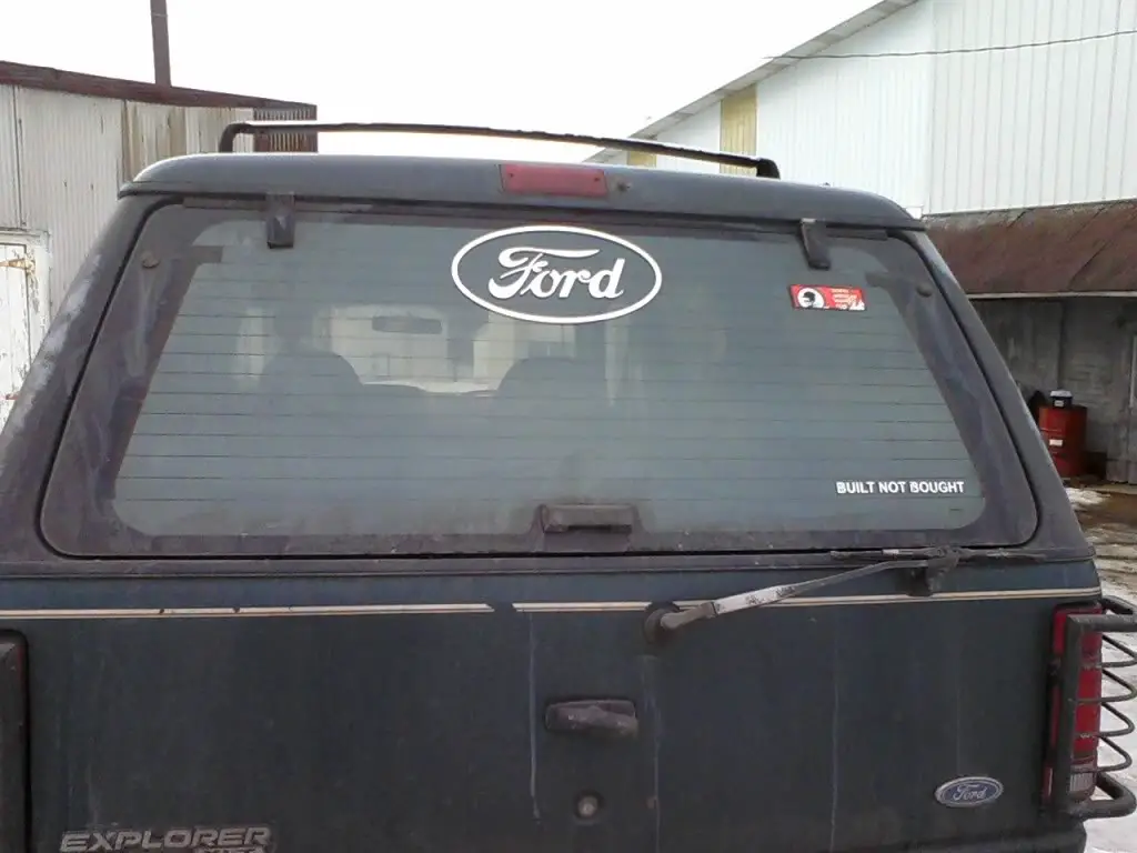

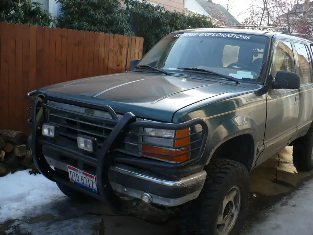

Ok, so some pics :)
(On the decals, sorry if Blee ever reads this - I showed my buddy the link to your decals & he made some for me at his t-shirt shop. I couldn't pass up free so I put them on and they look pretty banging, I think)

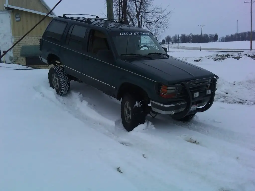

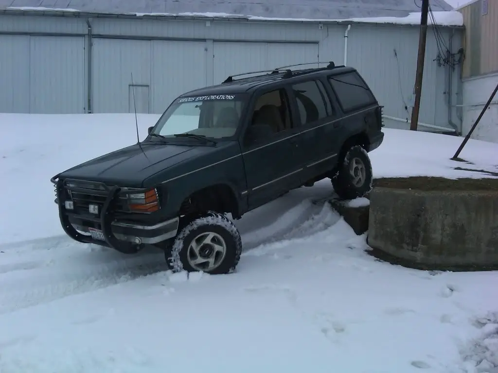

Lifted!

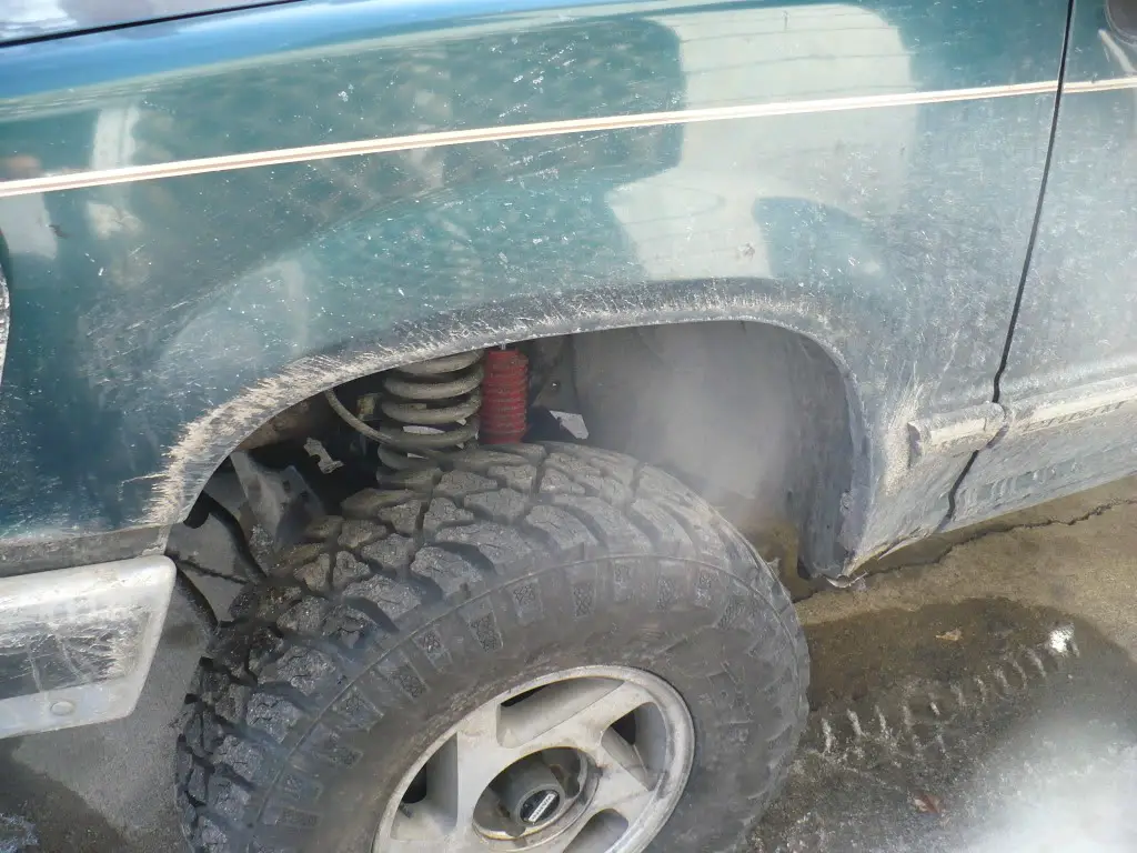

This is a nice picture of the cancer on it that I have to deal with. I want to get a pic of all my new body panels to show you what I have in store, lol.
The front w/decal...
The back w/decals...
Here's a height reference. My dad is 5' 8".
Another front perspective
Here's the front clearance w/31s. Tonight dad and I actually made a neat hanger for the extended brake line to keep the line out of the way of the tire at full lock. I didn't get a chance to get a pic of that
Another front shot cause I'm cool like that

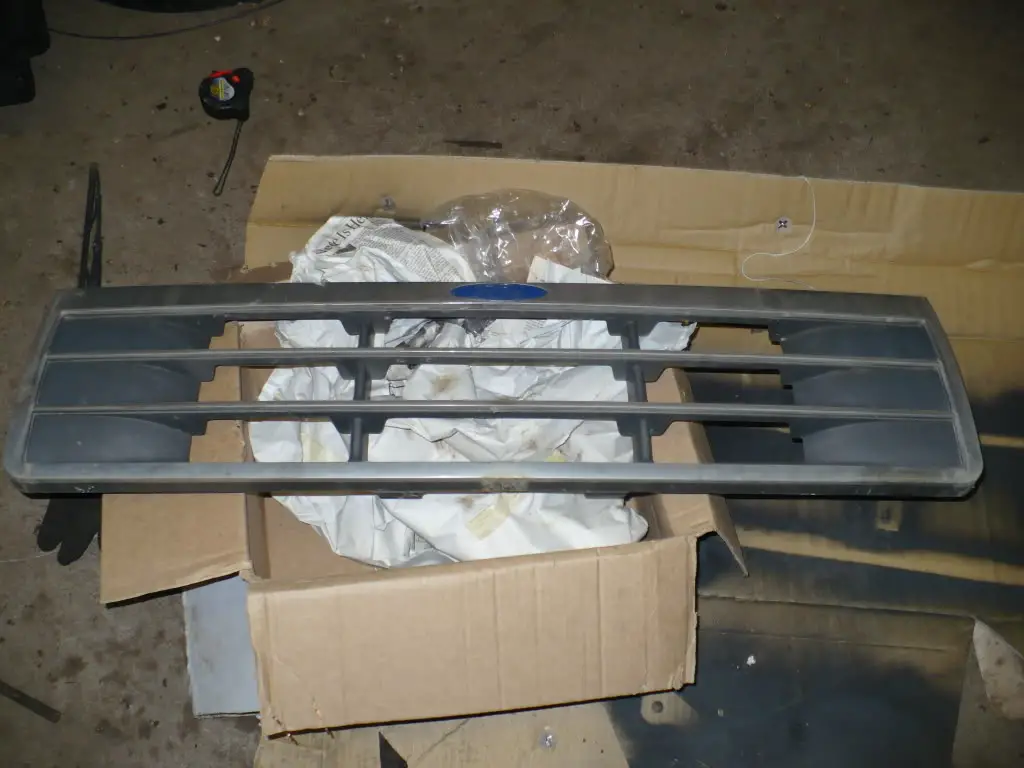

I'll call this the 'before shot' since I have a new grill sitting in the shop & I've got a new front bumper coming in the immediate future
Ok, there's lots to do & lots more to show but that's a good update for now :D

Ask and ye shall receive!
It's nothing super exciting but I thought it was a pretty cool idea. It's just attached through the top of the inner fender with a zip tie
The crowning achievement (my humble opinion :))
Just torched off the old shock mounts from the leaf spring plates and welded them to a piece of flat stock. Got longer bolts and new barrel clips and voila!
Here's another angle:
This one shows better the old mount that we chopped off
And one more for good measure:
Finally, yes I know I need to reroute my hard brake lines. They're ok for now though I think. I'm going to do that next month when I redo the rear brakes.

need some spacers between the new shock mount and the sway bar mount. so you can really pull that mount up tight.
Good eye. :) I'm actually heading to the hardware this weekend for that. We bought some pipe and the diameter was right but the walls were so thin we just scrapped them all together. I used grade 8 bolts at least!

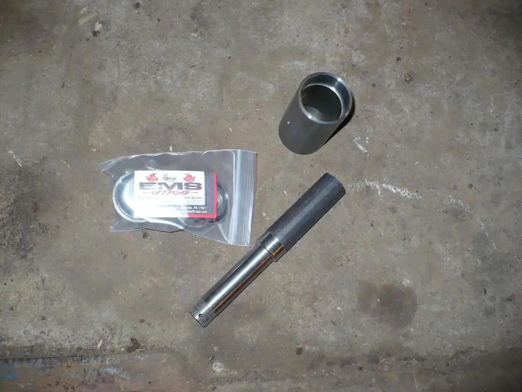

Also ordered a custom front bumper from a local fab shop, and the tire spindle kit from EMS Offroad to build the tire carrier for the custom rear bumper I'm going to be building. Got a big piece of metal from a guy at work and he volunteered his time to help me make it.

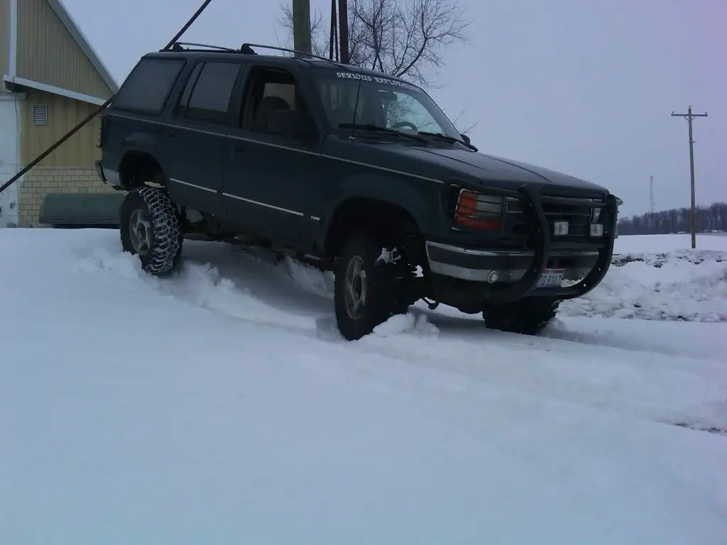

Doing some posin'

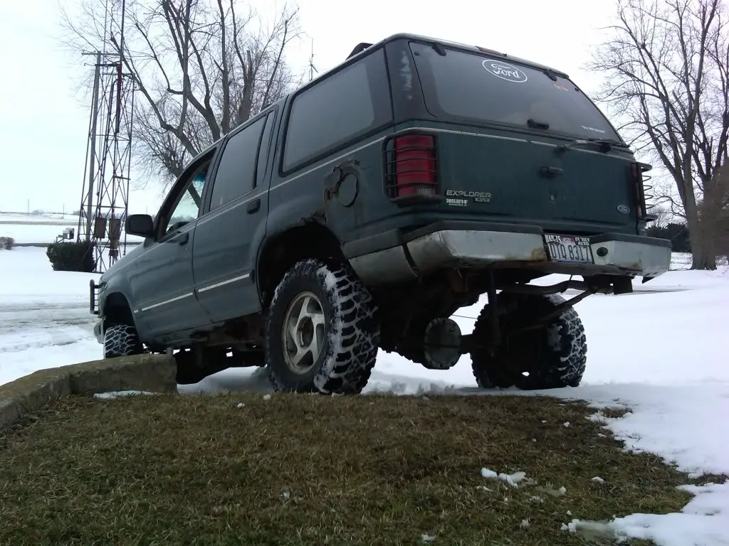

Figured I might as well throw these up. Tested a little flex at my buddy's farm. Gonna do sway bar discos for the back & UPS brought me my extended sway bar links for the front so hopefully next time I take some of these there is a visible difference in flex.
For fun I'm going to get a pic of all the parts I have yet put on. It will give a nice idea of what's to come. Going to try to document some of the cancer too, to show what I'm up against. They don't call it a project for nothing, lol.
Anyway, without any further ado:
Probably my favorite shot
Showing a little better flex here, I think
Other side
And another view, lol

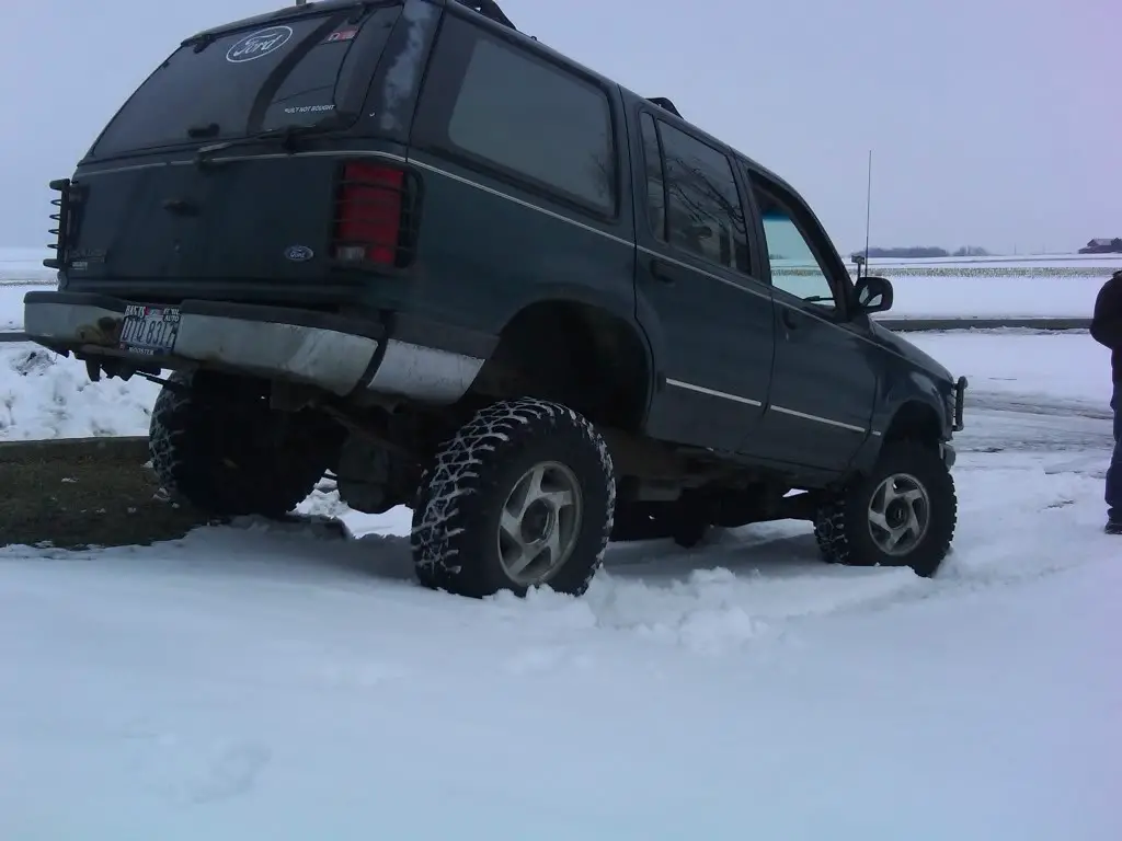

Rear clearance
Another good rear shot. And some terrible, terrible cancer. Moment of silence please. :( Dang Ohio road salt.
Little bit of a bumper gap there whilst flexed. Gonna work on that when I put on the new bumper lol.
I believe, I believe, I believe...that's all folks!

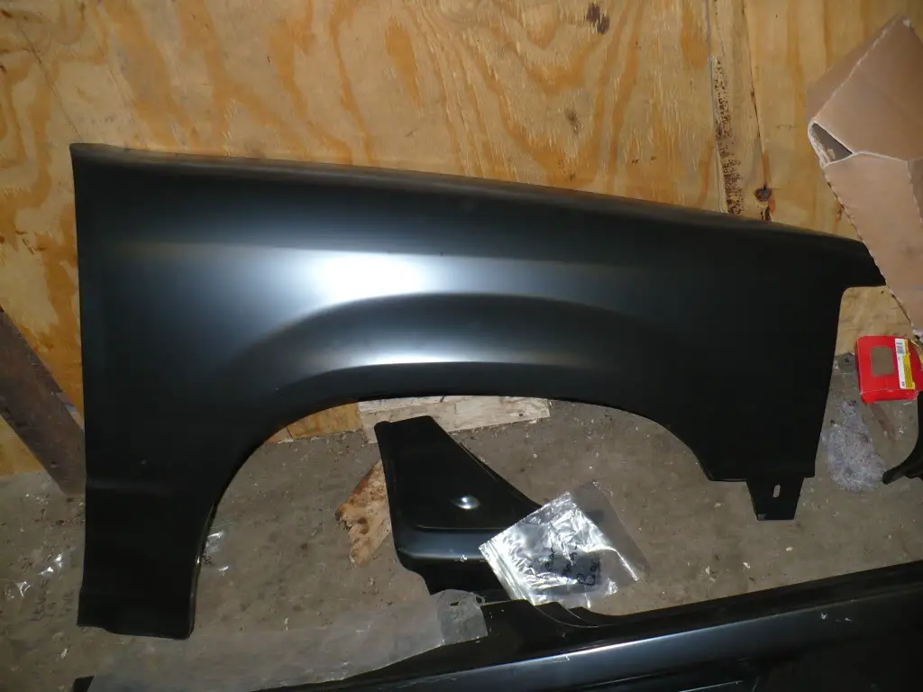

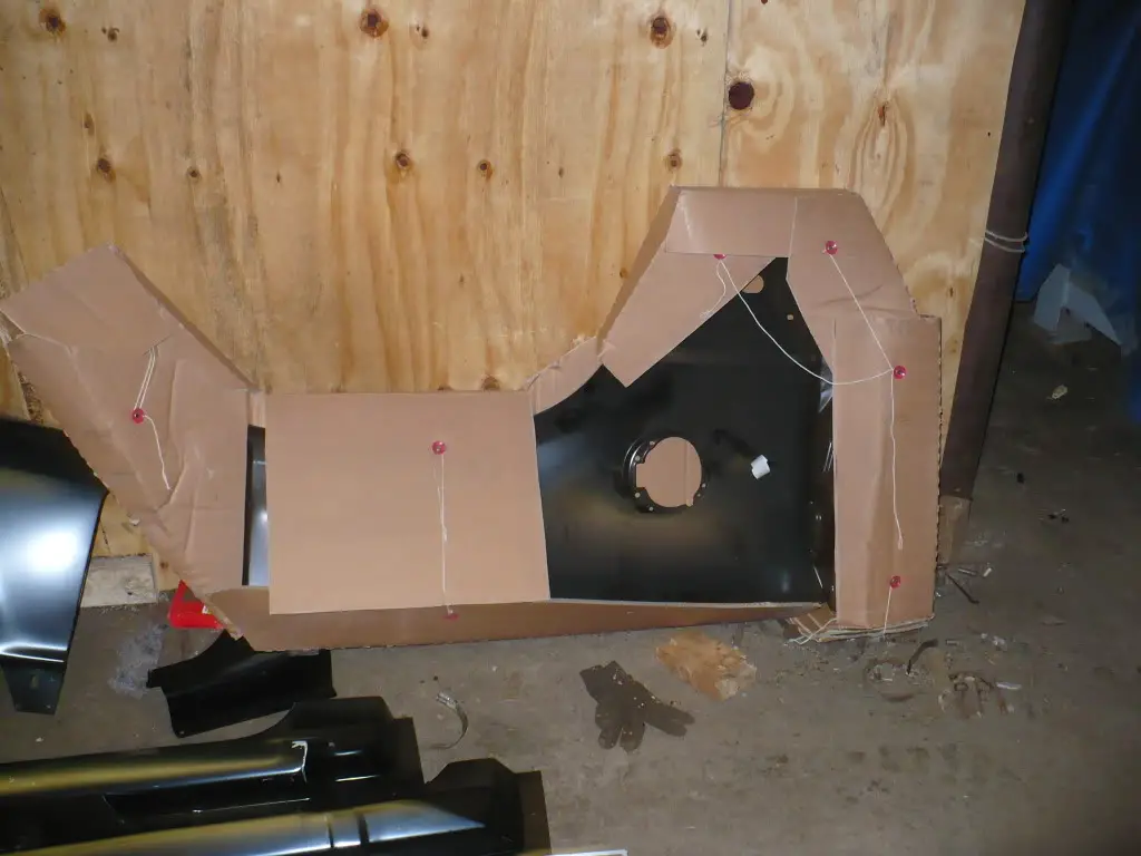

Well, here's what I'm going to do for rust:
That one is especially important. The rust around the gas tank fill is unbelievable. And every one I've seen in the junkyard around here has literally the exact same problem :(. It's actually rusted so bad behind the panel (what I guess you'd call the "inner" body panel) that we're going to have to fab up a big ol patch sheet out of blank sheet metal.
And this one VVVV isn't a body panel but still was worth buying to make it look just a little better:

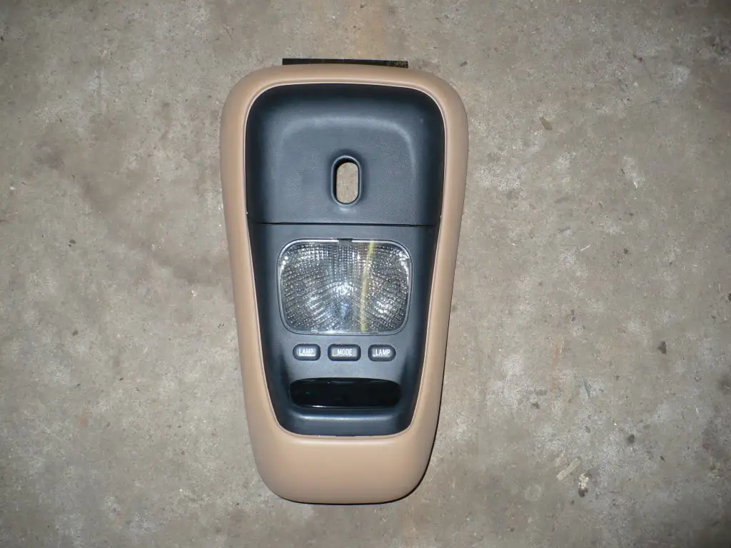

And here is a pic of the console I'm going to use to wire the moonroof in. I didn't get a pic of the wire harness (cause I still have to pull it from another truck lol) or the moonroof (cause it's still sitting in my buddy's garage):

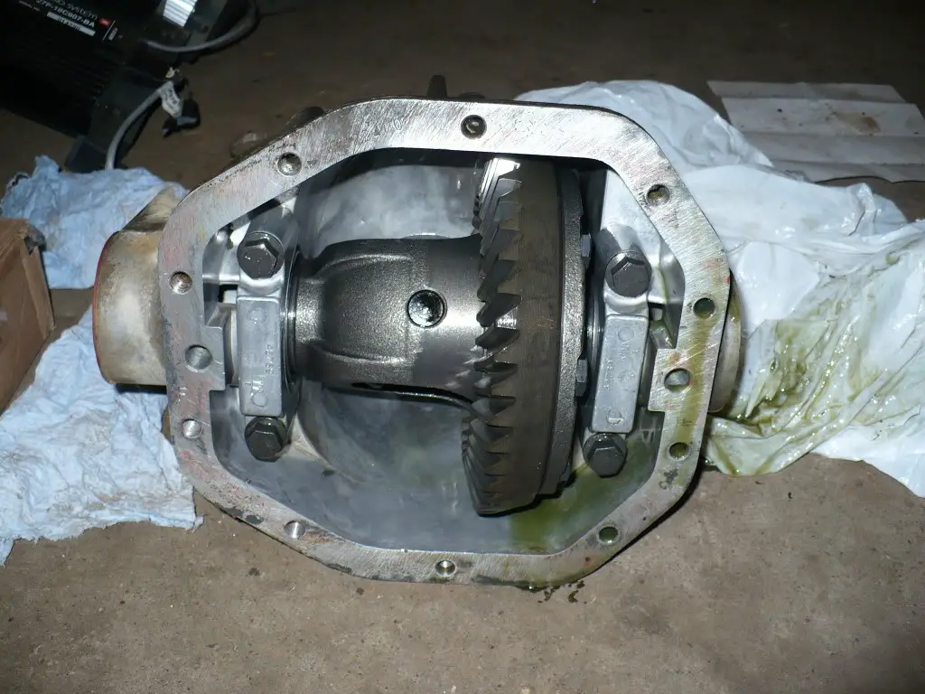

And here's what I'm most excited about...4.10 front diff!

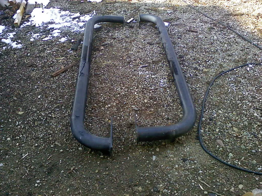

Yes, spending more money.
Heaven forbid I actually put any parts on lately :rolleyes:
I found some nerf bars on Craigslist for $100. I offered him $65 and he came back with $75. Yes, I know to some degree they affect ground clearance but my axles are still the lowest point and to be 100% honest this thing is a little chore to get in and out of without them. I know, good problem to have, but still.
Went down to get these tonight:
Side note, turns out the bottom half of my county...still really, really flooded. Took me 2 hours to get back home :(. My antiquated GPS was absolutely worthless so I thought I would tackle it on my own. The guy lived on a 2 lane highway...which was completely shut down cause there was standing water on it. I got there alright but by the time I left it was dark. A 45 minute trip home took 2 hours. At one point I took a side road till it deadended and the road I could turn on was closed to the right and the left. I tried one way and made it about 3/10 of a mile and stared out across a lake. I don't want to come across as a pu$$y but I was getting scared. There was literally no one around...I had to back up the whole way and get back to the main road and every freaking side road I took was flooded at some point. As well as the highway. Screw this rain.

Lol. I'll get right on that...You'll pay me for the $60 to ship them too, right? ;)
I don't know what they were for but the tube size is gigantic (that's what she said). They'll work quite nicely I think. I just need to fab up some brackets for them.
