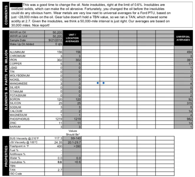

For anyone interested: I had my PTU gear oil analyzed at Blackstone. Results are in. Unit had 50,200 miles on it at time of removal.

Wow, that's very interesting. Low wear metals but the insolubles suggest the oil is getting subjected to a lot of heat cycling? I found this screen shot from a Ford demo on YouTube showing the temp delta for the PTU with and without the cooling. It doesn't seem like the coolant is adequate to reduce the temperatures... but I always wondered about switching to a Reische 170F t-stat on my Fusion Sport, which would send colder coolant into the PTU and trans (I know, different car, but the Explorer Sport gets coolant into the PTU). With the stock t-stat, the ECT is kept around 200-203F. With the 170F t-stat, it's usually around 180F-185F, so a delta of 20F from stock. That should be worth something right?

My report said @ 60k miles, the fluid was more representative of a 30k mile fluid.

I went back and forth with Blackstone--they noted that the pre-2017 PTUs they've analyzed fluid from were often MUCH worse than my sample.
I asked for permission to share this, and they approved:
Yes indeed, most pre-2017 Ford PTU samples we saw looked really rough -- in the worst cases we'd fine metals as high as ~9,000 ppm. And we did some research and a few sources noted that even minimal overheating would cause a lot of problems.
It does appear that things got better in 2017, probably due to the design change. But pre-or-post 2017, get those PTU fluids changed!!!!!!!
