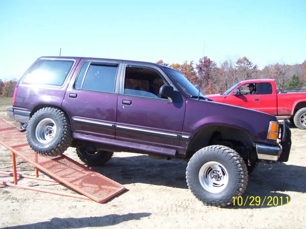

1994 Purple Explorer XLT 4wd

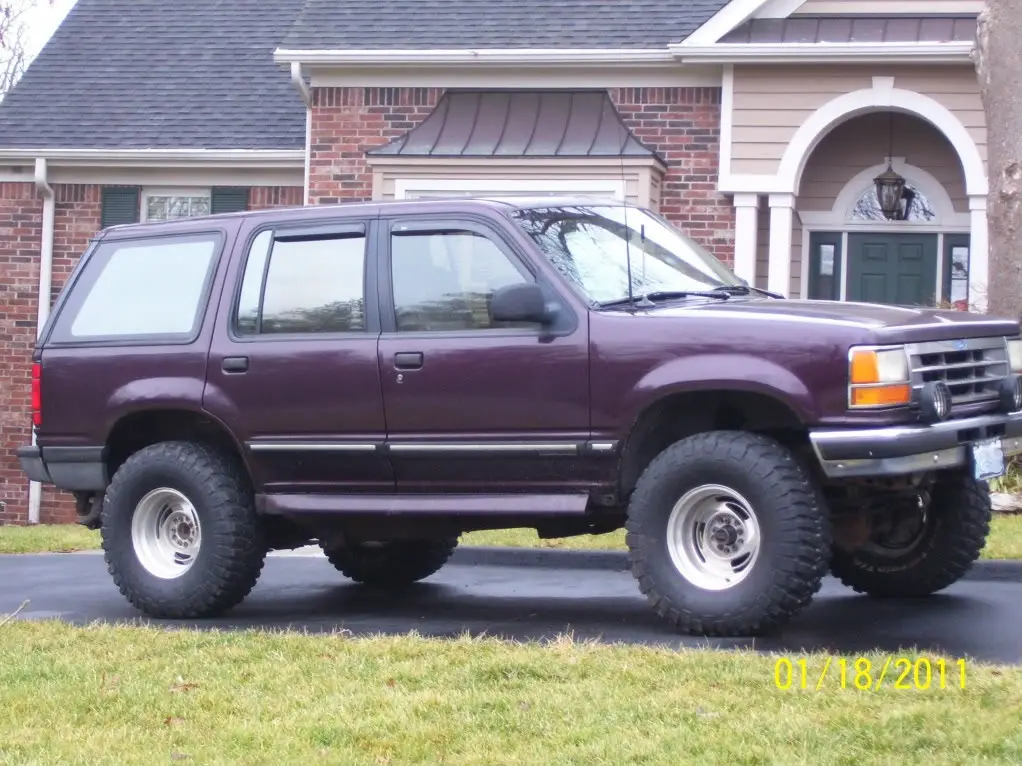

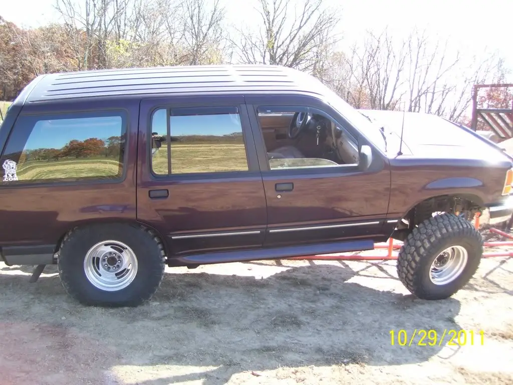

I decided to have a registry for my "Other" rig so I can post things done and have a reference for it.
Pretty much stock drive train.
4.0 OHV-A4ld-1354e.
D35 front 4:56 Yukon gears, Aussie Locker.
2nd gen disc 8.8 rear 4:56 gears, Spartan Locker.

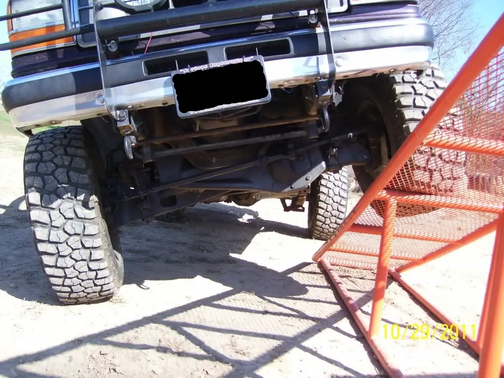

Front C-Clip eliminator Mod.
Slight lift with 2" Skyjacker coils & rear F-150 hybrid leaf packs.
3" PA body lift
Helpful thread with pics for the front body mounts
Pics of front body lift mounts
Swapped to manual hubs.
Double U-joint XJ steering shaft.
33" x 12.5" x 15" Cooper Discoverer ATX3, mounted on 15"x10" AR Outlaw1 alum wheels - full size matching spare.
Shocks:
Front Rancho 9000xl
Rear Rancho 9000xl
Duff Stabilizer shock.
Sway bar quick disconnects front & rear.
Custom tube sliders w/kickouts

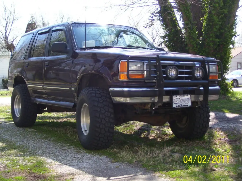

22" LED light bar.
18w amber fog Led pods.
55w rock lights--2 front--1 rear over diff.
8 LED pods for rocker lights.
Full brush guard.
2.5" Fender Flares.
TTB Diff guard & Skid plate.
Custom roof rack with 48" Extreme Hi-Lift jack.
Flipped Tow hitch & front hooks for tow points.

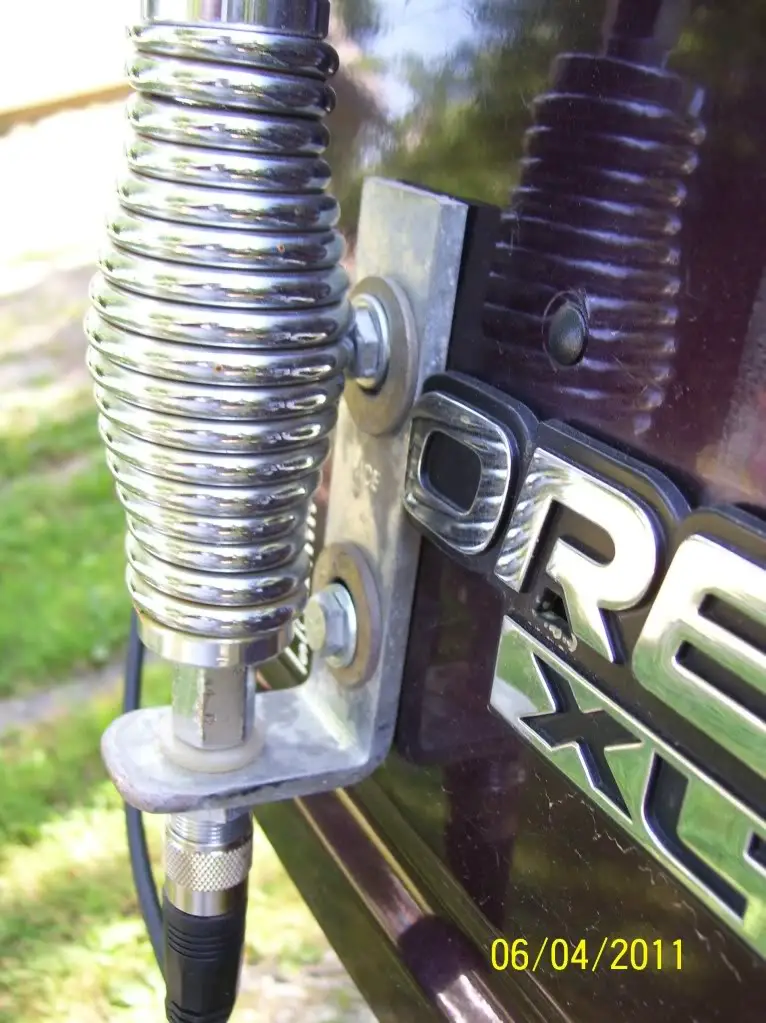

Cobra19 CB & rear hatch mounted firestick antenna.
Rear view HD camera.
JVC DVD/CD/MP3 Head unit with 7" HD Monitor.
Sony 6.5" front speakers.
Rockford Fosgate 5.25" component rear speakers.
8" JL Audio sub in 2001 enclosure with 500w amp mounted on enclosure.
Custom made center console with CB/Rear view color monitor/2-12v outlets/ in-out temp display. D cell Maglite mounted on cargo panel. Truck bed liner on cargo floor.
Custom Cargo storage box with topside spare tire mount.

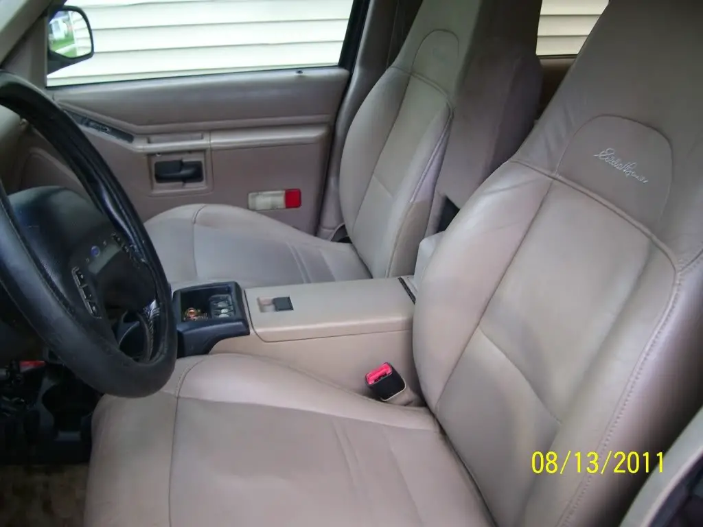

'99 Eddie Bauer Front Leather buckets.
'94 Limited Rear leather split bench.
