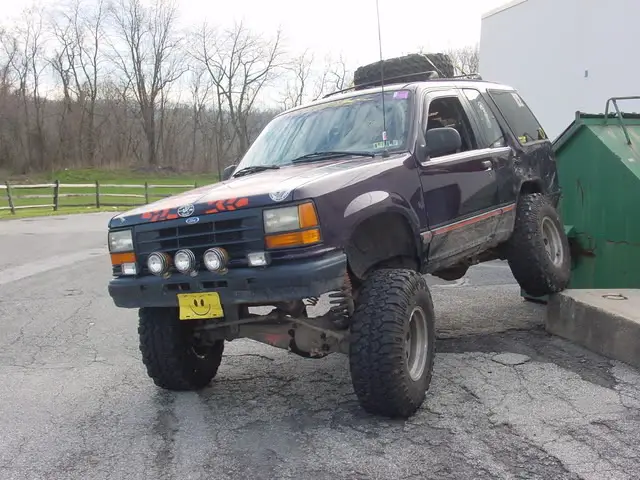

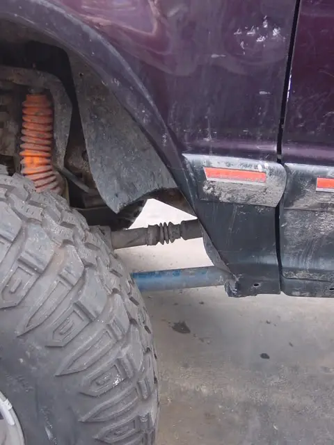

Here is what she looked like when I got her back on Apr 2 05.
Loaded 5 speed
5.5 Superlift front, Superlift SOA kit rear.
Mini Spool in the 8.8
15x8 rock crawlers
34x10.50x15 LTB's
Took 8 hours on Sunday for the front. 5 Hours Tuesday night for the rear and mini spool, 4 hours on Wednesday night to do the shocks, brake lines, manual hubs and "J" hooks.
Thanks to 2 friends from other sites for the help. Without them I would have still been out there.
EDIT: Getting 513 gears and a Detroit locker for the front next week. :exporange
Then extended arms and BBP tubing!
