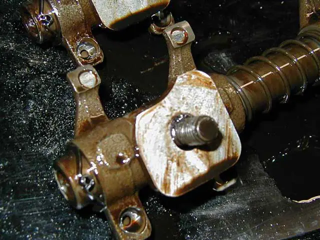

The rocker arms and rocker arm assemblies Ford sells are a revised part, and they are now made of harder metal than the originals. I'm not sure if all the aftermarket parts all use harder metal as well, but they should at least be better than the originals. There's a chance the rocker arms were just "replaced" with used ones from a lower mileage engine, so the same problem might be there, just delayed.
