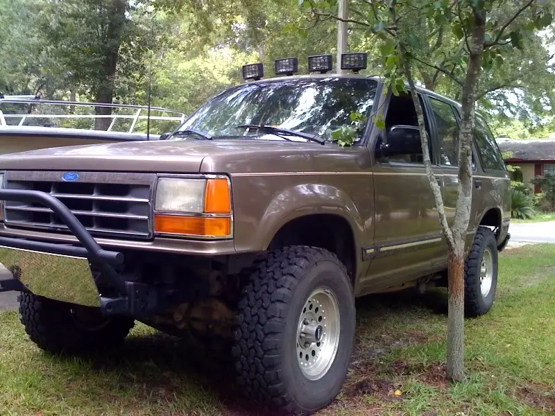

haha sorry about the wait you guys i was at camp danial boone for the last week. took pictures last night and uploading them today. yeah there are 10 body bolts and i took both my sway bars off before the lift and i have never really felt any pulling or rolling issues. i can say though that right after the lift the initial drive was a little freaky as my weight distribution was raised 3 inches it was scary going around the first turn.
alright you guys here they are.
thanks man, thats with me running 31's and just the 3 inch lift
