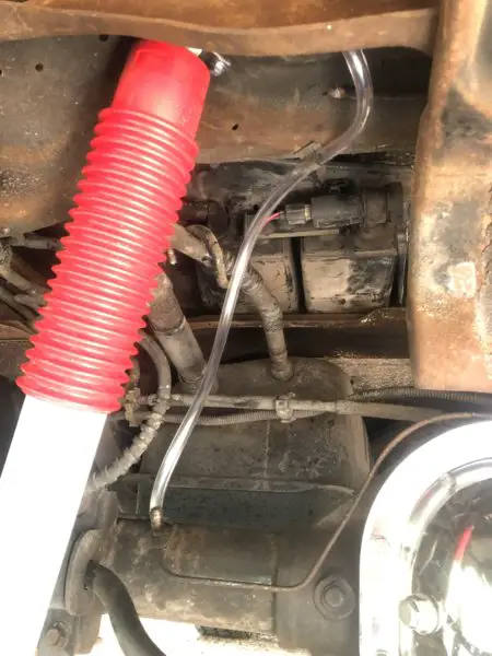

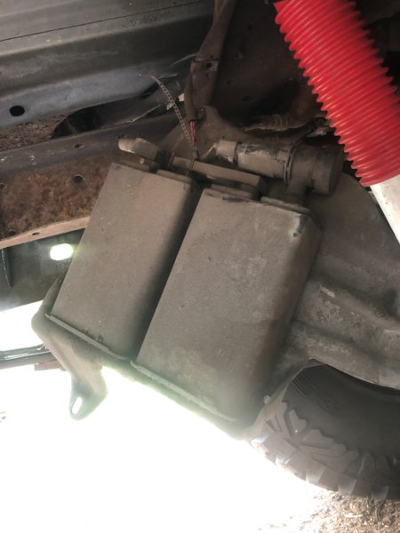

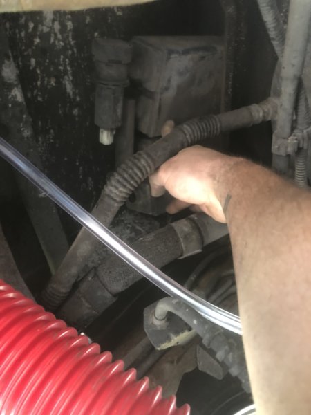

So I started looking at what I need to remove to make this tub, and I don’t know what this is! (Pic) I’m probably gonna feel dumb when someone tells me but yeah, what it’s it, can I get rid of it or how do I relocate it?
evap control for emissions
So can I just bypass that and get rid of it? All it does if filter gas fumes right? I guess I don’t want a cel so maybe I’ll see if I can relocate it

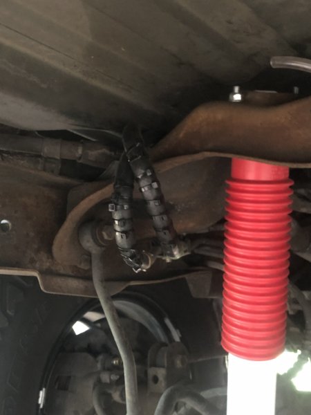

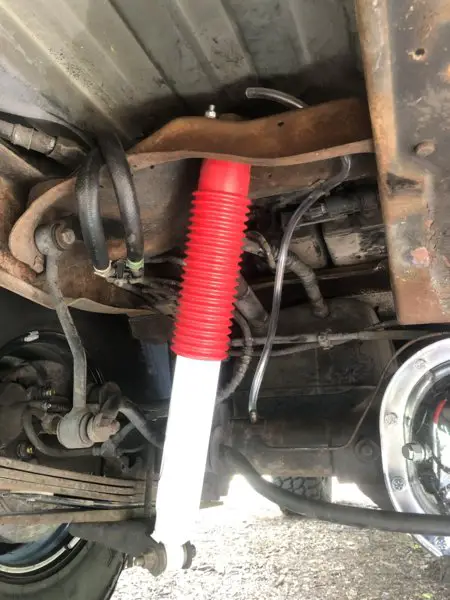

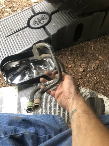

I found a spot to relocate it, I’ll have to cut the hard lines to make this work. Can I just use regular hose with hose clamps?
Well, I just went ahead a did it
Those hoses look a little crimped. That might have a specific orientation it’s supposed to be in.
They are, I took a pic before I added a bunch of zip ties (too cheap for that fancy wrap) they hold round just fine now. Ribbed for her pleasure! Lol

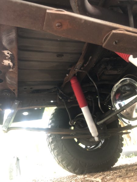

Anyway now I have room to drop a box roughly 25x14x11ish. Probably make it out of 1/8th and gusset it with some flat bar. Or something like that, I’ll fabricobble something
Zip tie hose stiffeners, and the open space for the tub.

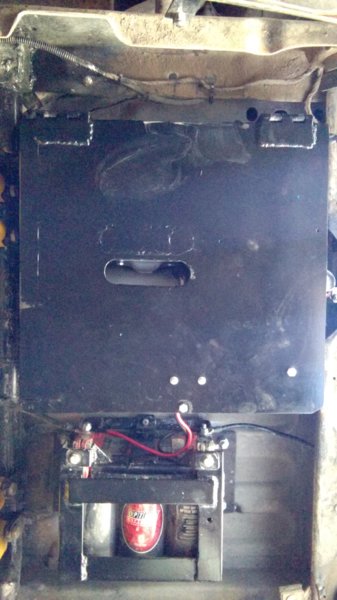

While you are under there, check the upper shock mounts for cracks in the cross member. Mine cracked nearly all the way through over a weekend. Here is a picture of my battery box. The large plate is covering a air compressor and tank. Its hinged on one side so I can fold it down for servicing. The battery box has been modified a little since this picture. It now has some heavy metal screening material covering the bottom and side openings. The box's side is removable while the box is in place, so I can slide a battery into the box while its mounted.
