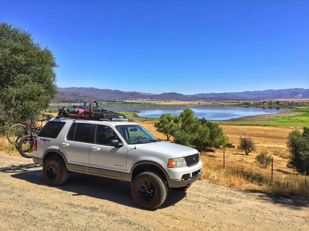

Hey what's up man. I too am building my rig up for some overland trips. As of right now I'm running 2 stock cross bars with a Rola basket with extension and use the provided 4 stock mounts. So far the most I've loaded up top is a tent cot, another 4 man tent, 4 folding chairs, 5ft folding table, hi lift jack and a kids bike up there. Estimating around 160-170lbs probably a bit more. Everything held up fine as long as the weight is evenly distributed on the rack. I do have another stock crossbar I'm planning on throwing on for more support. I just ordered an ARB awning to mount on the side so that'll be another 35+ lbs added.
Here's a pic all loaded up
Nice, I was looking at the Rola. How long does it end up being with the extension? Looks like it actually comes out above the sunroof, which I actually don't really mind.

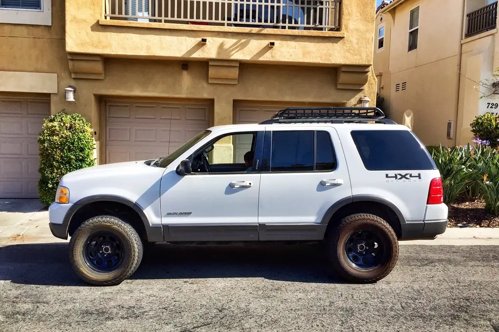

With the extension the rack is almost 6ft long. Here's a pic without the extension
And with the extension
It does stick out about another 6-8" from the front of the factory rail.

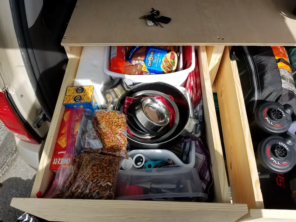

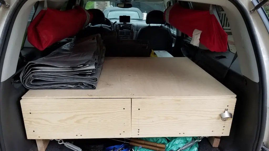

Here's some interior shots. I still haven't finished the drawers. Still gotta get sliders and pull the whole thing out to paint. The cooler will eventually be replaced with an Indel fridge but for now the cooler does ok for weekend trips.
Rotopax is expensive compared to what I have now which is a POS leaky Briggs and Stratton 5gallon can. But I guess you get what you pay for and dealing with gas I'll pay a bit more. Plus it'll mount vertical and horizontally to fit many applications.
I wish I can do a rear trunk drawer system like yours. It's looking great btw! But I need the third row seats for the kids.. hence the reason why I'm throwing mostly everything up top. What's your setup for a kitchen? I'm using a Coleman 2 burner propane stove and a cooler similar to yours. I can't justify a fridge right now but would love one. Cooler works great since I'm only doing 2-3 day trips.
