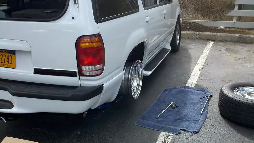

In case anyone looks to do something like this in the future, 15x10's on a lowered mounty/expo will fit. I did have to do some massaging to get them right which just included running a spacer. The tire would have rubbed on the rear stabilizer bar.

Few more cam phone pics from this Saturday's fitting.

I ordered the remaining wheels, 1 more 15x10 and 2 15x7's for the front. I'll post some more pics next weekend when I finish up for those that may be interested.

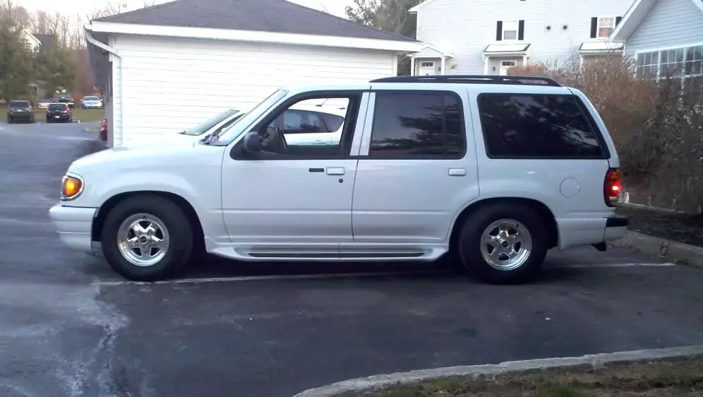

Finished up mounting the tires and sizing on the truck. All said and done, I'm fairly happy with the outcome. Here's a couple pictures I took with my phone as soon as they were all mounted.

Nice setup. I would've gone with raised white letters especially wit those rims and an all white EX. JMO. Nice job so far though!!!

Looks good.

Very good. How is the clearance at the LR parking brake cable? Is that a V8, with those you can R&R the cable to place it on the inside of the V8 anti-hop bar there.
Be careful for a while until you can check clearances at the rear inner fenders. The whole rear end with tires moves side to side a lot in hard turns. I had slight rubbing of my first tires, 255/60/17's on OEM 17x8 wheels(32mm offset). Spacers helped a lot with that.
