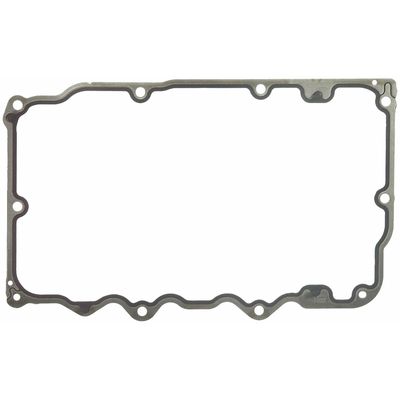

What engine gasket sealer did you use? Im replacing the stock gasket because it's leaking. So a fel-pro gasket isn't good for this application?

I found the tube in the garage. It is Permatex 2 form a gasket sealant. It's what I've used on engine gaskets (water pumps, oil pumps, etc.) for the past 40 years.
This Felpro gasket (PN OS30687R) is permadry molded rubber according to the description so it may be adequate.
