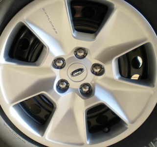

Perhaps you should check with the dealer's parts department. I use the OEM 17" steel wheel and wheel cover on my 2011 Limited with no problems except one. The lugnuts used for the 20" wheels will not hold the 17" wheel cover on. The ones needed for that require a sort of built in flange since it is the wheel nuts that hold the cover on. The 20 wheel nuts cost me $251.40 with a discount.
I wouldn't be surprised if you have to go with the 18" wheel and tire. An 18" tire would still be less expensive than a 20" and you would have more manufacturers to chose from as well.
Peter

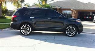

I'd love to see the edge sport wheels on the explorer. I like them better than the explorer sport wheels.
here you go Harley........
