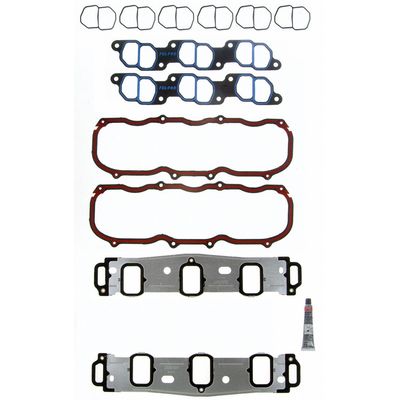

Why do they give you two fuel rail gaskets? I replaced the upper intake manifold gaskets a while ago and that set came with two fuel rail gaskets (I didn't change the fuel rail gasket though). The complete intake manifold set I bought also came with two fuel rail gaskets. Are you supposed to use both in the sandwich between the fuel rail and the lower intake manifold? Or is it just extra--they give you 6 upper intake manifold O-ring gaskets too and it only requires 3.
Or based on the Ford diagram, did they use two fuel rail gaskets from 1990-1994 and not on 1995+? The diagram shows a gasket between the fuel rail and the upper intake, but it says "1990/94"

It looks to me like the new fuel rail manifold gaskets won't work. The original gasket was a sandwich of a paper gasket, a 1/8" plastic shim, and another paper gasket.
The new Fel-Pro gasket kit I bought (and every single other gasket kit I can find on the internet) is just a paper gasket.
I tried reassembling my fuel rail with just the new paper gasket, and it wouldn't work. There is a 1/8" gap between the fuel rail and the lower intake manifold. It seems that the shim is required on this engine. I guess I'll just reassemble using the old gasket, but it's really disappointing that there's no workable gaskets or even any info out there on this issue.
