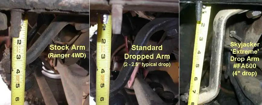

So I found a pair of 4-6 TTB drop brackets and 4-6inch front springs. All I need now is the RA drop brackets and possibly a drop pitman arm?

You will need a drop pitman arm, preferably one of the 4 inch drop variety to go with a 6" lift.
