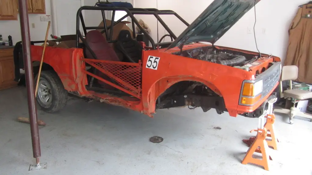

As always plans change for me and I decided that I want to build a more hardcore trail rig then any other I have had yet, but try to keep cost not terrible LOL. So gunna use my tuff truck chassis explorer sport. I wanted something to start with that body panels dont matter so this will be perfect and it has been allready extremly simplified I only want just basic things needed to run and monitor.
Current 4.0 5spd

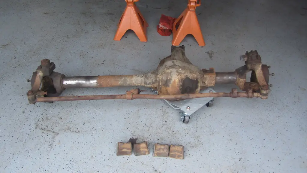

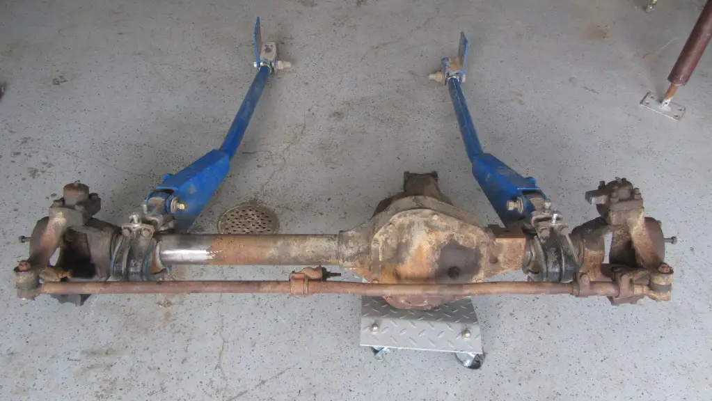

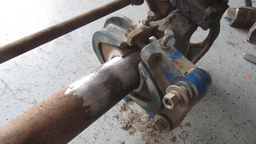

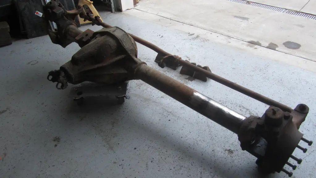

Here is the front axle, 79 Ford Dana 60, my buddy has had it sittn for a few years and I talked him out of it. Today I cut off the stock brackets, and loosely mocked up my weld on wedges and radius arms.

Taking up space in the garage, just trying to get it so I can roll it out and finish some other stuff that is more a priority

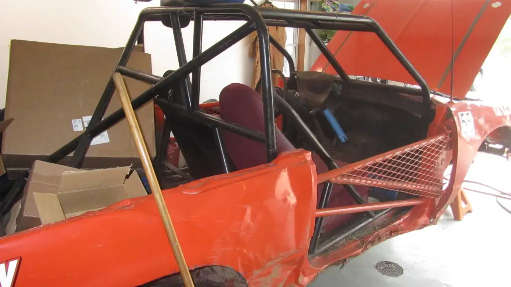

Dont make fun of the cage was made using up left over stuff, its not the prettiest but will do the job.

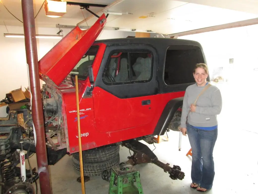

Also today just to stay busy I worked on explorer most of the morning and tonight I have been mocking up my old Dana 44 and 8.8 under my friends YJ, its gunna be kinda big LOL, he is going to remove the 2in body lift which will help a little.

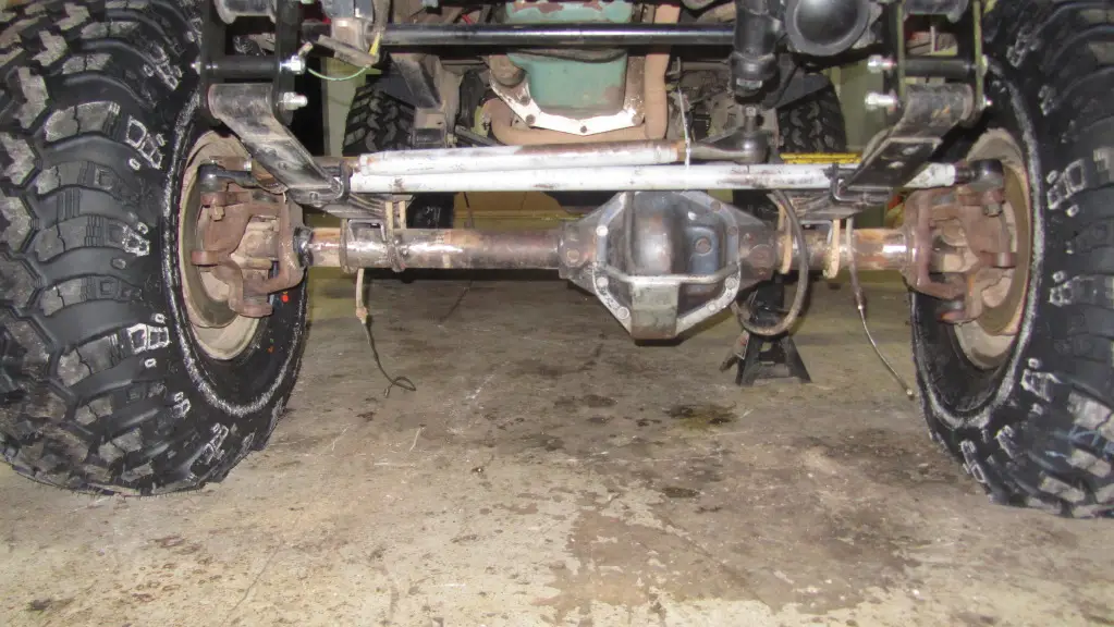

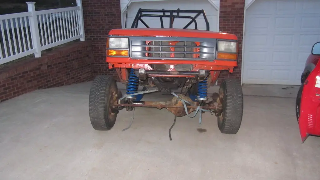

Front axle was roughly mounted over weekend, still need few things and a track bar and steering, I was able to roll it out of the garage. :)
Looks pretty good, I was thinking a 14bolt in the rear, but I think I can get a really good deal on Sterling 10.5 from 00 Superduty $100 bucks with brakes, and I have read about redrilling the hubs for 8x6.5 pattern and using E350 rotors. Lots of those will be in junkyards if you need to go find a shaft is what I'm thinking....
Hoping to get a chance to work on it some more this weekend.

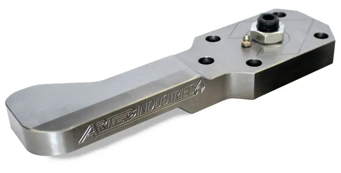

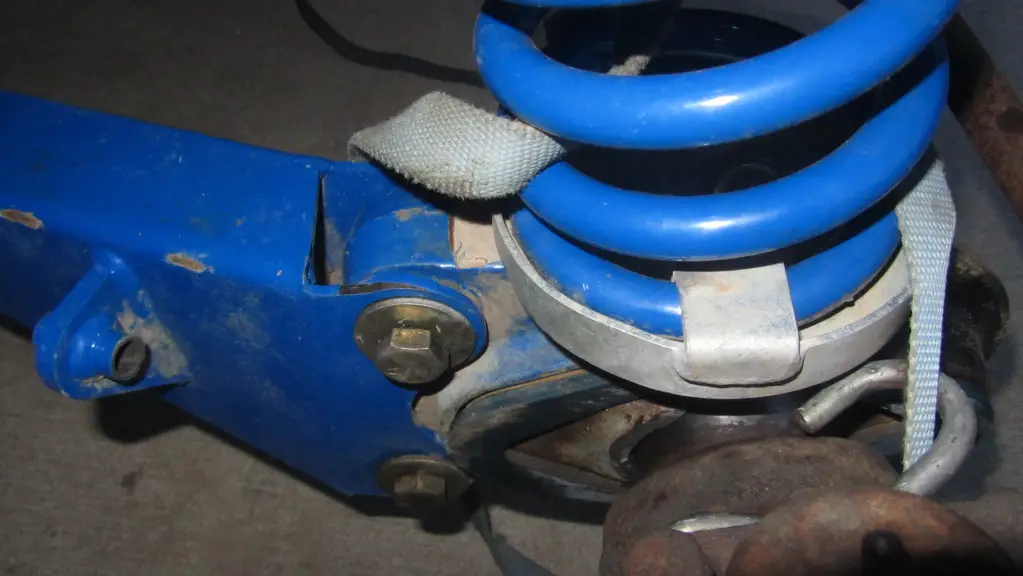

Just ordered this for pass side knuckle, so I can have a little easier time get my steering hooked up for moving this thing around. Will also get a ram assist down the road.
I really like on the Artec arm how you can drill the hole and tie into the knuckle steering for more support. I will wait to do this for a little while incase I get Reid knuckles.

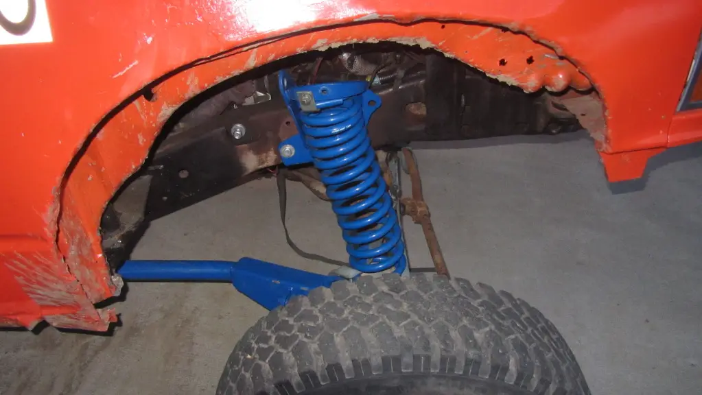

Thanks. I just need to get my Tecate 3 done, cause its taking up alot of garage storage and recoup some money selling it. Try to make some $$ on side jobs to fund this. The front looks pretty wild cause I pushed it forward quite a bit more than where normally sits. I'm using James Duff bucket towers and my 5.5 EB coils. Im redrilling lower coil mount holes on radius arms so coils sit at the correct angle. Well thats my plan.

Those Artec arms are nice (same ones I ended up going with), but as I think you know (but maybe wasn't clear to others from your post) if that arm is drilled to match the knuckle you currently have, you'd have to get a new arm in the event of a knuckle upgrade.

Yes, thats why I'm not drilling it for the stock knuckle :) Thanks for clarify for others. I mainly wanted it for that capability cause I do intend to change out as funds come. The regular support will be fine to start with.

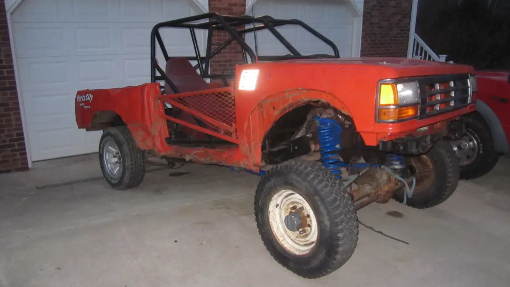

Some photos, keep in m ind lower coil mounting will be changed, just getting it to move around for other projects.

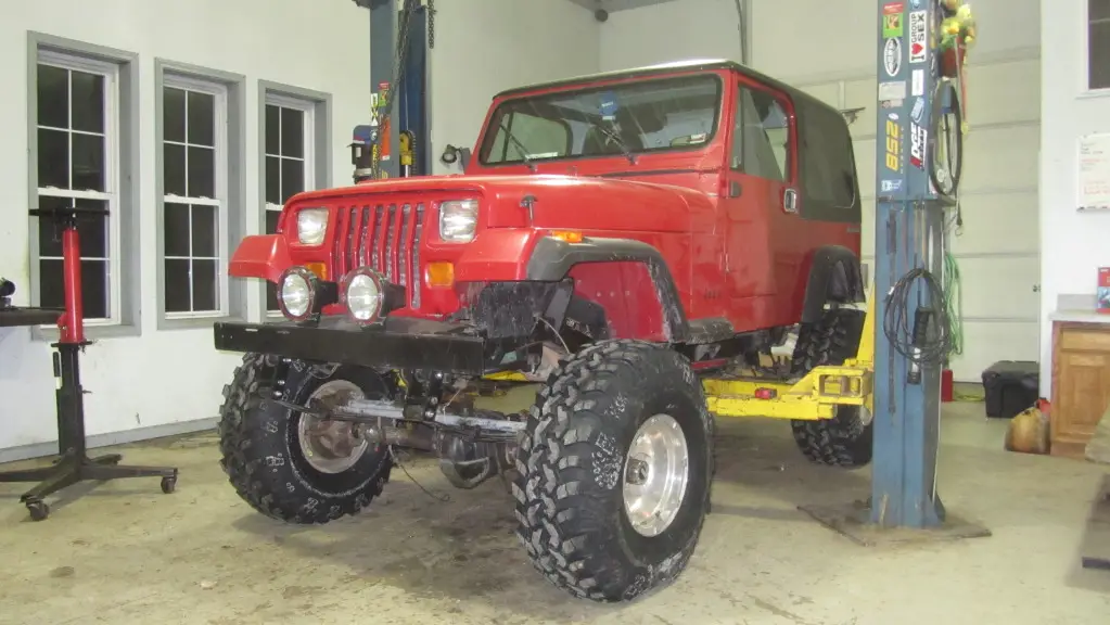

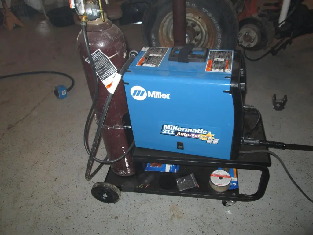

My newest toy, makes life alot better in the garage:
I'm running my 33s that came on my Jeep so this will be a fun trail truck.
Ordered matching 5 point Harness for passenger seat, but still using stock seat for now.
I also ordered a Shiftser for the electric shift T-case $59 cheap easy effective I hope.
Just playing
My project Jeep that is getting 5.3, 4link,3 link, 1 tons, which is taking all my time and about to be put on hold, while I enjoy the explorer all summer!! :)
