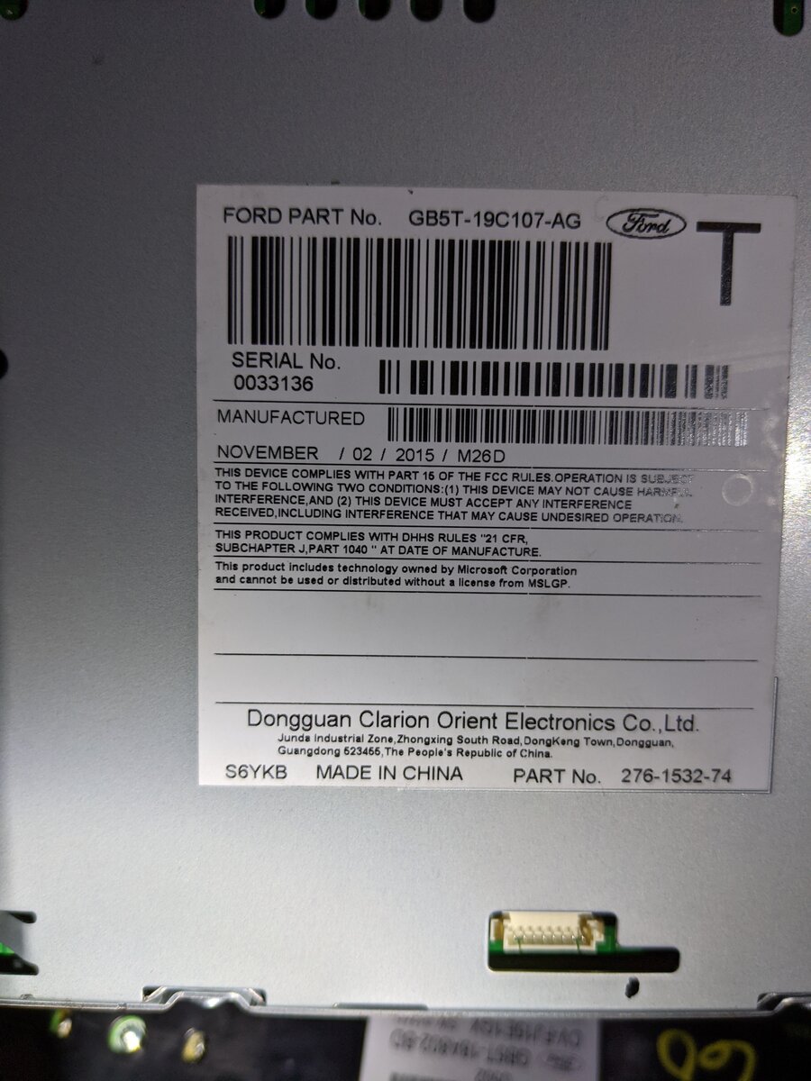

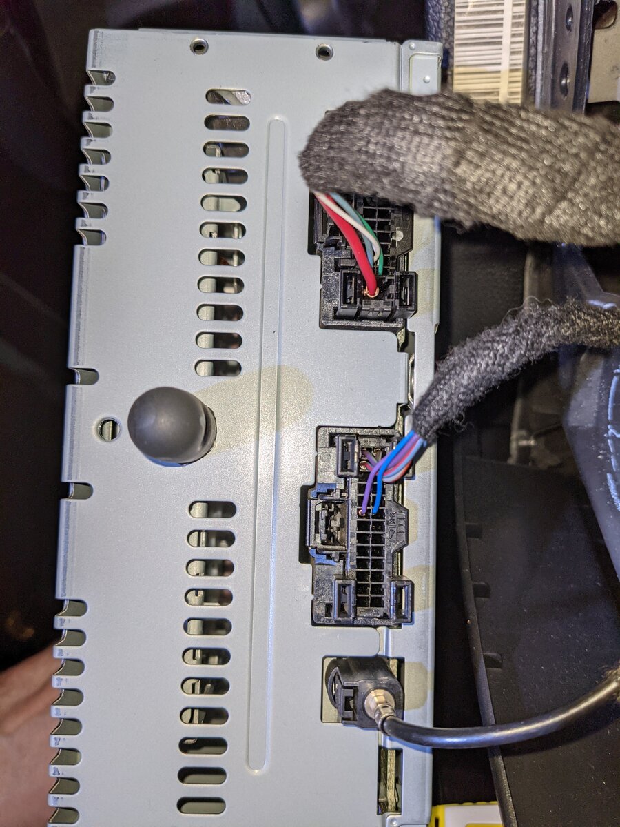

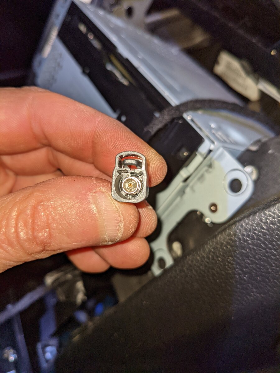

I pulled the headunit (ACM in Fordspeak) out and cleaned the antenna connection with Deoxit. FM reception is slightly better now but still no AM I really miss the aftermarket headunit I installed in my last vehicle that had HD radio. Doesn't seem like that is an option with the Explorer. I do have an old HD radio add-on receiver that I am thinking of installing but need to determine what Metra connector I need to convert the Ford-style connector to a standard old-school American antenna plug.
