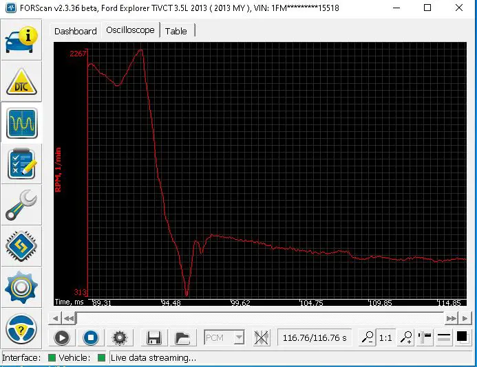

Would you mind to do one more in N, just pushing it to about 2k rpm, then let go the pedal and capture the rpm behavior while doing so. (while it goes down or beyond 600 rpms). The engine should be warm though. That would be cool.
And you are sure the first shoot you took, with the rpm going down to about 520 rpm was normal idle? No cold engine or anything - I am just wondering; would not expect such a drop.

OK, conditions: Vehicle in Neutral, fully warmed up, NO a/c (A/C only in the last as noted)
1) 2k rpms held, let go the accelerator and rpms dropped to about 300, stumble felt similar to fault first reported before replacing the TB.
2, 3 and 4) Subsequent drops from 2,000 rpms could not replicate 300 rpm drop/stumble, like PCM calibrated for it, smooth transition to 600 rpm can be felt.
In the next one rpms dropped to 447, no stumble felt, smooth operation. Seem like the problem presents or is felt below 400 rpms.
This last one I turned on the a/c, rpms dropped to 500ish on compressor start, smooth operation felt (no stumble of any kind felt). Then rpms went back up to 600ish.
Thank you very much for all those plots - now it is getting really interesting.
As can be seen from the plot I shared your and my engine behave quite similar - at least when not taking your first plot into account. Man, this looks strange ... and a drop down to 300 rpms is somewhat scary (at least if it happened to me). I am really wondering whether the TB replacement really addressed the root cause of your initial problem or it may reappear sooner or later.
The Plots 2, 3, and 4 on the other hand sort of suggest that there is not really a problem. Compared to mine, I just noted a slight (and occasional) difference in the amplitude (your's goes down to approx. 450 rpms, while I noticed "only" a drop to 470 on mine) and timescale (your's may take a second longer to stabilize than mine). But I would conclude for certain, that either none of us has any issue - or we both have the same one.

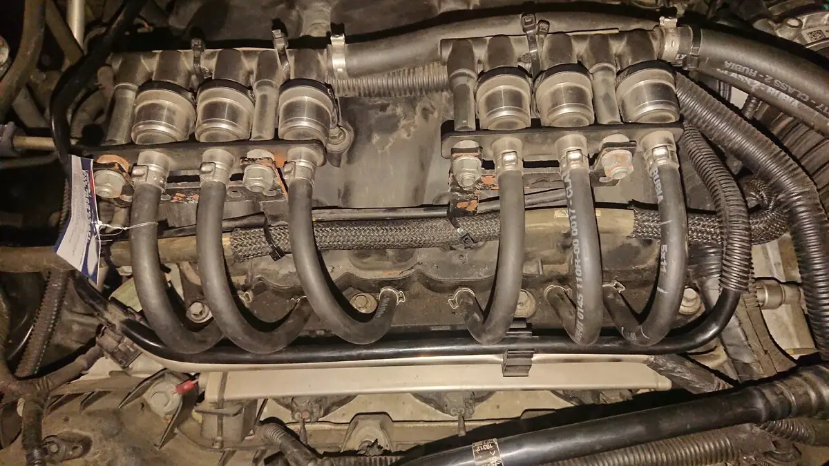

As for my LPG add-on: it is a Prins VSI 1 system installed in late 2011. The system is very sophisticated. It has still the Japanese Keihin injectors as full metal version and this late version of VSI 1 has already fixed all issues known since it's introduction. Thus altogether, I am quite happy with it, and the maintenance is adequate: basically to check/replace filters every 18k miles.
A photo of it below:
I am pretty convinced of the system. For sure the photograph shows only the injectors, in case of interest I can take more.
