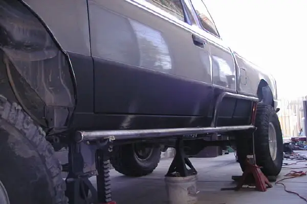

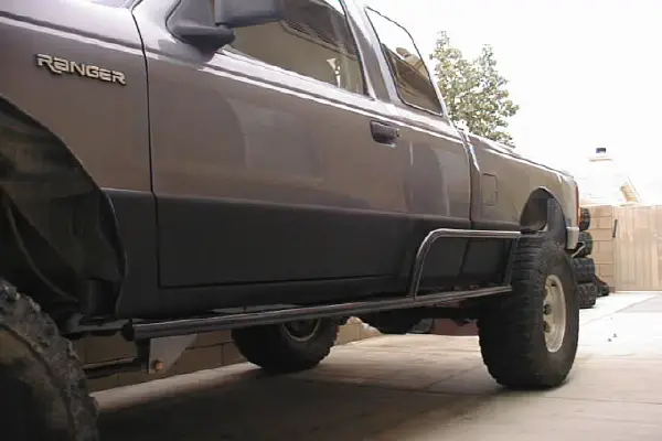

Finally, i'm making some sliders for my rig and of course its after i've already damaged my rockers and quarter panels but who builds sliders BEFORE damage
is done? heh heh
Material is 1.75" x .120 wall for the main runners and frame supports and 1.5" x .120 wall for some quarter panel protection.
Here's a couple pics of the progress:
1st pic is after finish welding and ready for paint.
2nd pic is a mock up and ready for tack welding.
