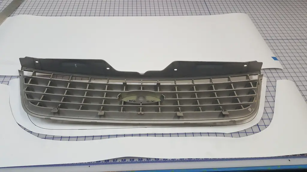

So I just picked up my new to me, 04 Explorer and I cant leave anything stock for too long so I decided this weekend I am going to make a ford raptor style grill. I went ahead and did some photoshop mock ups and holy hell I am getting excited. I'm going to make it black with white lettering to match the paint. One of my buddies gave me the idea to put an "X" behind the "FORD" so I may just put that into the pattern so its subtle but there. Ill be posting up some more pictures as I go. Wish me luck!

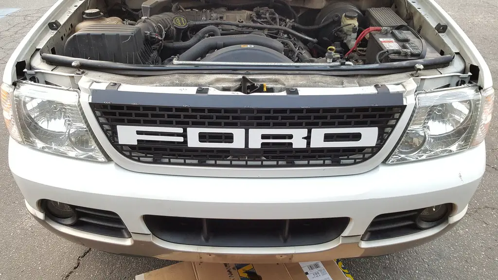

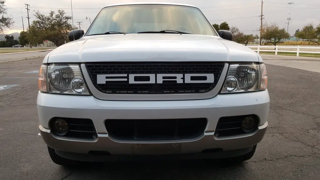

Got I all finished today and I love how it turned out!

Had to trace the stock grill.

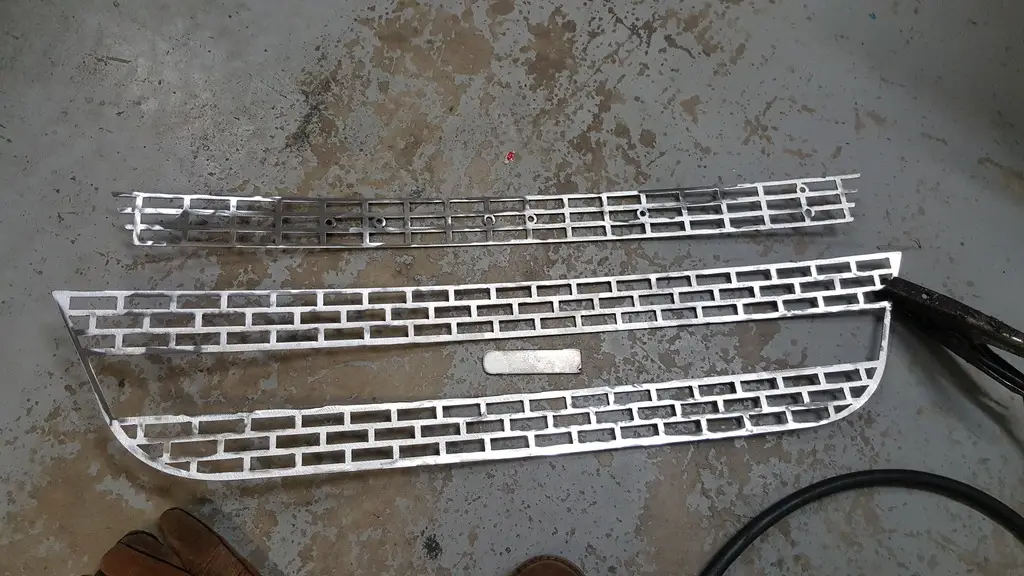

After that I jumped on the plasma cutter and went to work.
Then contoured it and welded in the offset for the flush letters.

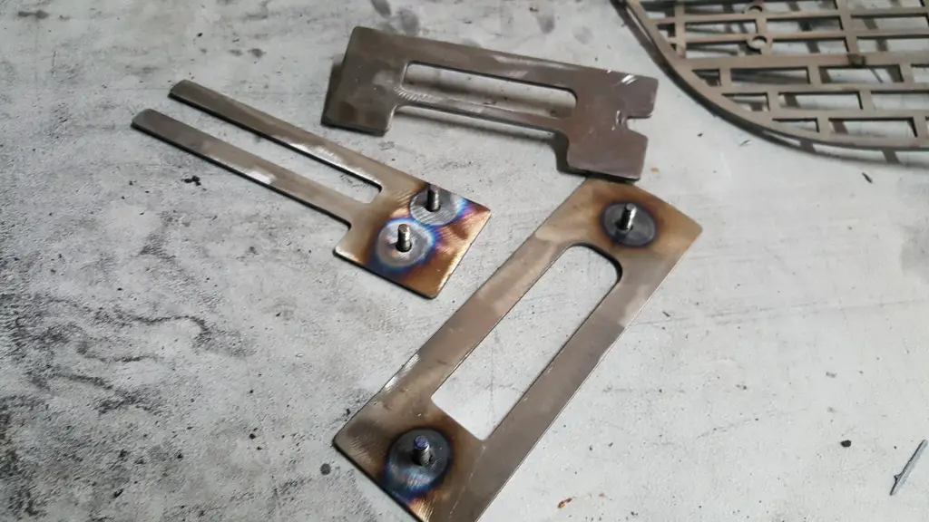

Welded the studs onto the letters.
Made the mounts and then painted it up and bam!
