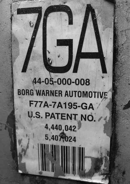

I had a problem yesterday coming back from a camping trip.... driving down the highway in 2 wheel drive (mine is a 95' with manual transmission). I got to the bottom of this hill and noticed that when I press the gas pedal, the engine just revs. I was able to shift through all gears but no tires were being driven. I pulled over, tried turning the nob to 4 auto and nothing, no 4x4 lights or anything. tried the same with 4 low and nothing either. finally after messing with it for while it finally got into low. with switch set to 2wd, I gave it some gas on the shoulder of the road and found that only the back tires were spinning so I decided to drive it the rest of the way home (5 miles maybe) even though it was still in low. I almost made it all the way home when the t-case just switched in to neutral and I coasted the rest of the way home. Today, I started it up and now it is in low and it doesn't matter what the 4x4 switch is set to. So pulled the shift motor on the t-case and found the indicator on the t-case pointing in the High position. No matter where I set it manually on the t-case, the car is still in low range. when the motor is in, the lights indicating 4wd and 4low operate as they should and when it is set to 4 low, it is slightly harder to put into gear just as it always has. I think when I put it 4 low, it is engaging the front and rear wheels, but when it is in 2 wheel drive, the t-case is still in low, but the front tires are not engaged. Any suggestions? Thanks!!
