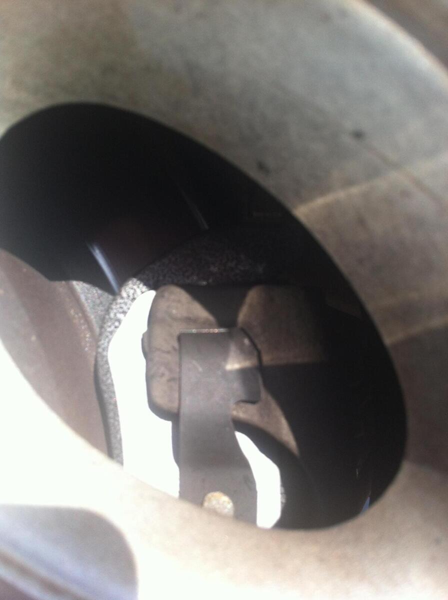

You can see the area where the stock pads have worn the rotor down a bit, and the fresher area where the new pads have started to polish it up.
The stock pads extend to the bottom of the caliper in height, the 3rd gen pads extend beyond the caliper. this pic was taken this morning after I got to work.
After driving on them for a good 200 miles, brake feel is the same, stopping performance is probably the same. pedal is less scary feeling, since its higher up now.
