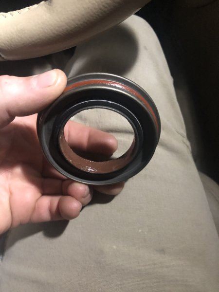

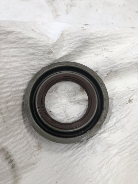

I swapped the Duralast seal for a Motorcraft today. The two seals can’t even be compared. The ford seal was MUCH tighter on the axle and took a lot more effort to seat into the diff. The Duralast seal popped right out with a screwdriver.
I would advise anyone doing this job to only buy the Motorcraft seal. Don’t waste your time with aftermarket

First and last pic are Motorcraft, middle two are Duralast.
You say you have dirt on top of the cv axle shaft?
The cv shafts turn, typically when dirt sticks to them it means they’re leaking. Earlier gear oil from the diff or grease from the cv shaft.

@RichCresci
Seals can also leak around their OD (Outside Diameter). This leakage is quite difficult to not vthinkn it originates from the seal rubber element. The brown shi* in the images is aimed at positively sealing the OD with, like, an O-ring. Usually means a quality seal.
