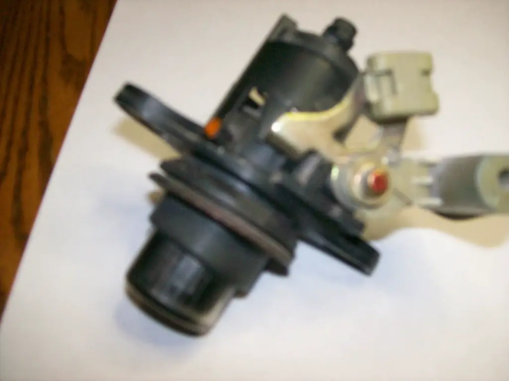

If that's the case, your lock is not turning the small plastic peg that needs to rotate with either the key, or via the lock actuator. The "locking mechanism" is kind of a joke. I don't know how to advise you further. Something has become unattached in your hatch. You'll have to get in there to see what.
I'll find a picture of the lock and add it to this post.
Edit:
Here's a picture of the lock. Note the plastic peg that I've colored orange. When the key is inserted and turned the peg rotates and allows the window and hatch to open.
