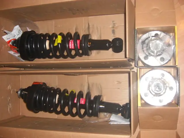

I figured I would start a thread of my own so that I did not hijack other threads. I just got in a set of rear Monroe quick strut, rear hubs and bearings. I work at a for dealership and asked one of the mechanics how hard it would be to do the work and he told me the struts are easy but it would take like 5 hours and then went into this whole this on how I should have just purchased a kit together with the spindle, hub and bearings together. So now I am clueless of what to do next or where or who to have them done. I have read all the posts on here but I am not very car friendly and don't have a clue about what parts are what. Any suggestions or anyone know of someone in South Jersey that I can trust? lol
The rear hub on the x has a pressed in hub and bearing which means that they are not bolt on like the front bearing. All you have to do is take the spindle off with the hub still attached and go to and service shop with the new hub and they will press out the old hub and press in the new one. They should only charge for about an hours labor which is a lot cheaper then purchasing a complete spindle/hub assembly (which i have never seen sold as one unit)

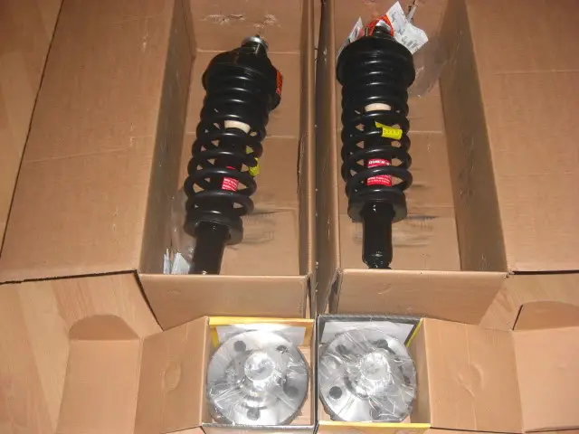

Well I have been reading many posts and figuring out what parts are and what they are called. I now understand what I am reading, I learn very quick and I am pretty handy so a buddy of mine that knows cars well and helped me replace the intake manifold on my old crown vic is going to help me this weekend. We will see how it goes, lol
all this stuff I bought is just for the rear and yes they came with the bolts on them.
Ok, I saw 4 struts and 4 hubs and thought you had bought a set for all 4. So the ones in the photos are for the rear and the hub has the wheel studs in it.
Thanks
Yes, it just took two different pictures for the fun of it lol.
