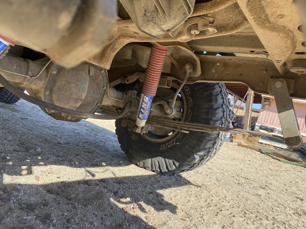

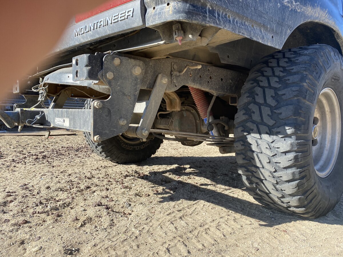

What are my options for rear leaf springs for a 2000 Mountaineer? I want to try and stay away from add a leaf due to my stock leafs are pretty worn. Everything I’ve found on the site is manly the lift shackles which I have installed already , add a leaf, or body lift which I will not due, not a fan of them. I found some old man emu 1.5in on 4wheel parts but would like to hear some insight on them or other options available. Attached is my rear setup now. Thanks in advance

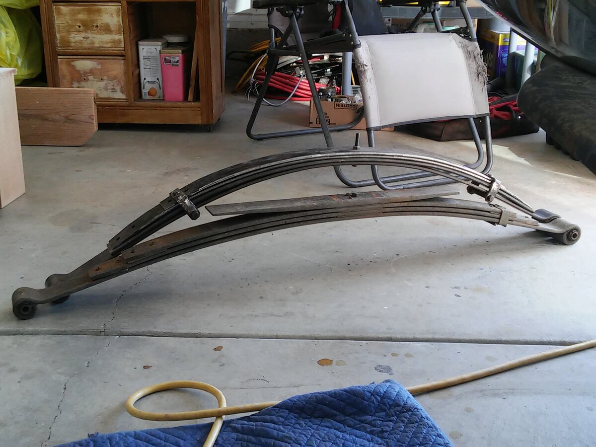

Build a bas tard pack out of an F150 spring under the Explorer main leaf. If you have a press you could re-arc. I built my rear leafs from some Pro comp leaves off some kind of Chevy under my stock main leaf, lifted it way too much, like 6" instead of 4".
I have a few spare sets of stock to work on & a press in the shop so I'll arc another set.
Here's what I built next to a stock leaf pack.
What are my options for rear leaf springs for a 2000 Mountaineer? I want to try and stay away from add a leaf due to my stock leafs are pretty worn. Everything I’ve found on the site is manly the lift shackles which I have installed already , add a leaf, or body lift which I will not due, not a fan of them. I found some old man emu 1.5in on 4wheel parts but would like to hear some insight on them or other options available. Attached is my rear setup now. Thanks in advanceView attachment 436860View attachment 436861

I got some leafs off a Chevy that was going to scrap. I cut the eyes off & put them together with my Explorer main leaf. I have no idea what these leafs are, only that the Chevy was used around here in a few tough truck competitions. I looked around online and decided they were from Pro comp. Lots of arc, nice spring as far as ride goes but WAY too much lift, like 2" too much. I actually have some lowering blocks on it until I re-arch some other springs I have stashed.

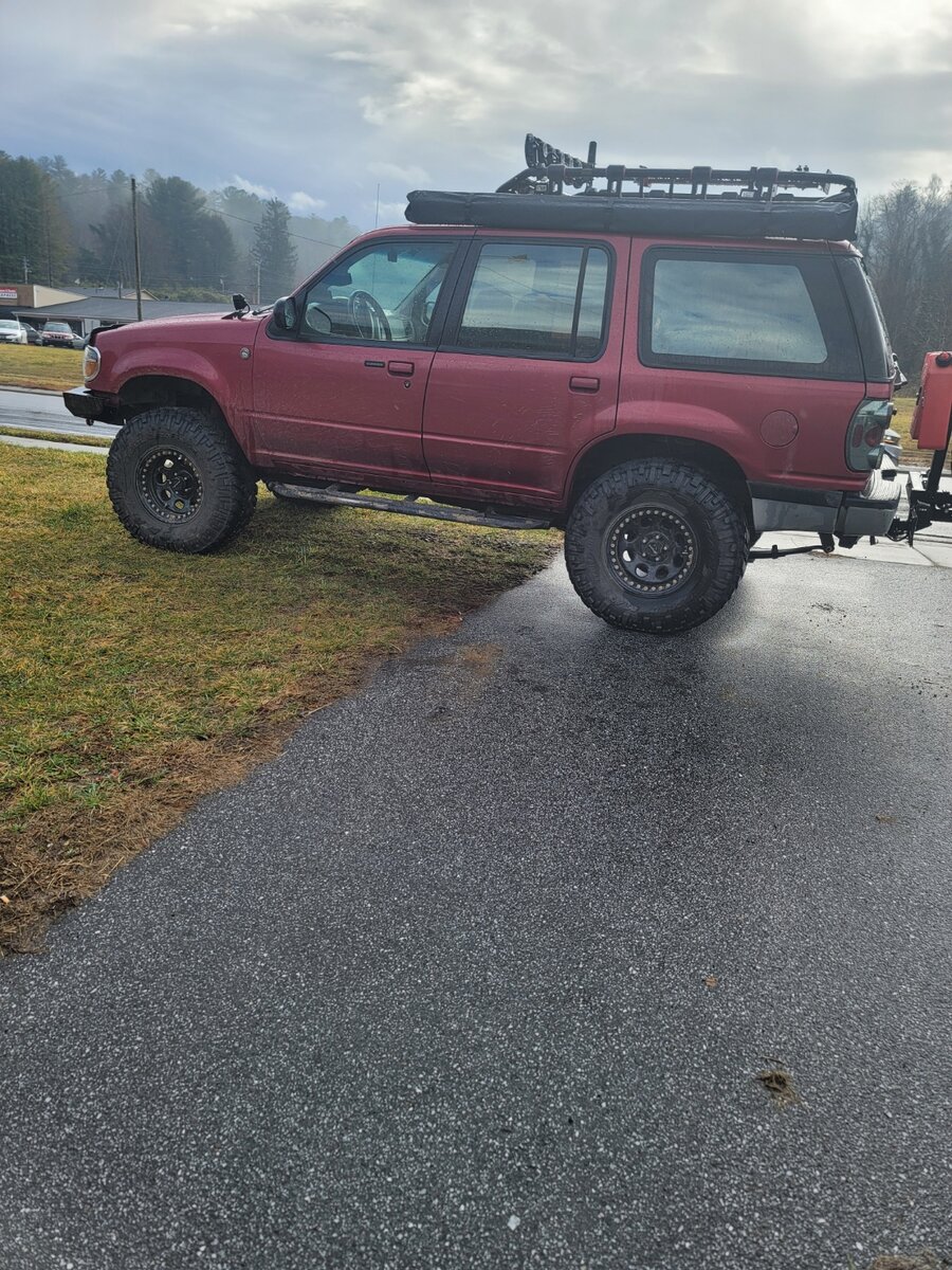

When you say lift the body you mean just jack up the vehicle more? I’ve swapped leafs before on previous vehicles so I know what’s involved just want to clarify what you mean. Do you happen to have any side profile pics of how it sits. Trying to get an idea of what route I’m gonna go.
Yes I mean lift the body to pull the longer arch of the springs up to meet the axle.

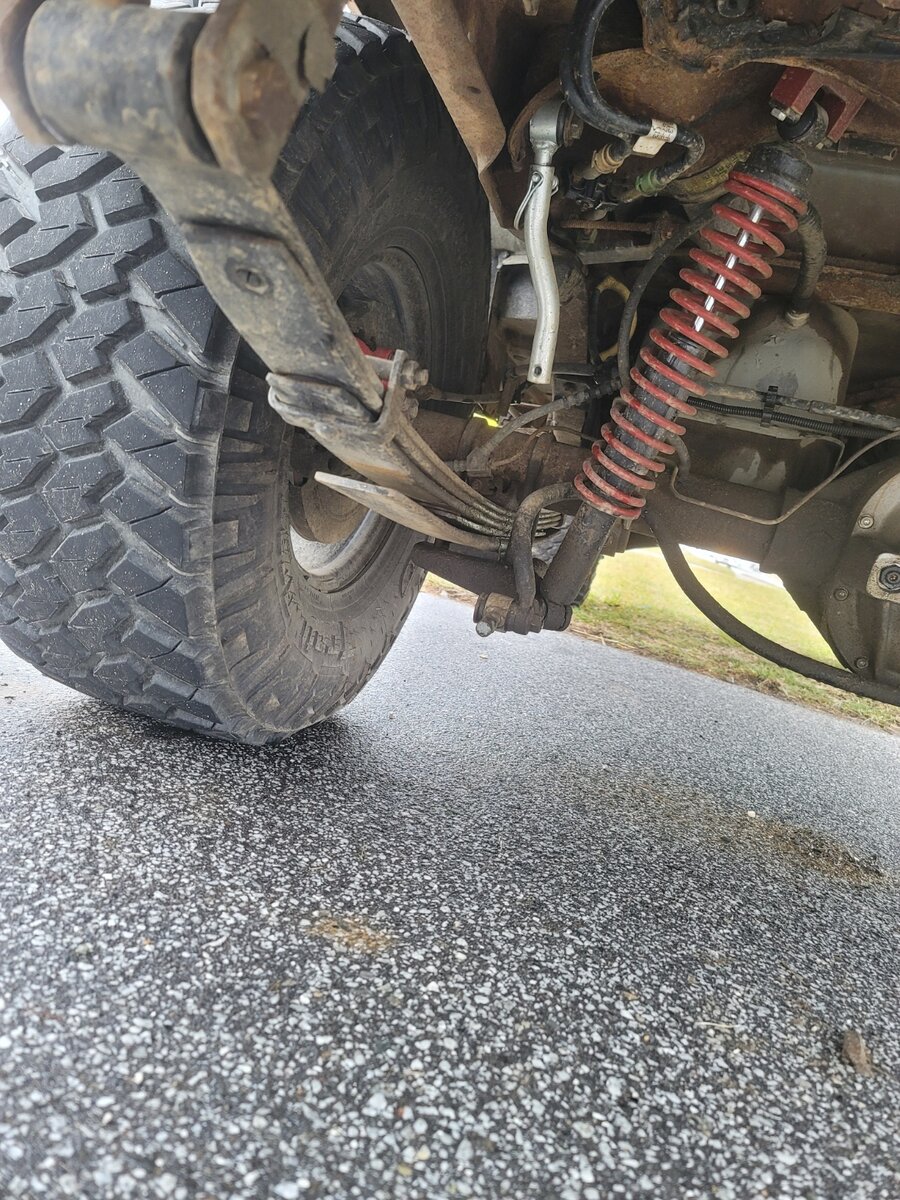

Sorry, quick pic. At work and it's raining...
@DannyW Nice information to have, there; this could be the option I select when my OME's wear out. A little more lift on the rear end would do mine some good. Not sure I understand what you meant by "flip the centering pin around", though. (I'm sure I'd understand when I order up a set, ha ha.)
How does it handle the weight of your Explorer? I see your shock absorbers are pretty beefy, I assume those coils stiffen the ride a good bit beyond what the F-150 springs do on their own?
P. S. That's one gnarly truck you've got there.

The springs by themselves ride nice - not too stiff. The coil overs are to help when we're out for 3 or 4 days with the load-out. Otherwise, the shocks work as normal.
