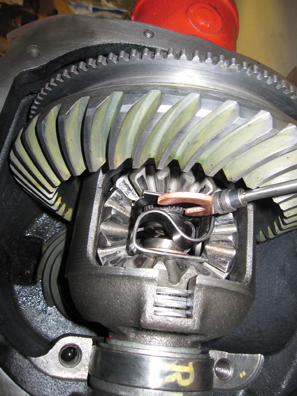

Hi,
the clinking sound comes from worn out traction lok disks, worn out
c-clips and worn out half axle shaft. There is an endplay which ist too big,
if you could put out the rear wheel more than 1 mm.
Maybee the S-Spring is broken?
Open the differential and take a look at.
