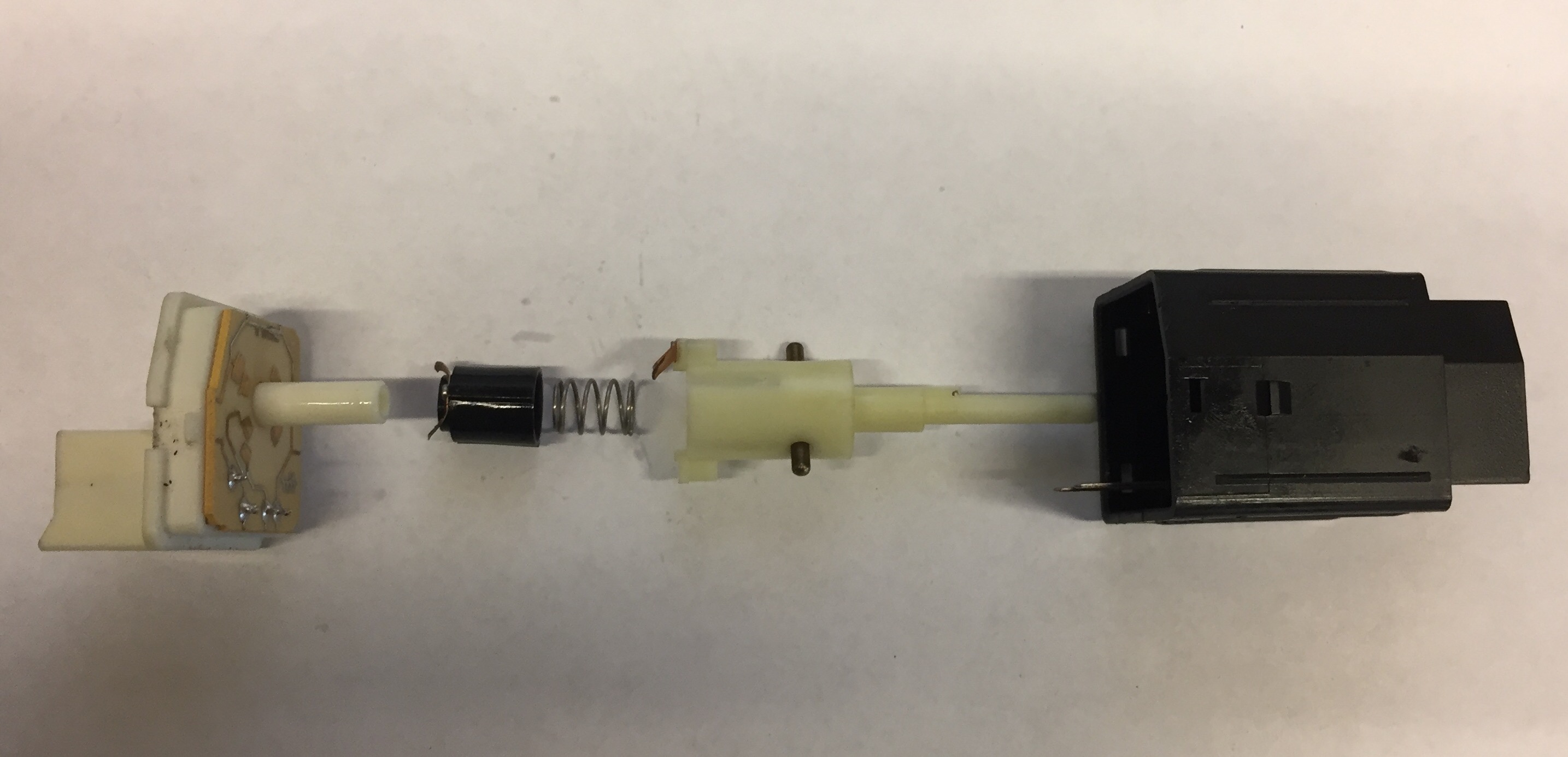

Thanks to Steve's excellent troubleshooting information, I was able to pinpoint my problem to a missing trace on the dash switch circuit board.
I will fix this with a conductive pen and reassemble the switch.

Happy to have been of assistance. That is a pretty slick repair.

I will start a new thread with details on switch disassembly, operation, repair, and assembly.
