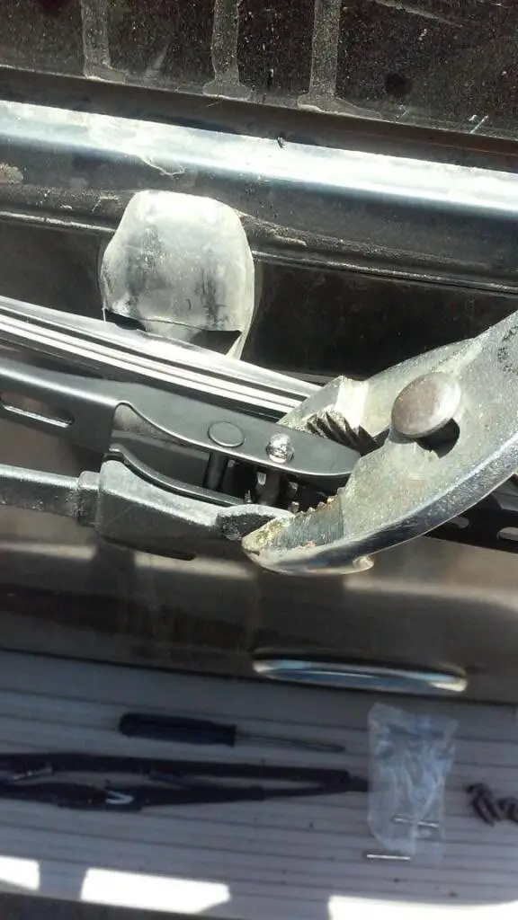

Just passing along as I think the oem style replacements are obsolete -- rare pin style connection.
So I got this PAIR: Great price being singles of any wipers today are $5 - $10 EACH.
Pictures tell the story, used metal grinder with cut-off blade to cut star retainer clip on old one to get old unit off....then cut into thirds (for fitment) one of the various fittings that came with wipers (hacksaw) -- used center (circled) piece for clip/clamp on new wiper. Works perfect - solid hold, tested repeatedly.
